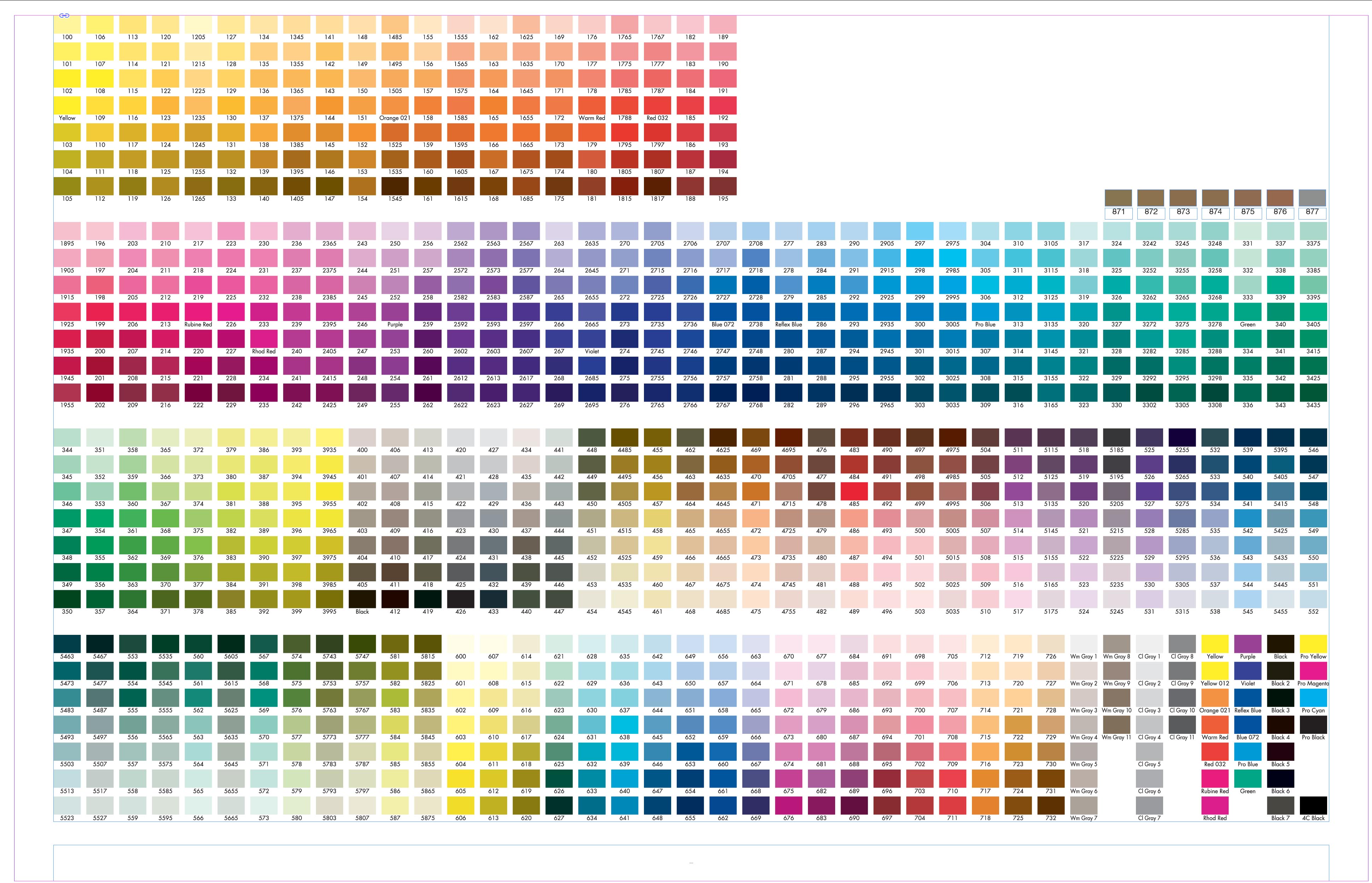

We have a file we run to spec the colors and then use what the press actually prints as your guide to the colors that "it" can actually print . . . see attached screenshot - its a lot of work but it makes it easy to see what colors look like on a particular stock works best in a digital press workflow . . . would be ok to run some on your house sheets for a conventional press . . . .
