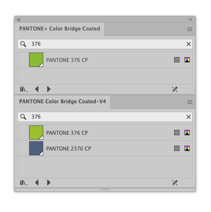

HI!
What are the differences between PANTONE+ and NOT PLUS ?
I guess the plus is older than V4 - the CMYK values are different too ...but what else?

The colors you are looking at are Pantone Coated v4, which is the next edition after Pantone+ v3. They added the Plus to the name in in 2010 and removed it in 2019. With each new edition of the library some colors get tweaked slightly.
The colors you are looking at in the example are the same Pantone color from different versions of the guide. If the values are different it means that for what ever reason Pantone has decided that the values needed to be updated. This also means you need to know what version of the guide your client is using. And as with any colors from bridge, ask yourself are these CMYK values relevant to my press condition...but that is a whole other thing that I won't get into now.

I was asking because the PANTONE+ are still shipped with Adobe Illustrator 2021 ...
Shouldn't be the case to replace this with the new one?

The newer values can be added through the Pantone Connect Extension, or the deprecated Pantone Color Manager. I an not positive but I think the ones that Adobe includes are Pantone Plus v2.

PANTONE values will be different, depending on whether you are targetting M0, M1 or M2 measurement conditions. Adobe only provides ColorBridge values for one measurement condition. In the past, Adobe supplied M2 values for ColorBridge PANTONE colors, as M2 was considered the defacto standard, but with v4 PANTONE made the decision to switch to M1 as the target measurement condition, to align with the latest print standards, such as GRACoL CRPC6. That's why you see a difference in CMYK values between v3 and v4 in Illustrator and InDesign.
