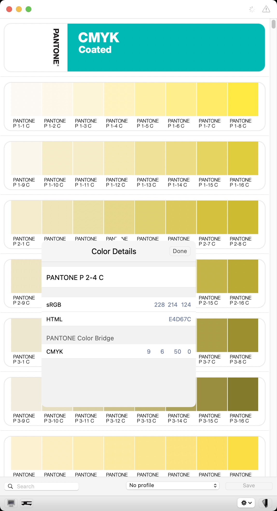

How are you supposed to print the Pantone CMYK library?
... using the 4 CMYK colours?
...or with a special ink?
What would be the point? Is it just a reference?
Lately I get a lot of jobs with these 'inks' in them, but I think the graphic designers don't know what they are doing, so even they can't tell us what they want us to do!

These are meant to be printed in CMYK. When you add them to your swatch palette, in InDesign for example, they come in as Process colors (not spots).
In the screenshot you sent Pantone 1-7C is simply 81% yellow.
Thank you, that's a good clue-now these are hard things to test, since you have to pay.
