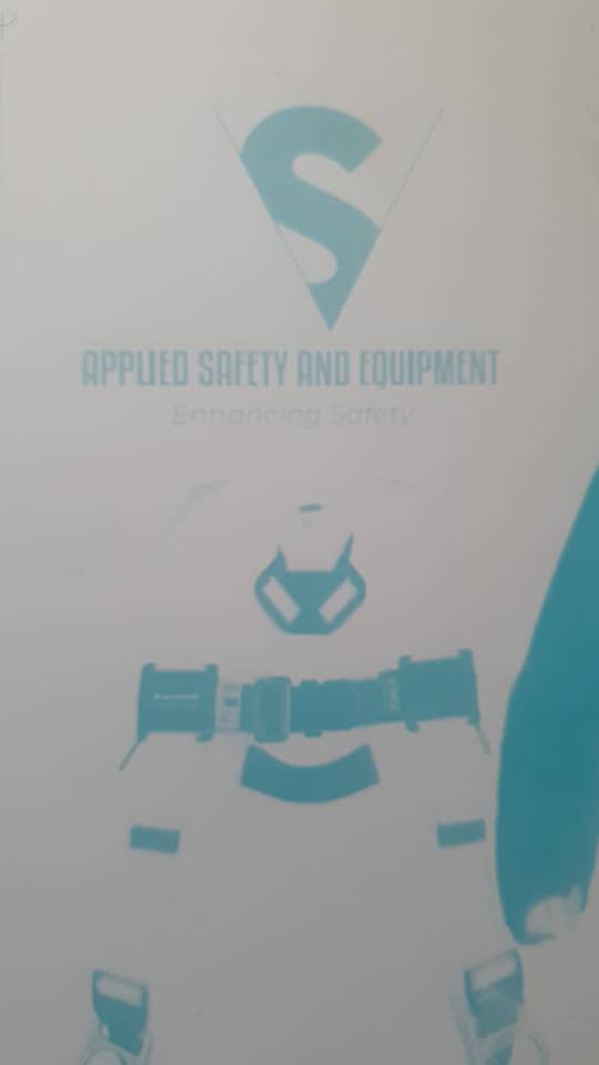

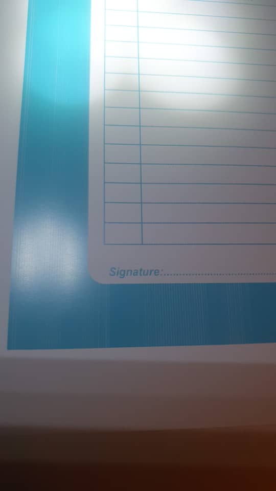

hie everyone am having issues with my ECRM MAKO 4 CTP IT GOT STRIP LINES ON THE IMAGE AND AM HAVING A MIS REGISTER ON MY PLATES
..PICTURE PROVIDED FOR STRIP LINES BELOW

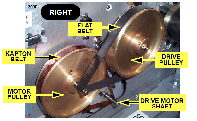

You need to clean ribbon belts both sides. Flat belt and kapton belt. Also brass wheels surface and drive motor shaft.
Check tension, should be the same both sides.
Clean transport rollers.
It is critical for that machine and usually should be done during preventive maintenance every year.

Only cause are motors, belts and tension. You can run encoder test in diagnostics.
Laser temp: TEC cooler and cooling fan need to be checked.
Chris

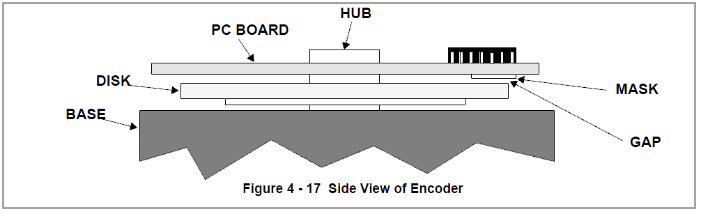

There are glass disks inside encoders, might be dirty. Sensors as well.
Clean them with photo lens cleaning fluid. No isopropyl alcohol, leaves smudges.

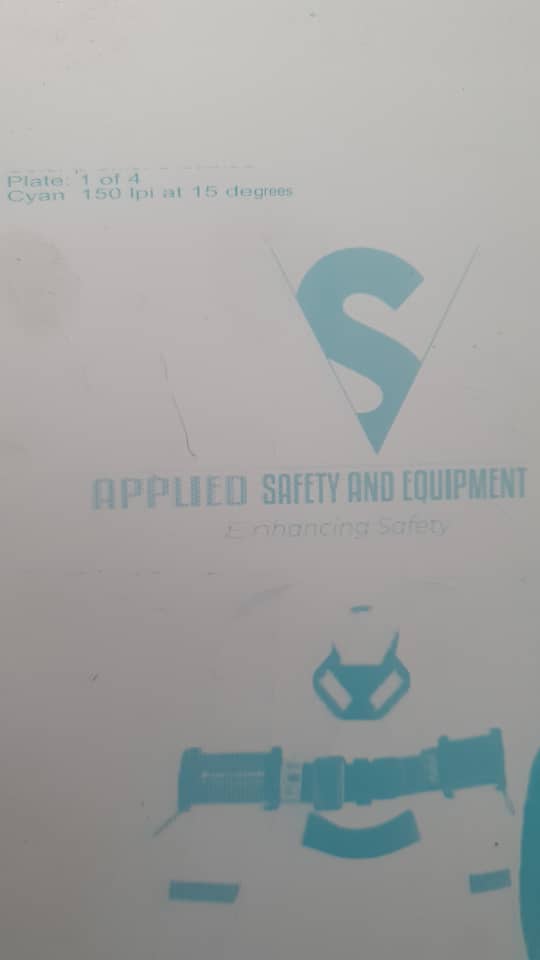

INSERTS ARE PICTURES OF THE IMAGE PRINTED BEFORE WE RAN SERVICE MENU
SCRETCHED IMAGE BUT LINES WERE NO LONGER VISIBLE

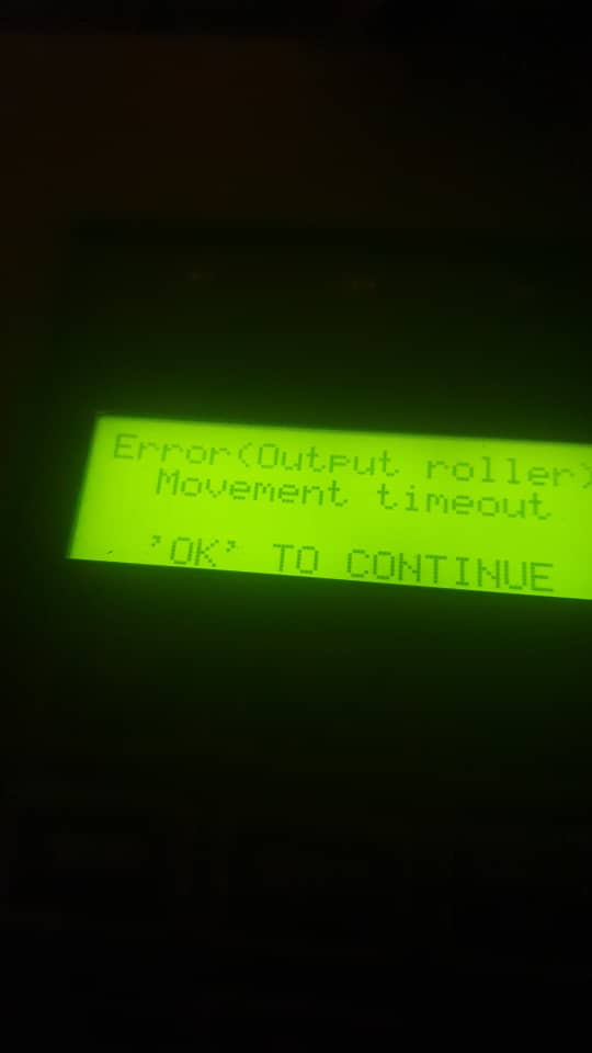

AM NOW GETTING THIS ERROR, WHEN I SWAP THE MOTORS THE OUTPUT CHANGES TO INPUT ROLLER TIMEOUT
Movement timeout:
• Check drive belts for proper installation and tightness.
• Check drive encoder for proper installation; ensure collar is secure on drive shaft.
• Run the internal encoder test.
• Verify cabling between main drive motors, encoders and main control board
• Replace drive encoder.
• Replace drive motor.
• Replace main control card
Stretched image - whole plate equally or just partial?
Movement timeout:
Thank you Chris for your response...streched image is just partial
