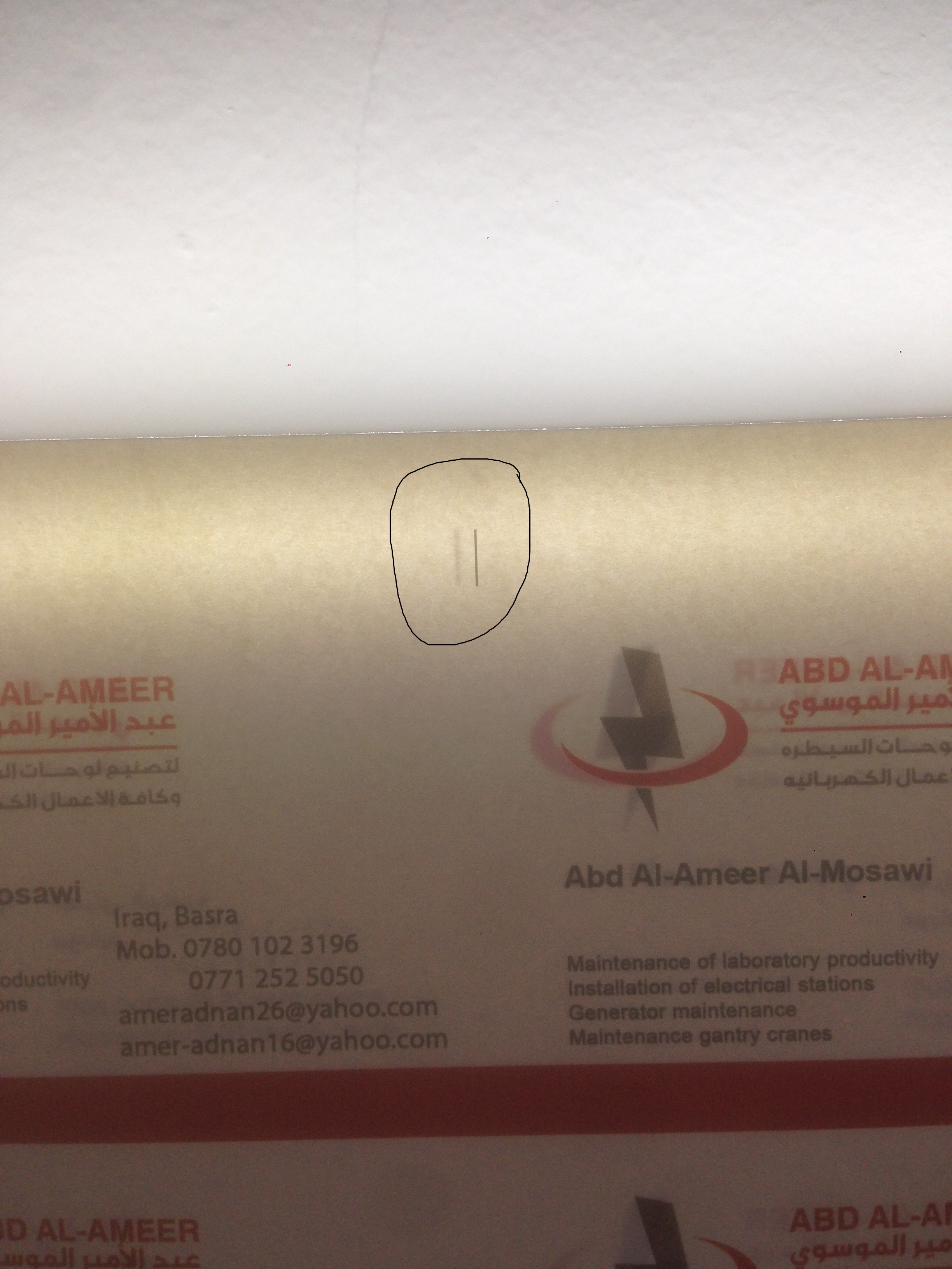

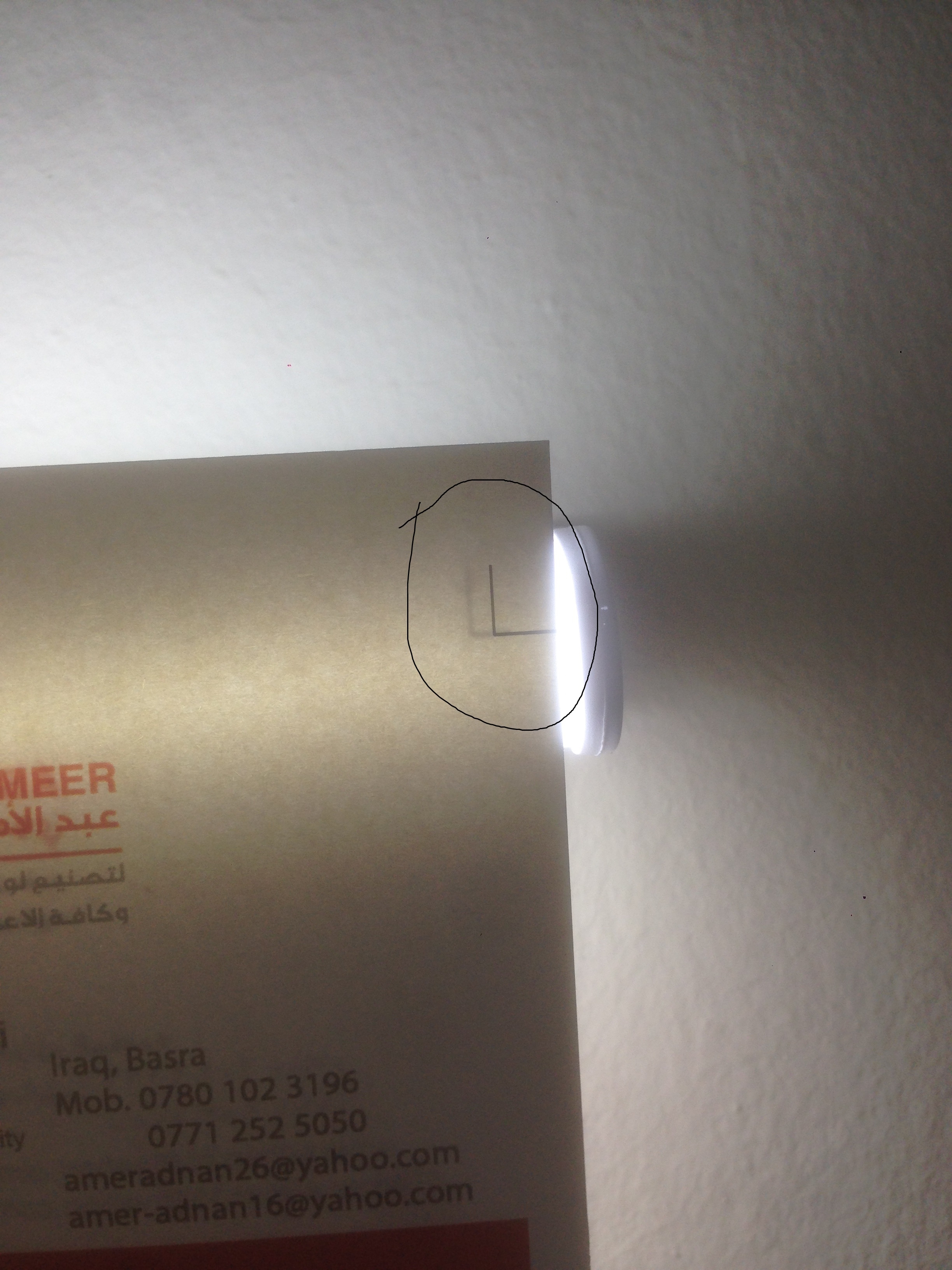

Please help of Xerox experts Versant  80
belal sras
There is a problem in SIQA I do not know what to do
Time he came served the maintenance and could not solve the problem
The problem is not to match the face and back
All I could have done but I did not benefit
First be correct and identical facial and back 100% paper, but then start Balnhrav left and right and above and below each each different from the afterlife sheet of paper
Please advise

No Title
This Photo is models after work paper profile, and also you will understand what I mean
This happens in all sizes and weights of paper

We have a Versant 2100 with full width array. It is great for running alignments, but sometimes they are still off. The important thing is that it is straight, not skewed. If your crops lign up straight from edge to edge just do a manual adjustment in the Fiery to line them up perfectly. I have had our front to back crop marks out 2mm after an running an alignment profile. Some stocks seem to align better then others.
Maybe you have incorrect GSM for the paper and it pulls one one way and the next different. Maybe it is some worn rollers feeding badly.
We have V80 and once SIQA is run no issues unless there is something affecting paper pull or path.
I get it now. Yes, I have noticed some stocks are bang on when calibrating standing in front of the Xerox, but the Fiery tends to shift things in it's own special way. I recommend what wonderings said, as that is my workaround.
We had a Docucolor 252 and the backside was always up by 2mm. It was normal for us to move it down in the Fiery. This was before we had SIQA. Now that we have SIQA it is easier but it seems to have trouble with 13 x 19 sheets. You have to go deep into the maintenance settings to manually tweak it after SIQA gets it close.
