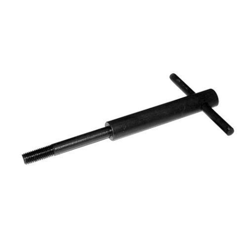

Walter from Hicks Brothers Printing Equipment suggested that I release the electric clutch from the transmission and turn it by hand with the power OFF.
I found the tool here:
http://www.compoundmfg.com/index.php...roducts_id=104

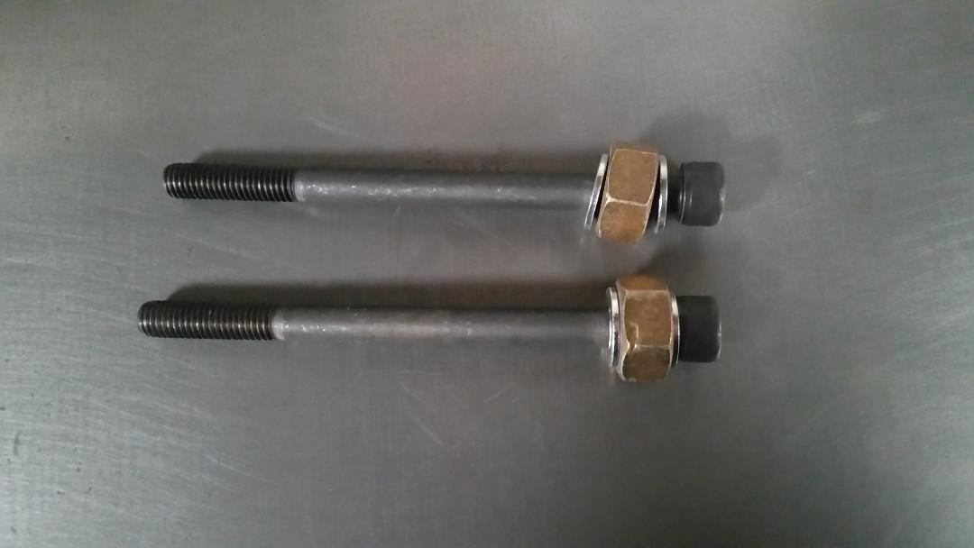

I didn't want to spend the $80 plus shipping (2 required) and time so I made my own.
I went to Home Depot and purchased 2 8mm Hex bolts by 110mm length and used 4 washers and some oversize nuts to make up the difference. The OEM tool used for this has a distance of 4.0 inches from the shoulder to the end of the threads. I probably should have purchased 100mm length, but I didn't want to be too short.
As I turned the bolts in, the clutch popped loudly. Apparently, the clutch plates had become rusted or oxidized to the matching surface. I turned the cutter through one cutting revolution by hand, removed the bolts and to my amazement, the cutter worked perfectly. That explains why the 46 volts was measured at the copper rings and the clutch was not disengaging - it was rusted to the matching plate. Now it works great.

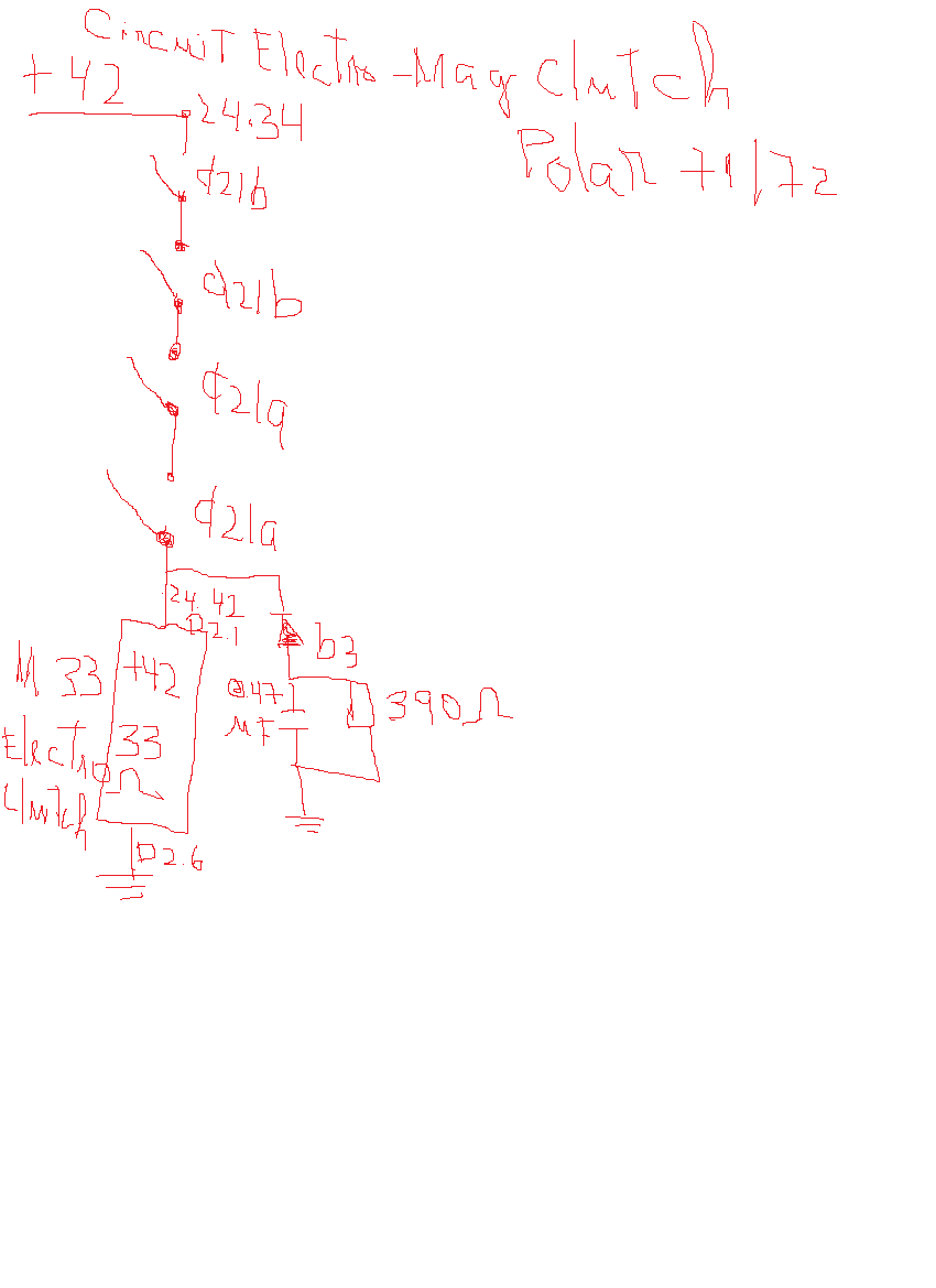

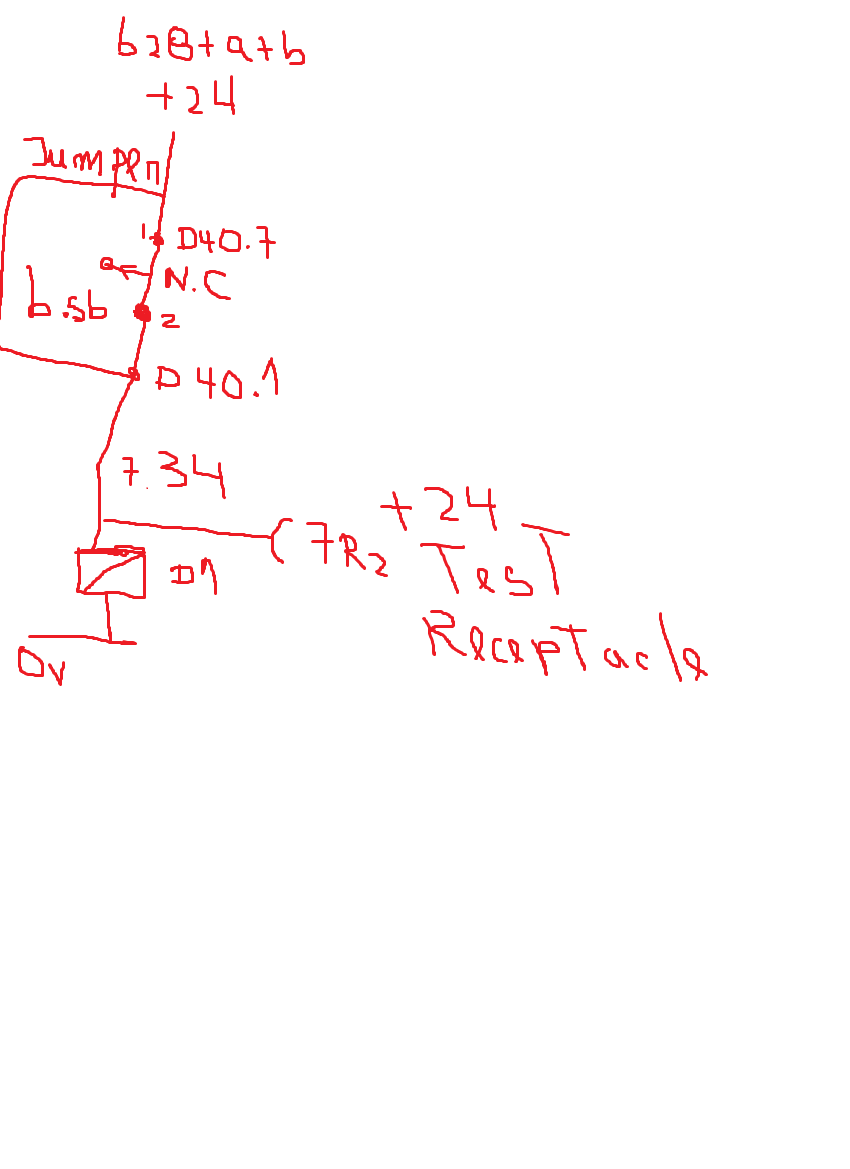

The limiit switches b22a+b with cam plastic in rear gear box, with the time they lose adjustment .
By that reaso you must sure the Knife will be in the most Higher Up position, in order to the Safety bolt Solenoid release in time
and send the +42Vdc to the electromagnetic Clutch(Not hydraulic).
Attached is schematics diagrams for Polar 71/72 , that i did for some emergency.
Blessing
