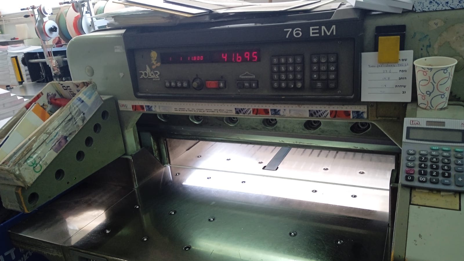

My polar, SN 6461339 shows this Error code.
It cuts but is not programable.

Thank you, Chock.
This is my machine as attached.
