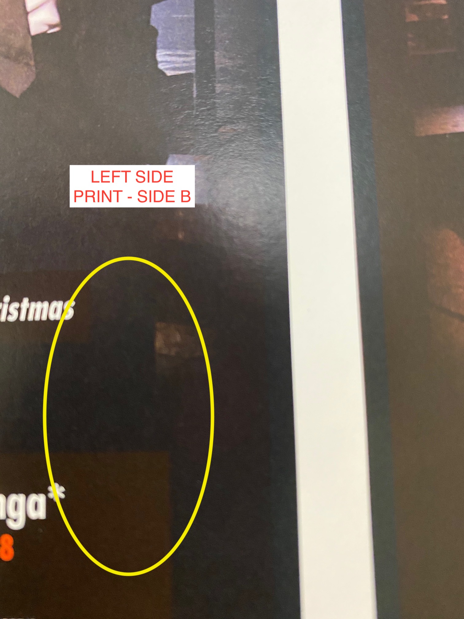

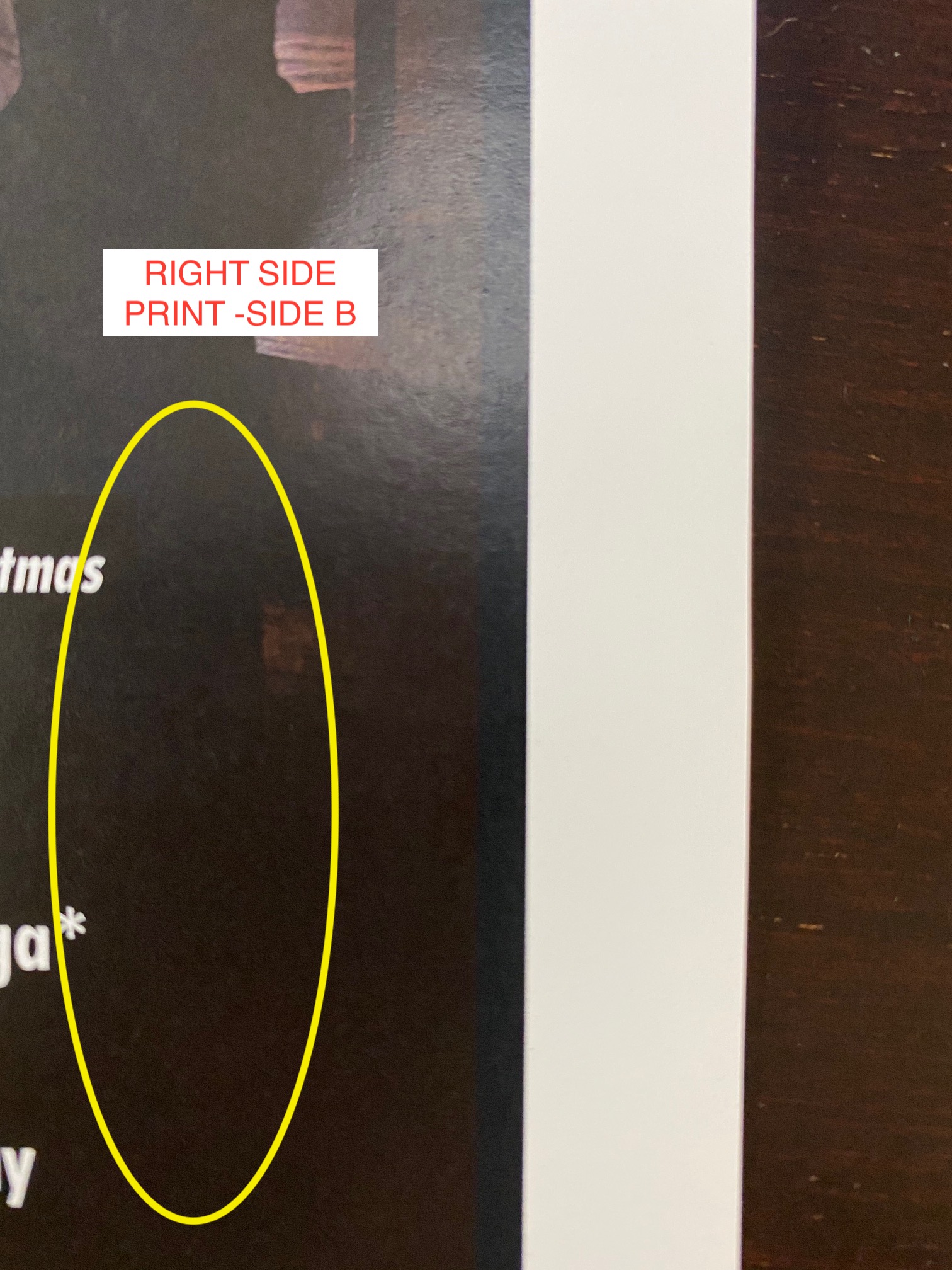

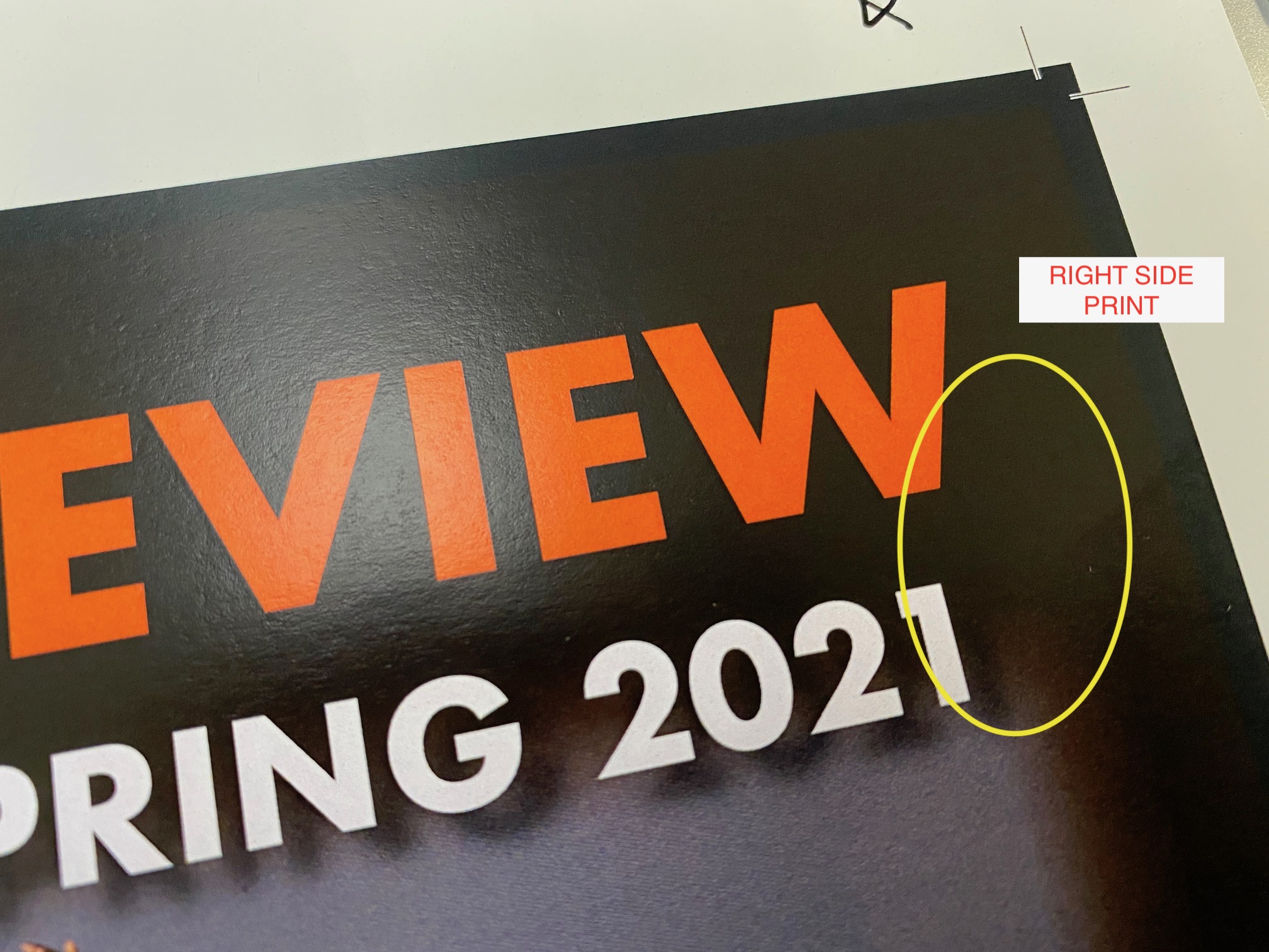

I am attempting to print a simple 8.5"x11" image (flyer) 2 UP, Duplex, 13"x19" sheet on Ricoh Pro C7210sx. Initially, we took the 8.5x11 PDF and imposed in Fiery and sent the imposed file to print. We noticed an issue in the print. Same exact image file, but the one on the left side of the sheet has noticeable problems. The right side print looks fine (see attached). I took the single PDF and imposed it manually in InDesign and sent the 2 UP PDF to print. Again, same issue as before. I've attempted different print settings in Fiery but nothing seems to work.
Does anyone have any idea what could be happening here? Could it be the printer?

Are there slightly different versions of black that break at arbitrary edges that do not correspond to the edges of any elements in the PDF? I think that's what I'm seeing. Our Fiery does that all the time but thankfully it has never been noticeable. If you rasterize (process and hold) then you should be able to see it in Image Viewer (you may have to turn black off and on in the preview).
I would try creating a black image (try CMYK 60/40/40/100) and using that as the background rather than a vector rectangle. If the Fiery still decides to mess with it, try reducing the black to 99%. If the Fiery still messes with it, try adding a very small amount of noise.

That's a transparency issue. I can see the box of red ghost behind the word view as well. Without knowing how the file was created or saved it's tough to diagnose. Flattening transparency should fix it. Could be a rip setting-did you contact Ricoh?
You could rotate the file-if the problem is in the same place, it's the press, if it's the file it will be wrong no matter how you spin it. Good luck.

It looks like the designer used a lot of gradients and there are definitely some transparency issues. Unfortunately, no native files so all I've got is the PDF to work with. Thanks for the tip, though!
