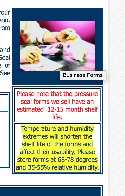

I'll be honest I had no idea what pressure seal pieces were. But being curious I googled it and found this on a manufacturers page. May be an explanation. Talks about humidity and a shelf life.
Santa - Our paper never sits for more than a month and we see the problems using paper from the same day that it's delivered. So I'm still thinking it's a fuser oil problem.....
