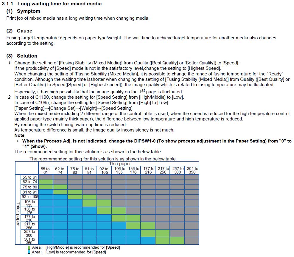

As for your earlier comment about jobs with mixed media...if I understand what you're saying, it pauses when switching media. KM devices have a setting to make it so there is no pause. See attached screen shot from the service manual for more info, but in summary you need to: Press Utility on the hard button panel>User Setting>Common Setting. On the bottom of the first screen is says "Fuser Stability for Mixed Media"...there are 4 speed options to choose from. The service manual recommends changing it to "speed" for best results, but if there's still too much of a pause, change it to "highest speed". I haven't seen any quality issues doing this. I was told by someone in service that rather than it stopping to adjust the fuser temperature between media, it keeps moving the lighter weight media at full speed, while moving the heavier gsm media at a slower rate through the fuser.
Thanks for this. Good to know. It's not problematic, but good to understand the background and that there is functionality to rectify it if required.
