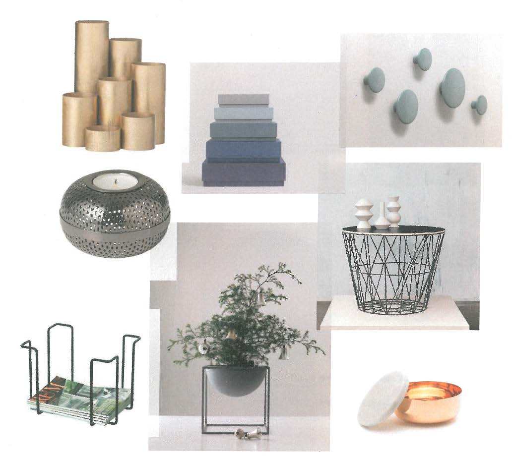

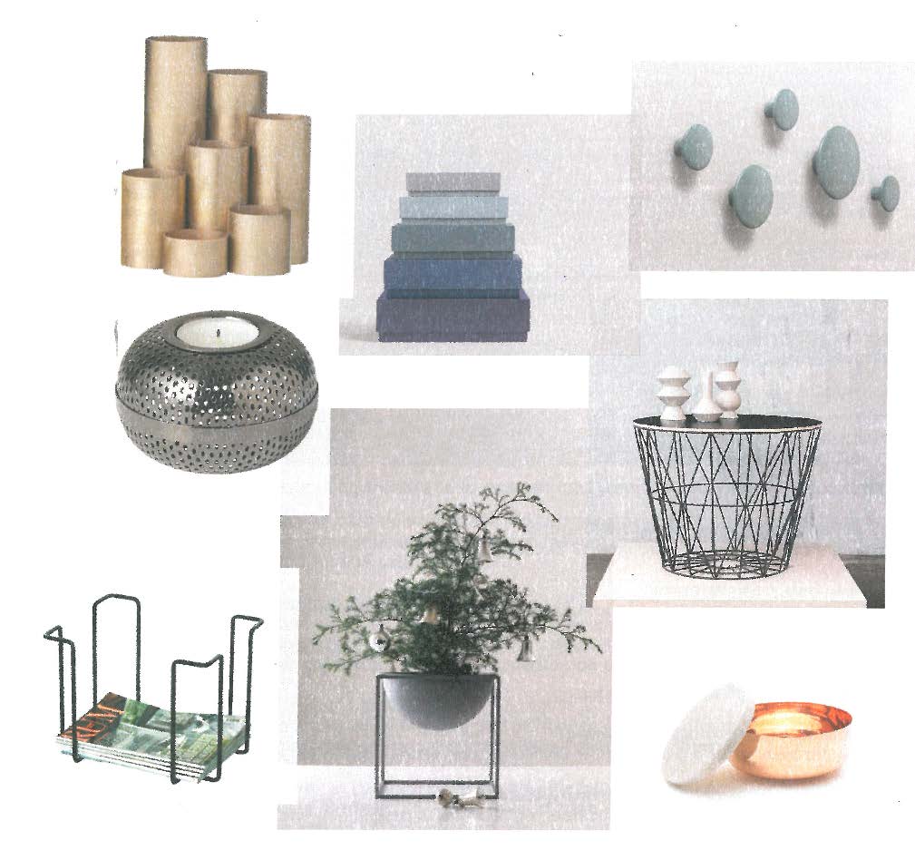

After I finally got rid of our Ricoh Pro C7110sx I want so share my experience with that new machine.
First here are the price for Ricoh Pro C7110 sx, including RIP 2 large feeders, impose - compose, finisher: 627.571 DKR = 94.516 USD
Click price: 23 øre / print (same for A3 and banner print) = 0,03 USD / print
We used around 300 hours talking, mailng with Ricoh. And i dont know how many emails. But above 800.
Ricoh finally took the machine back (and kept a lot of the money we payed for the machine) Even though Ricoh nordic top boss said they would cancel the deal.
The main reason they took it back, was that it makes white dots on all uncoated papers. A expert came from holland for two days. And the conclussion was that the machine worked perfect. And did not have any problems - if I printed on coated papers. And all my uncoated paper was not approved for the machine. Not even the Ricoh paper I used !!!
He didnt have any explanation for why the problem got worse and worse over time, and over a printjob. Hers is a picture of print 1 and print 500 in the same job. The job is on 120g MAESTRO EXTRA.

1 - The machine make white dots on ALL uncoated papers. This was not a issue on our machine. Ricoh had same problems on their demo machine on another location. (The problem got worse and worse over time, to begin it was very hard to see. you need to print more than 500 prints to see it.)
2 - VERY poor quality (white dots) on textured paper (was ok the first month) Ricoh says its air pressure, humidity and so on.
