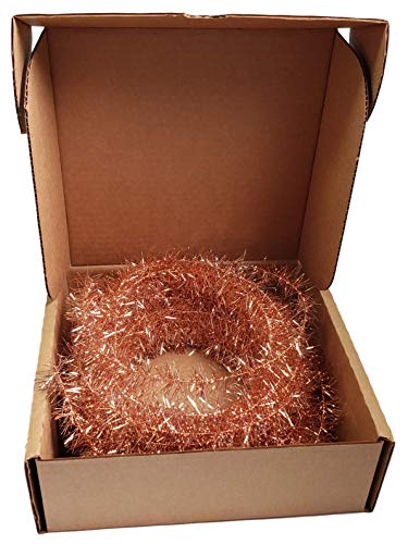

Cornishpastythighs
try attaching some copper tinsel and grounding it, this sometimes helps to reduce static
Stickman42
If your side 2 is swinging by 15 mm, I think you have either an very extreme amount of static, or something in the paper path is causing/steering the sheet off its true path. That's a heck of a skew.
While the tinsel above has proven its worth in many places, I don't think you can use it internally on a V80, which is where your problem lies, it seems.
pippip
Yeh I've seen the tinsel fitted within the finishing units where there's a few options but this is within the actual print engine.
Ynot_UK
There's a Justaprinter YT video where Dan demonstrates the tinsel tip on one of his C3070s. Not tried it on our C4080 to date as have been fortunate in not having any problematic static, but definitely one to remember, certainly when printing seasonal flyers...
pippip
Yeh I think I linked that recently on another thread. He fits it in the finisher.
