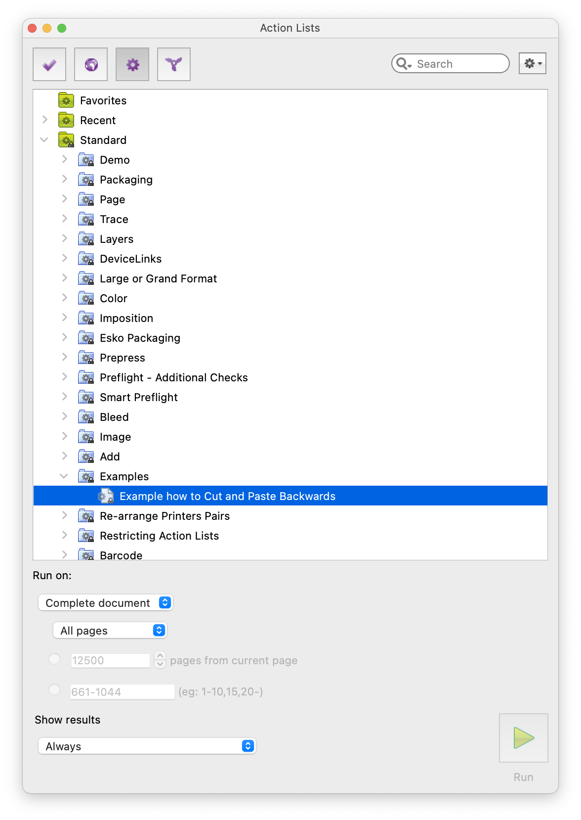

abc
You don't actually need it here as you are pasting forward.
Split Action list is when you need to past backwards, ie last page to first page.
