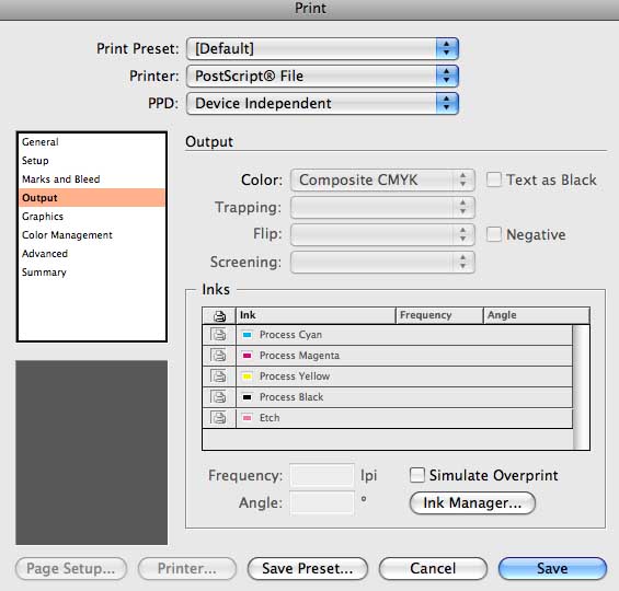

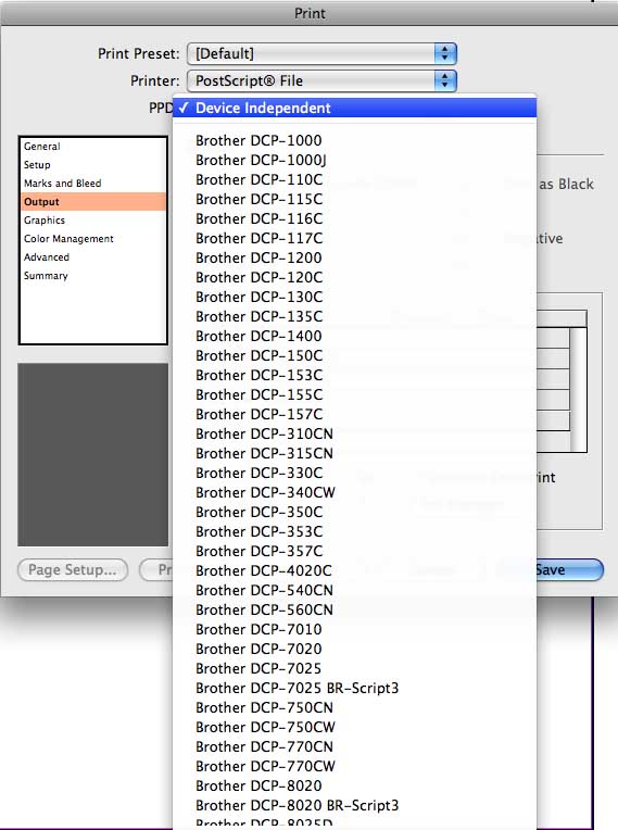

Question: What driver could I use to Print PS from InDesign? The dropdown in the print dialog has lots of consumer printers. Which one do I choose? OR What printer driver do I install, and how do I do that on my iMac running 10.5.8? PrintDialog1.jpg
The default does not let me do separations: composite only.
I can open the 1-Bit Tif in Photoshop, so I know the file is not damaged. Photoshop just does not help me any, because the only file format I can save in is the TIF format it is already in.
I placed the 1-Bit in InDesign, then Wrote PS file from Indesign, then attempted to convert to PDF using Acrobat Distiller, but got "VM Error".
Thanks! Now I can Print PostScript@! Trying the 1-Bit Tif, Placed in InDesign, Print PostScript to the Taipan Rip. Will let you know the result...
