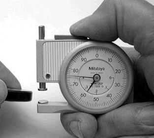

you will be looking for basic micrometer. And its very possible that 2 different papers of the same thickness weigh, feel, fold, and run differently.
get something small and handy like this
