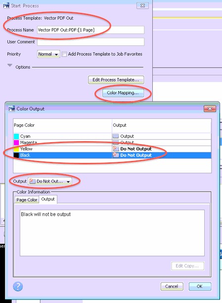

We have a little request that will help our sheetfed printers.
We are working under ISO 12647 matching our runs against the proofs exported from Prinergy (pdfs or tiffs). Contract proofs are created in EFI Colorproof XF, printed in an Epson 9900.
We have a two colour press, and occasionally we use that press to run four color work. This means that they have to print cyan and magenta first, and then on the next pass yellow and black.
In order to help them with colour management on the first pass, is it possible to output a proof that has just the magenta and cyan separations?
We have looked at other areas like Pitstop, Acrobat, Prinergy Process templates, but I will appreciate any comments on that.
Thanks
