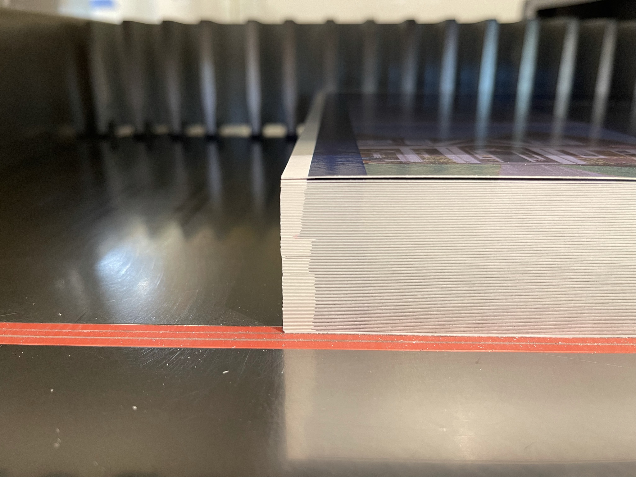

Mine has 1.8 mil clicks. Doesn't seem to matter if it is text or cover weight. If printing lets say 300 sheets, it will suddenly shift position, then later go back in line. Even doing a baseline calibration is having issues. Tech says everything has been replaced and still not working correctly.
I printed just a few sheets the other day to be sure it was tracking correctly. After seeing it was spot on I ran 50 sheets. Suddenly it shift around 4 mm. Going back to 20 sheets at a time kept it in line. The drift is from leading to trailing edge of the sheet.

Wow. You need to exercise your Total Satisfaction Guarantee and get yourself a new machine. This is not your responsibility to fix. Call Xerox and ask for the customer relations (?) team. They need to fix the machine or give you a new one.
Yeh, thats way too far out to accept. I'd consider that unusable.
Tell them they can keep replacing parts, the machine wasn't designed like that so the problem is somewhere.

WE had this exact problem like a month ago and I sent a very similar photo to our tech and he was like "what am I looking at" LOL - They did fix it but it took a while.
Forgive my lack of knowledge on the proper terms but if I remember right it was a bad motor on the fuser that was causing the red/orangish fuser belt to pull over constantly until the fuser belt got pulled so far to the side it got eaten up by the motor. I found shredded pieces of the red belt when I went to unjam the machine and they figured out that was the problem.
