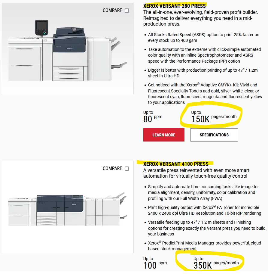

azehnali
that is not a beginners volume
90% of the print shops do up to 50K in volume and you are almost there
look into the xerox versant
simple to use and will do all kind of papers and envelopes

50k? Most of what I am doing is NCR, so the volume adds up fairly quickly. But, I certainly don't feel I could run a successful business and pay overhead on 50k impressions a month. I will certainly take a look at the Versant line. Are there certain models to avoid on the used market?
Thanks
