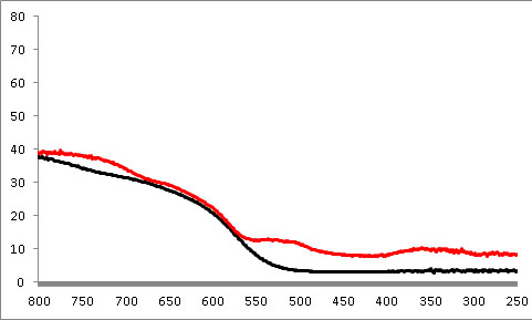

Rereading my first post I understand when you say you don't understand. Here's the thing: I work with a specimen that has, roughly speaking, three colors. I've measured(spectro) a color spot in real butterflies, from that I've generated a (mean) color profile for that spot. Than I've scanned real wings, printed them and measured the printed(fake) spot as well. I want these curves to be the more similar they can be (because they're from the same spot). In the course of my trials, I''ve managed to reach a very similar curve. But I'm not satisfied with it,and I'm pretty convinced it's a printing problem.
here's an attachment: the black line is my mean reflectance for a specific real spot. the curve I want my fake spot to look like. the red line is the best fake spot I've reached for that curve so far. you can see that around 550nm the red curve should descend more abruptly. is there a way?

The spectral reflectance curve is going to be dependent on the pigments in the inks used to print the sample. I think it's very likely that the pigments in the inks are not the same as those found in the butterfly wings. The substrate will also contribute it's color to the spectral reflectance so that needs to be taken into consideration, have you compared the curve of the substrate you're printing on without any printing to the curve you have after printing?

I agree that it is a printing problem. You need a printing process that can match the colour. Colour is not a physical thing. There is no colour in Nature. Colour is a perception of the human eye and brain.
So generally, there are two options to get to a printed matching colour.
One is to obtain a metameric colour match. That would be a match of two colours that have different spectral curves but result in the same XY and Z tristimulus values. This is based on Colour Science. I am not a colour scientist so I won't to go into more detail because I will probably not state some issues properly.
The second option is to try to match the spectral curve, which seems to be what you are trying to do. This is a problem with conventional printing since conventional printing has limited numbers of inks used. The inks used are filters to light. Conventional printing matches colours based on the first approach that tries to obtain a metameric match.
A metameric match will only ensure that the match is made when shown in a specific light viewing condition. Put the two samples in a different illumination condition and there is probably not going to be a match. Different observers can also affect the metameric match, where in the controlled illumination, one observer will see a match while another will not.
A spectral match is the ultimate since the two samples will match in any lighting condition and for any observer. That is not saying the colours will always be the same but only that there will be a match between the two samples. This would be the case as long as there is no fluoresce involved.
The problem is that to have a printing process that will result in a matching spectral curve would require lots of different inks that could filter at very specific regions of the visible spectrum so that one could fabricate the spectral curve as desired. I don't know if there are printing processes that have the capability of obtaining the desired accuracy of curve fabrication that you would require. There are some inkjet printers that have extended ink sets that might get you closer but you would also need some software that could attempt to match the spectral curves and not the usual metameric match. I am not sure what is available. It is a question of capability of the existing technologies to do what is physically required.
There has been work with reproducing fine art based on spectral curves matching. You might have some ideas if you look in that direction. Graphic arts is not the field to be talking to but maybe the imaging sciences. Two very different groups.
