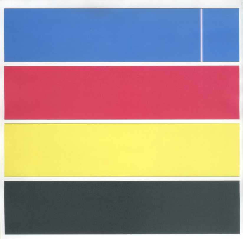

Kindly take a look at the image attached.
Print the CMYK Patch and make sure you use the CMYK palettes and not RGB.
If the line appears in all colors then its not the laser unit, drum or developing.
It would most likely be the IBT Belt or very rarely a 2nd BTR or fuser.
If the line is localized to one color like the image attached then i reckon you begin with the simplest step that would be checking the developer housing for any dust particle or paper stuck under the doctor blade.
If not maybe try changing the drum.
Last option is laser unit! 7183.Scan-120419-0002_.jpg7183.Scan-120419-0002_.jpg
