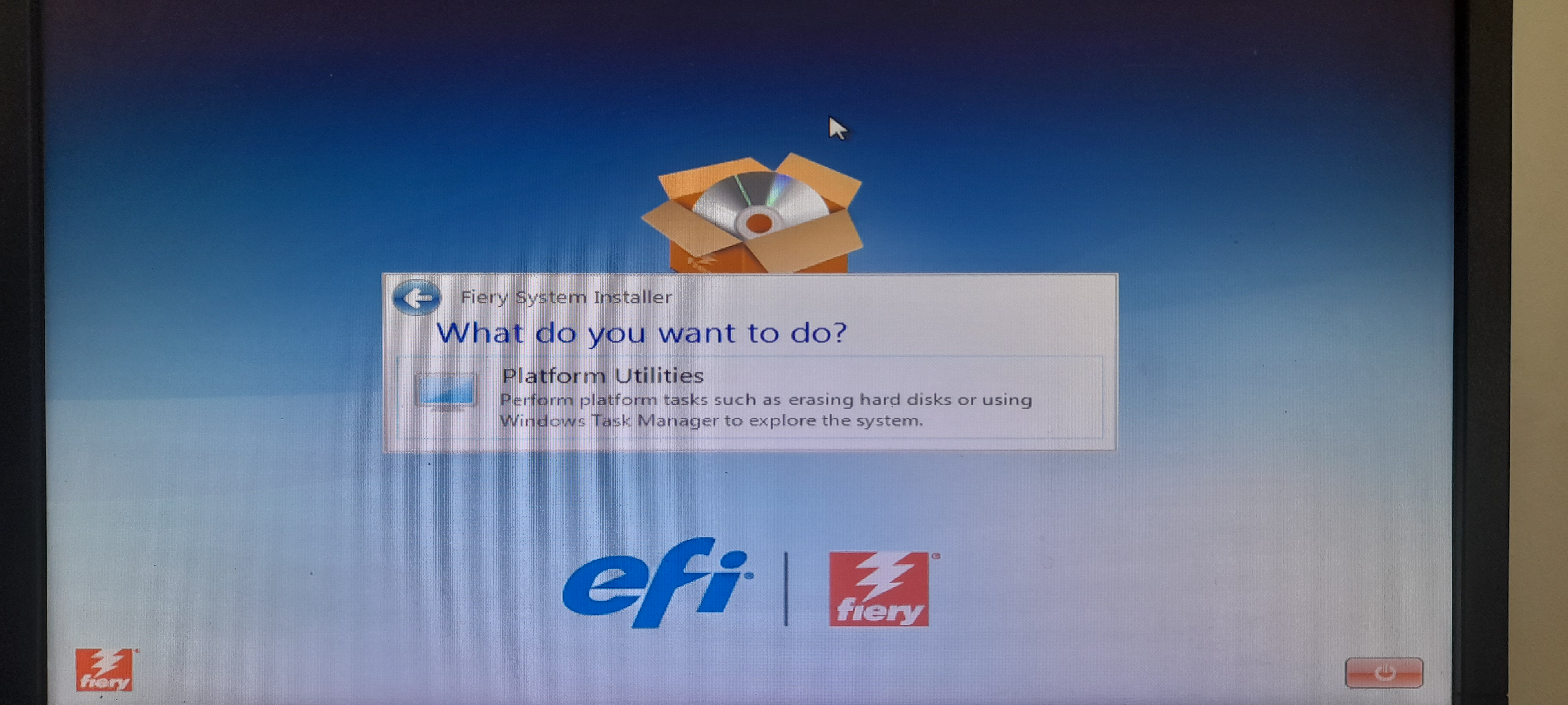

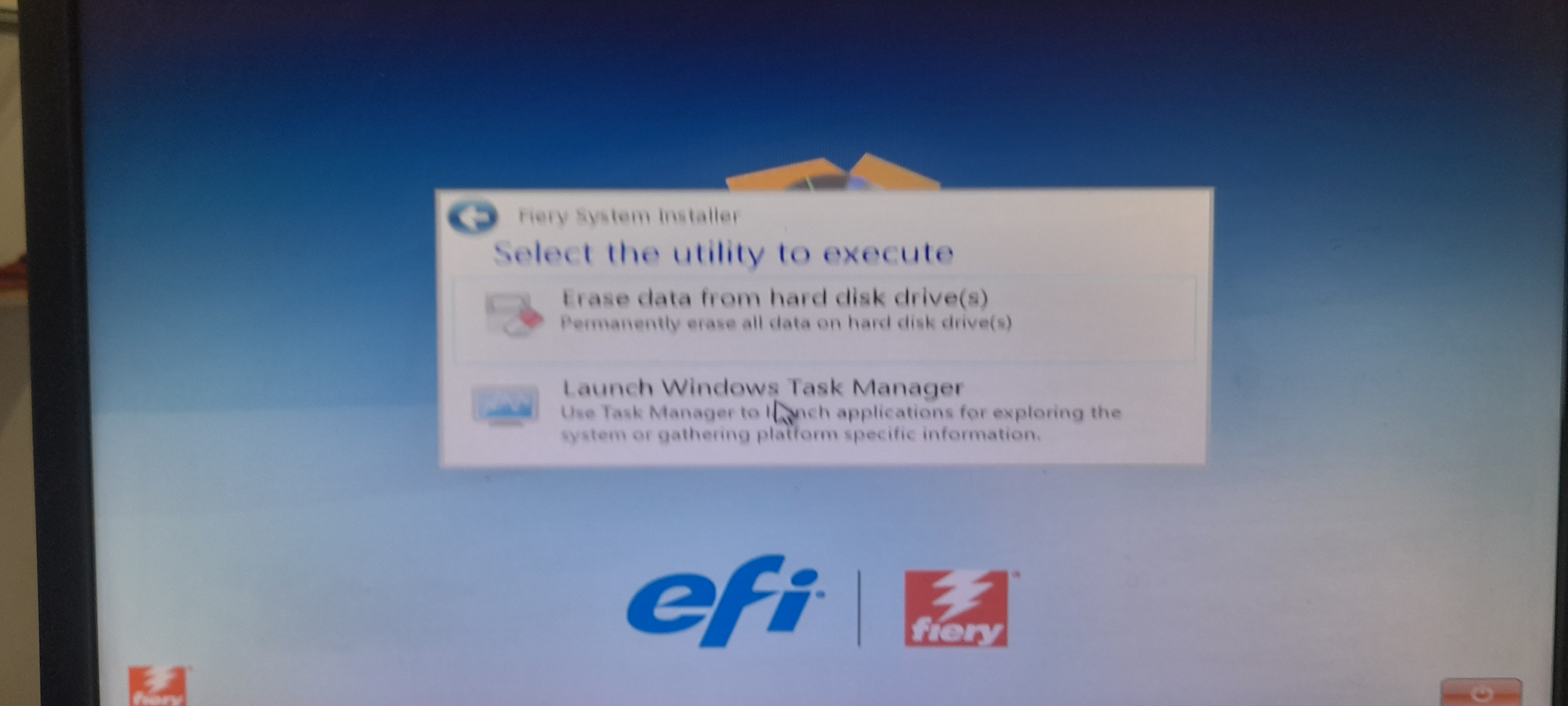

I have the same issue. I have replaced the motherboard and after windows loading and when starts fiery it gets automatically shutdown.I tried reloading the system software but it doesn't show the required steps. I have attached screenshots. Please help to solve this problem
