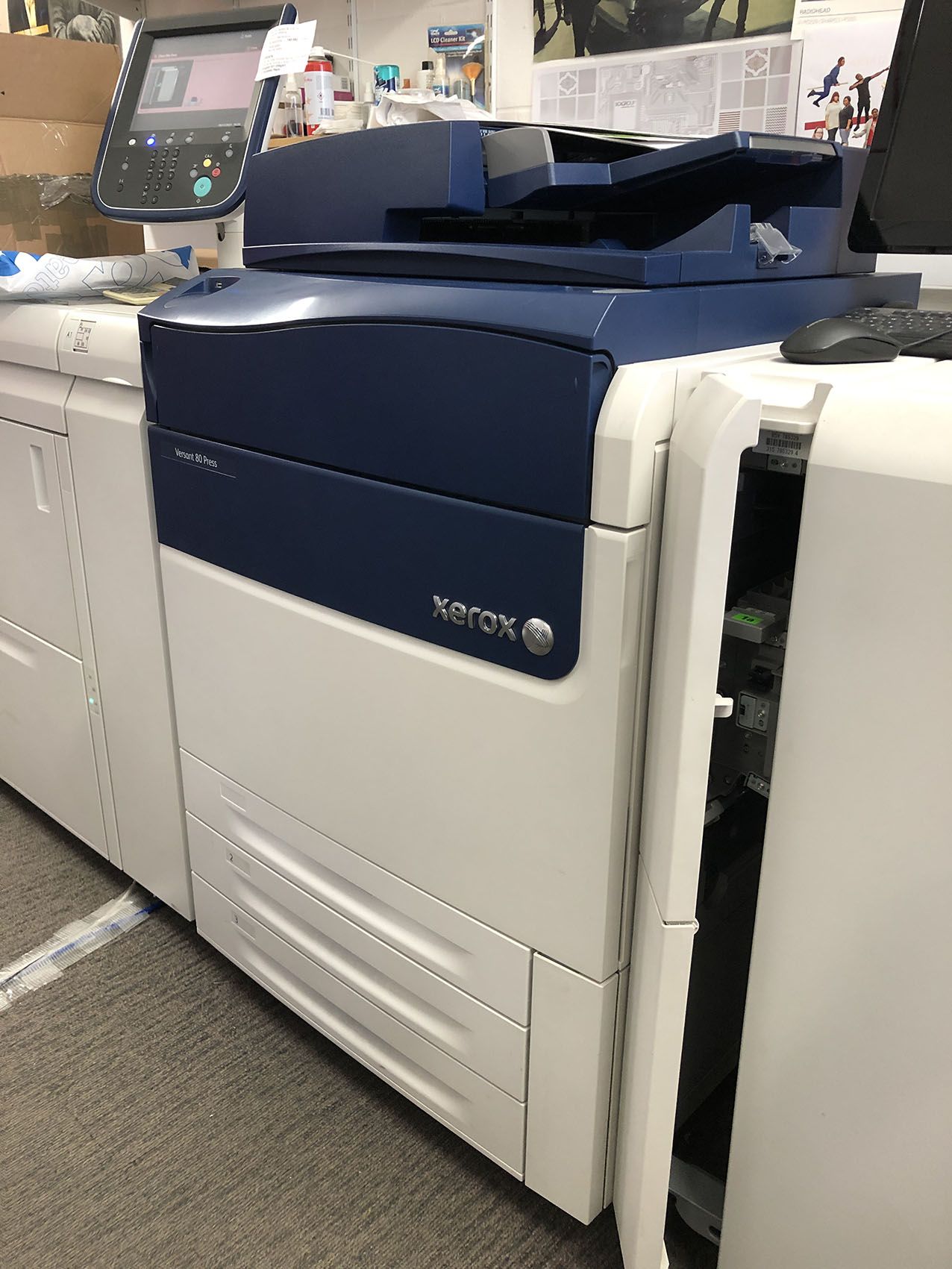

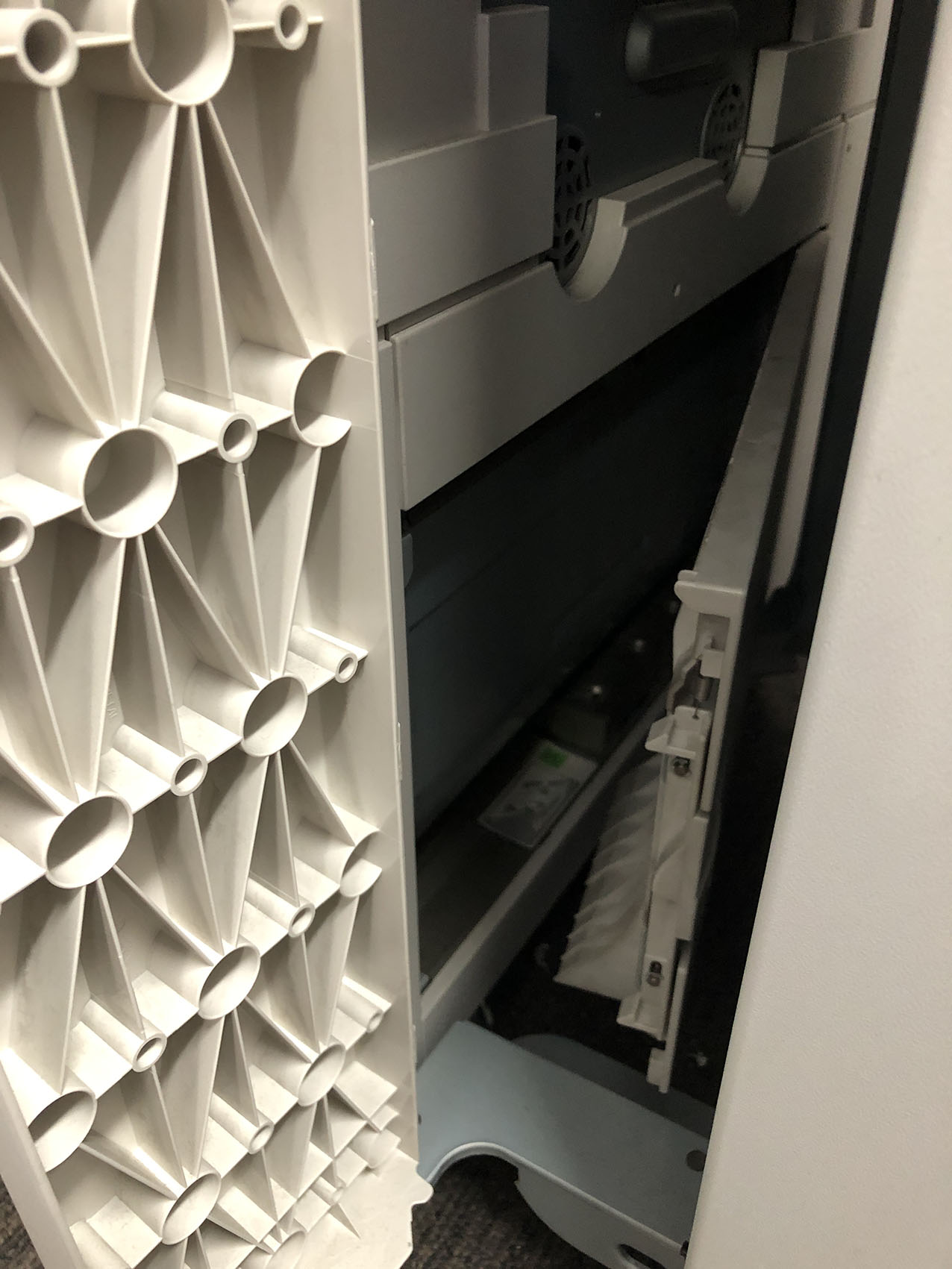

I have a versant 80 this has has happened to me before. This first thing you need to understand is how a sheet of paper is turned over when printed 1 side only as either face up or face down. First pic shows you which door you need to open and the 2nd pic shows you the door for the duplexer. Have a look if there is any loose paper in there.
Thanks for the pictures. I will examine to see if anything is stuck in there.
