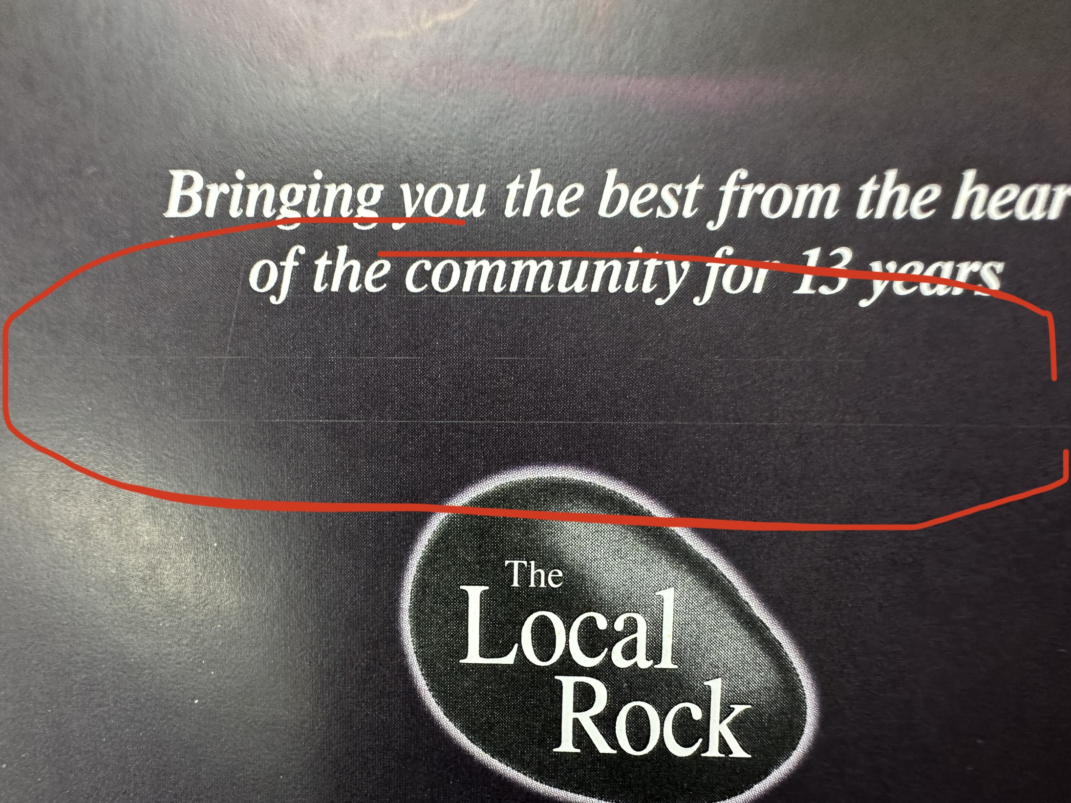

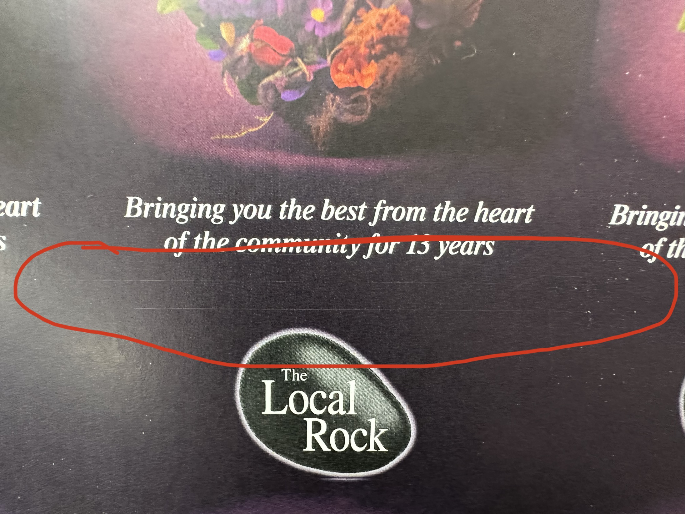

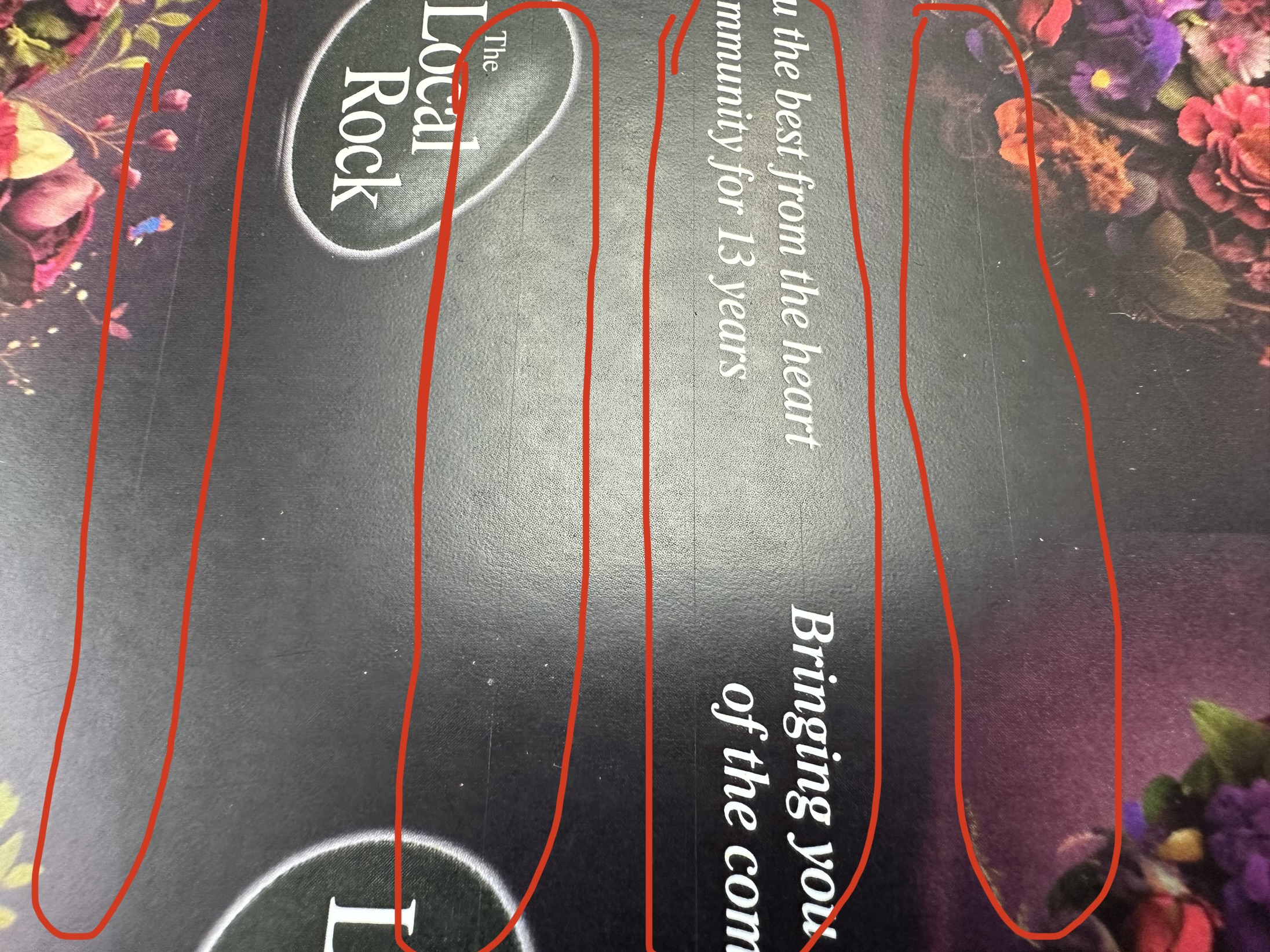

So I was printing some business cards on 350gsm Silk and I stopped the job when I noticed I was getting thin scratch lines all over the sheet.
I called an engineer out and he was adamant that it was the rollers in the booklet maker finisher section.
So he cleaned the rollers and still got the same issue. Then he cleaned the rollers in the decurler module and on the print engine itself, plus the high capacity trays.
He doesn't reckon its not the 2nd BTR as he says thats in good condition, as the meter reading is only on 20,000 clicks.

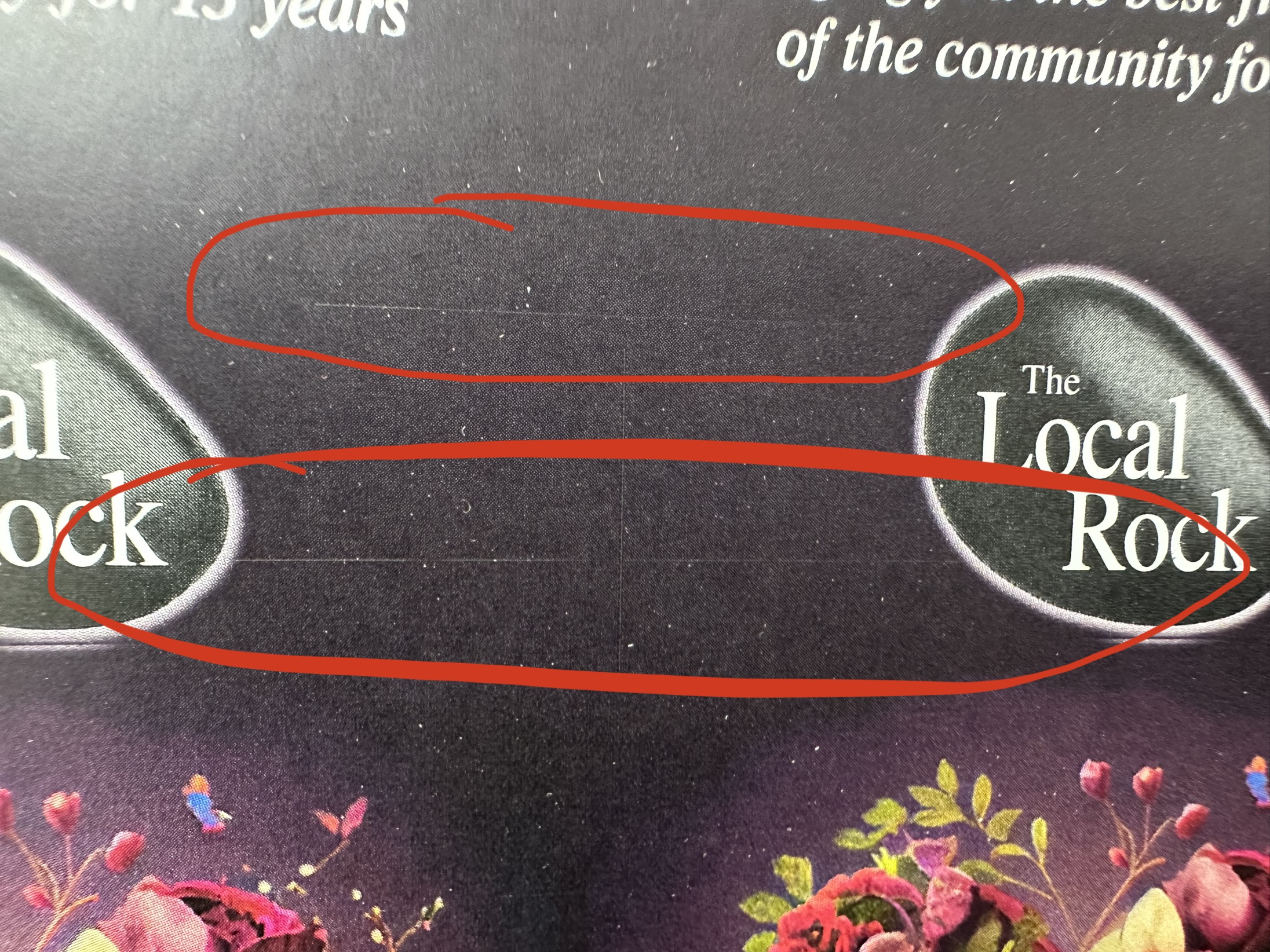

Personally I don't think its from the rollers because they are a certain thickness and these lines are all over the place, some are narrow and some are wide, as you will see from the photos below.
Plus some lines are continuous and others are like a dashed line. Like as though a vinyl record needle is going up and down on the paper scratching it.
The only other thing I can think is if it could be coming off from the IBT belt?
I have tried on different weights / stocks and still getting the same issue.
Any ideas what could be causing it?

Isolate if it’s in a specific color. If it’s in all colors, then examine for lines that match it - probably 2nd btr or fuser. If it’s not on single sided prints, then probably 2nd btr.
If it doesn’t line up with rollers in the paper path, it’s not a roller dragging.

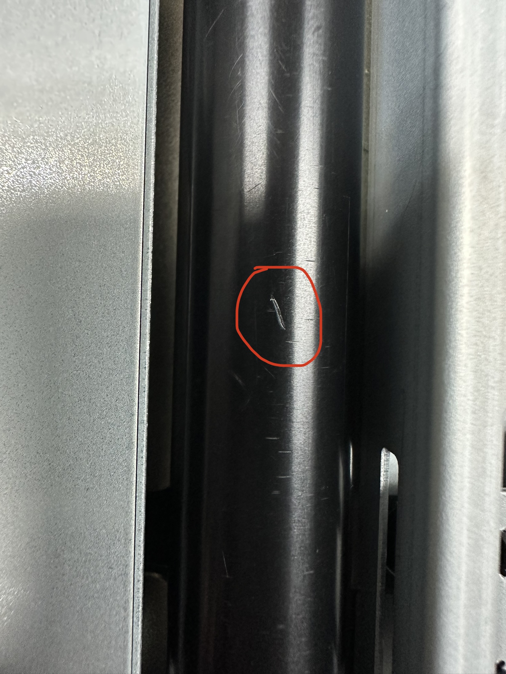

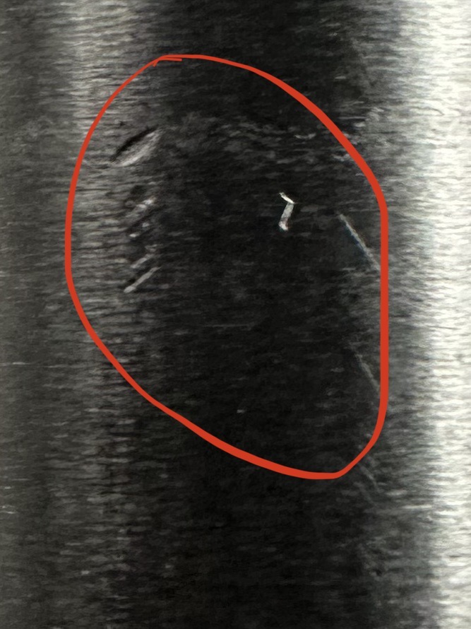

Thanks TJ, from reading your comment about you saying that you haven't got any finisher on your V80, like you said that made me wonder its something on the engine itself. Well I sat and had a good look inside it this morning and I think I have found it.

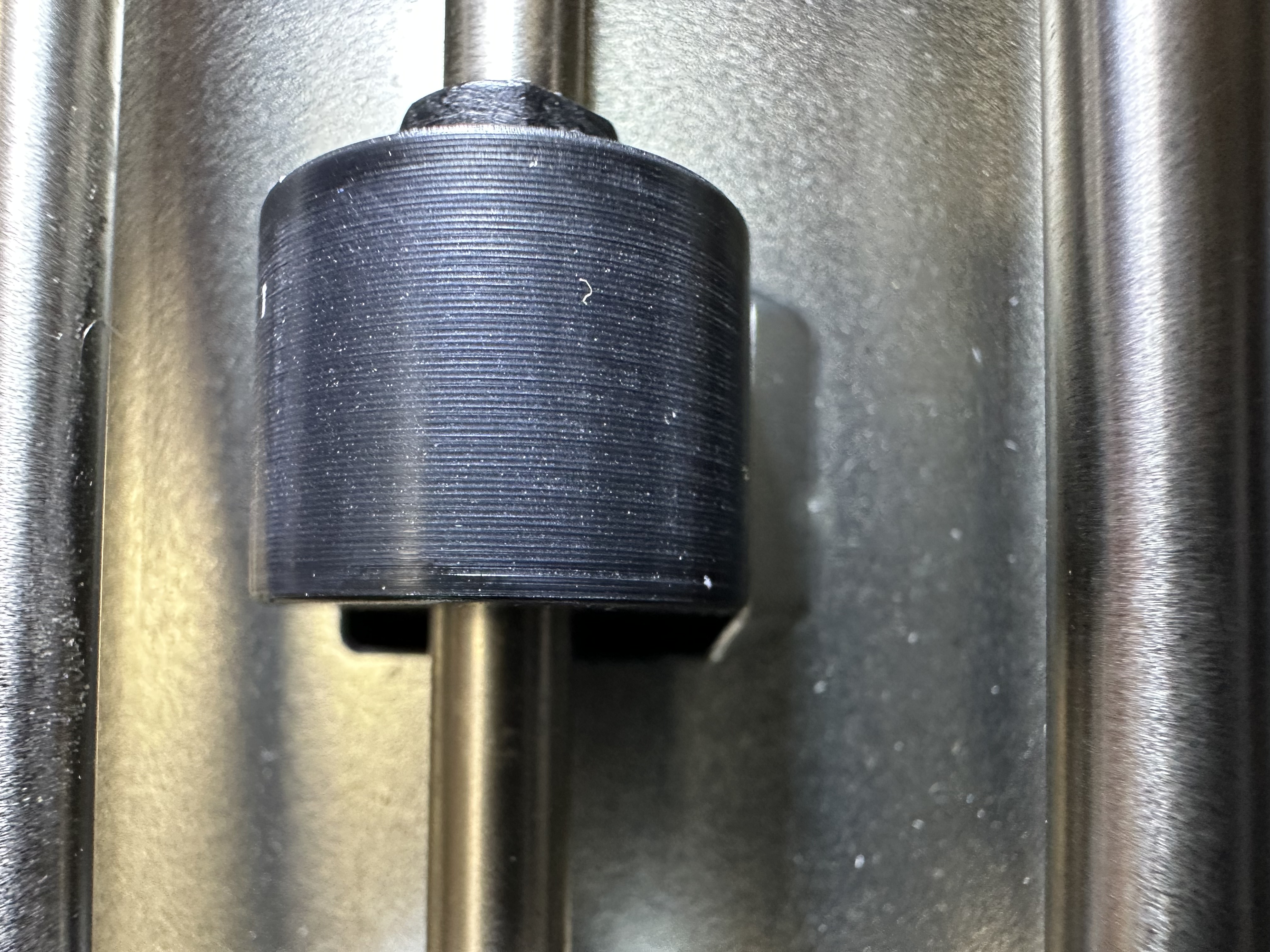

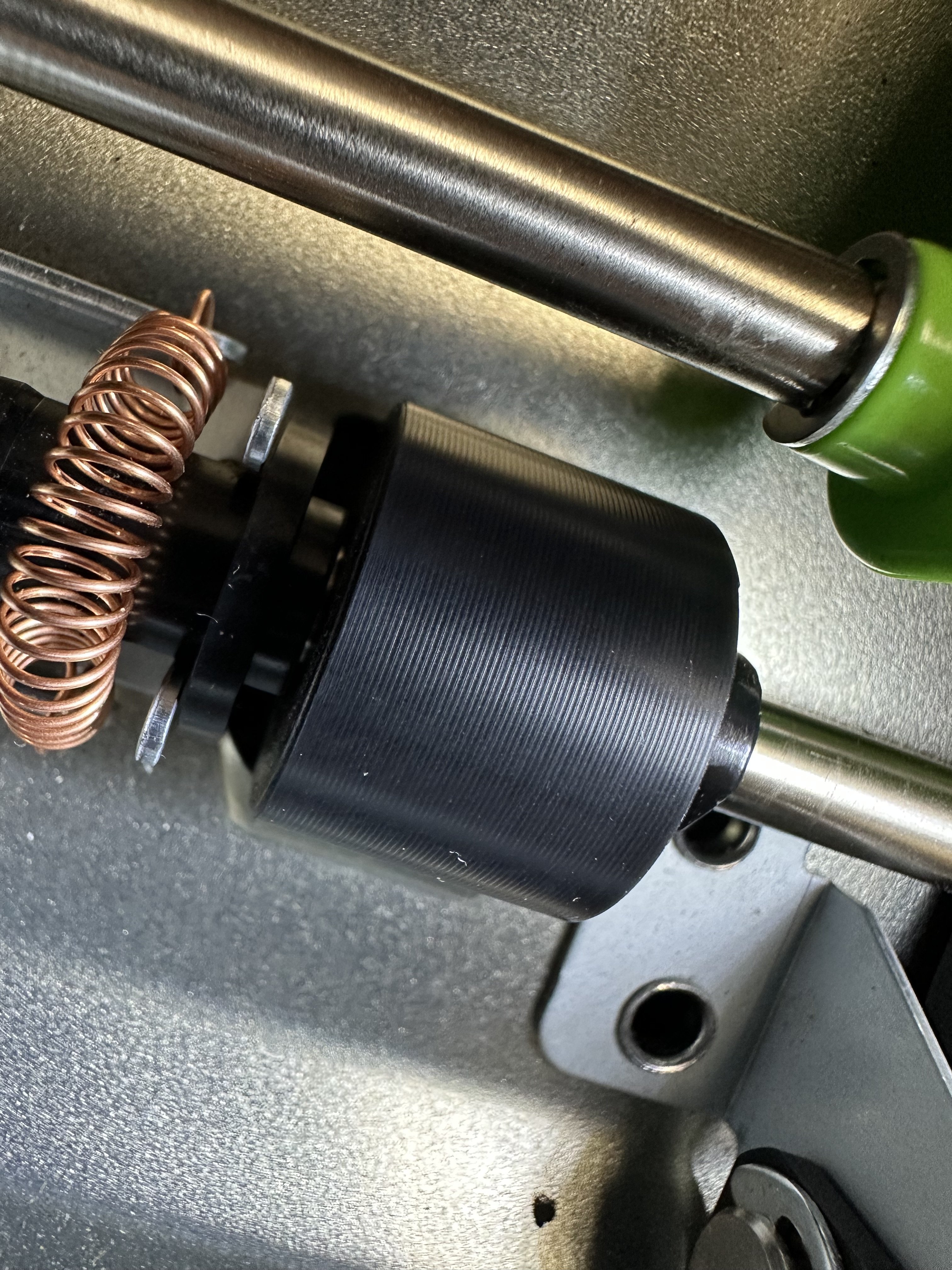

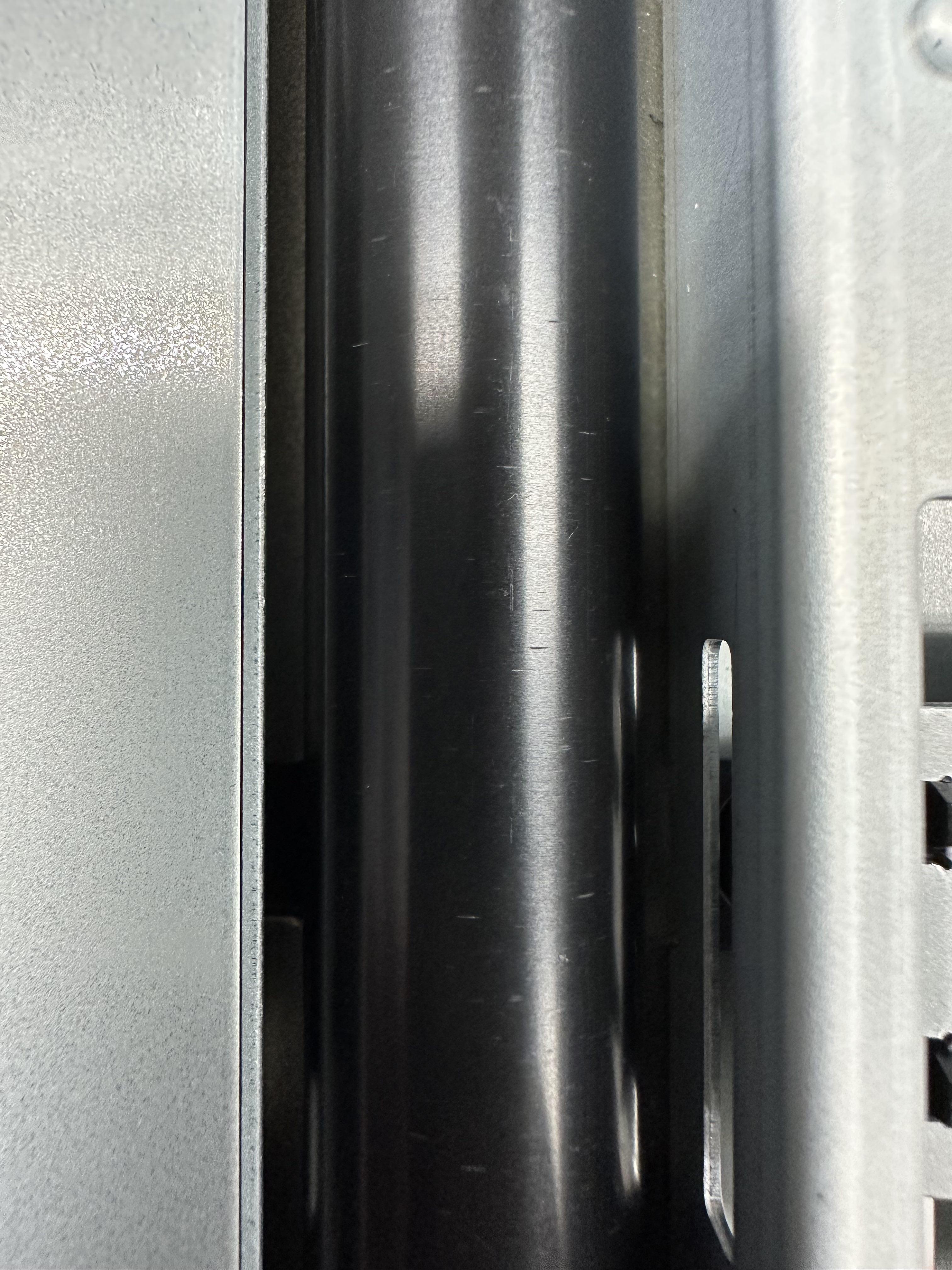

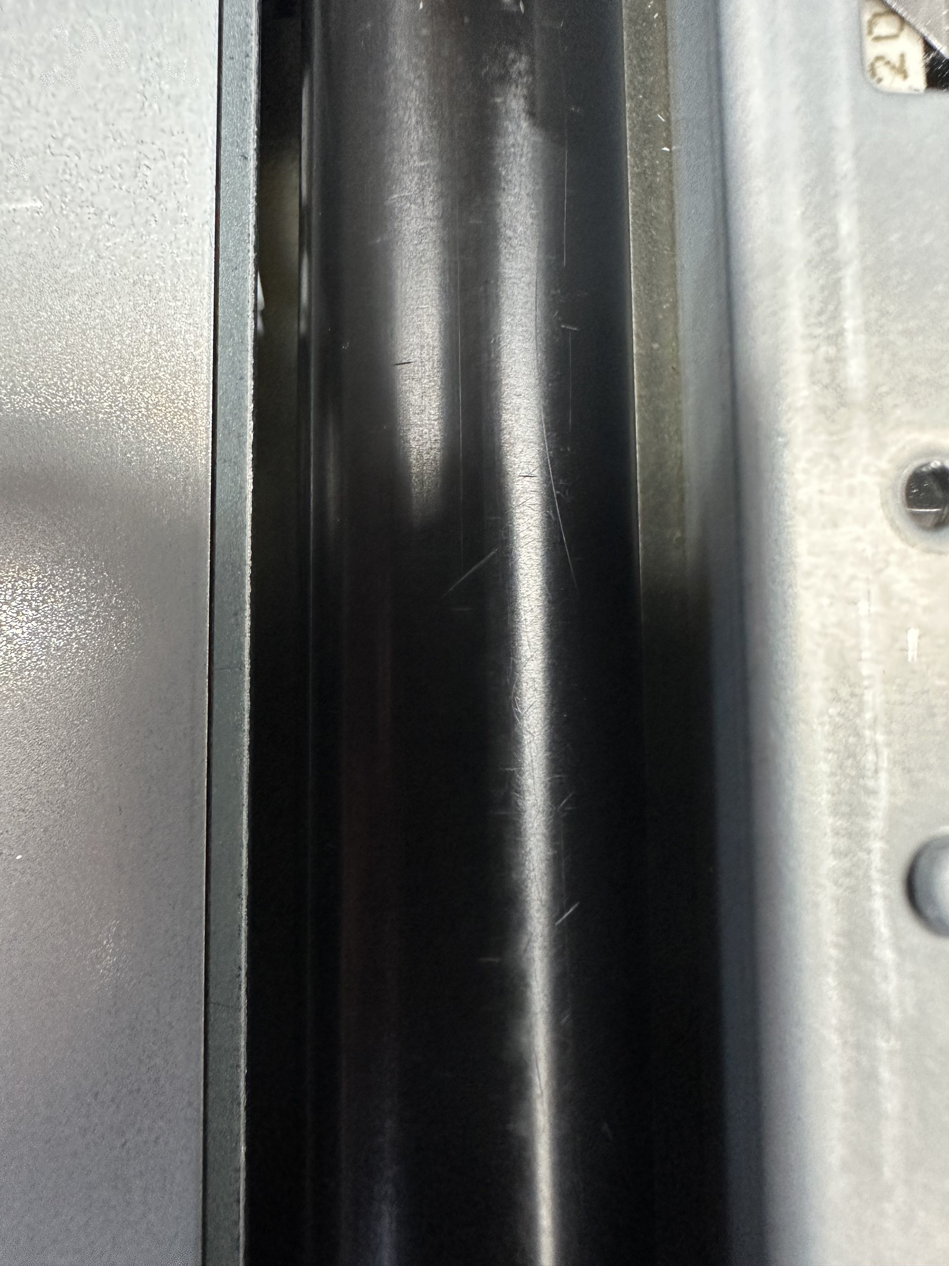

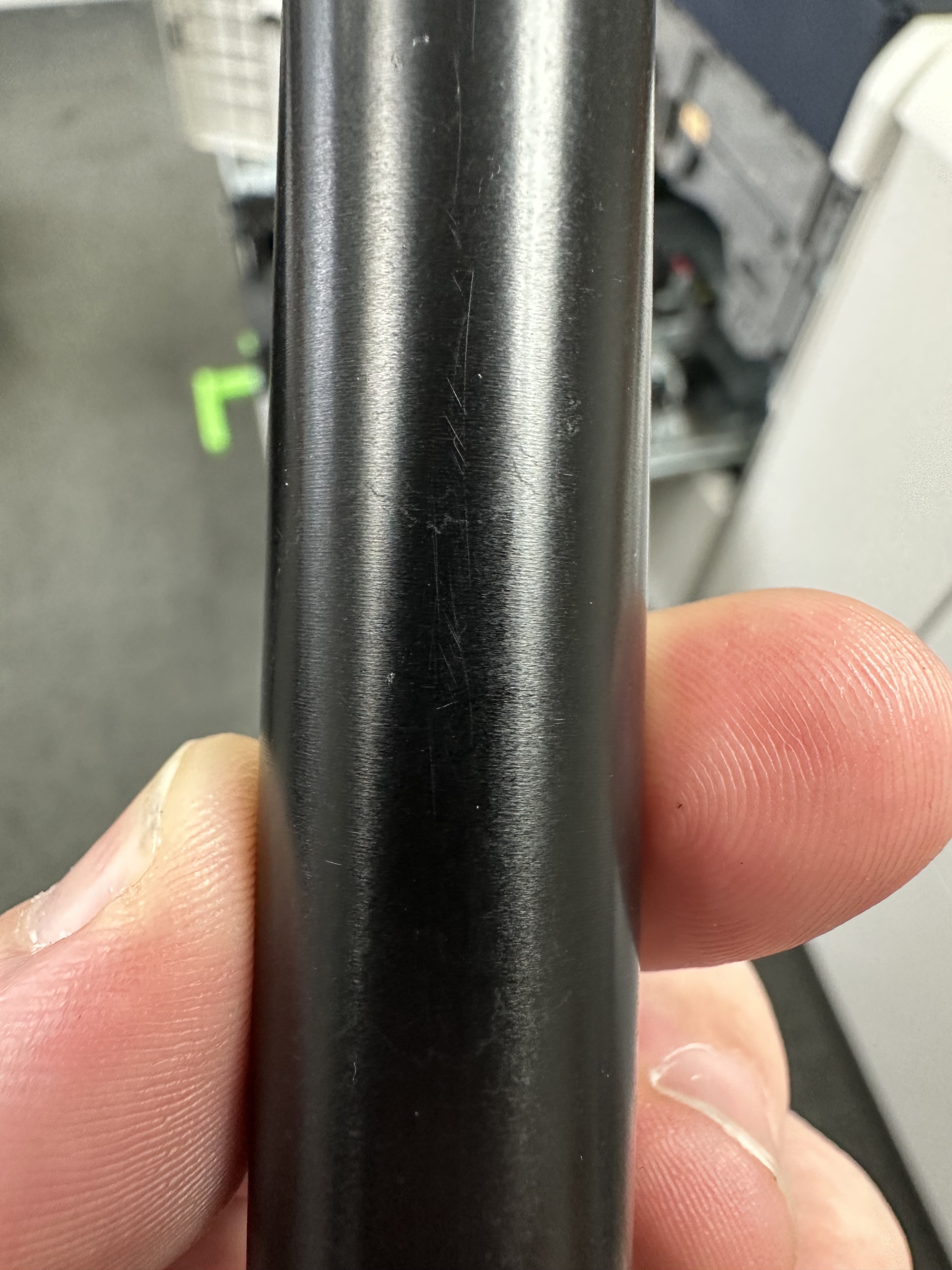

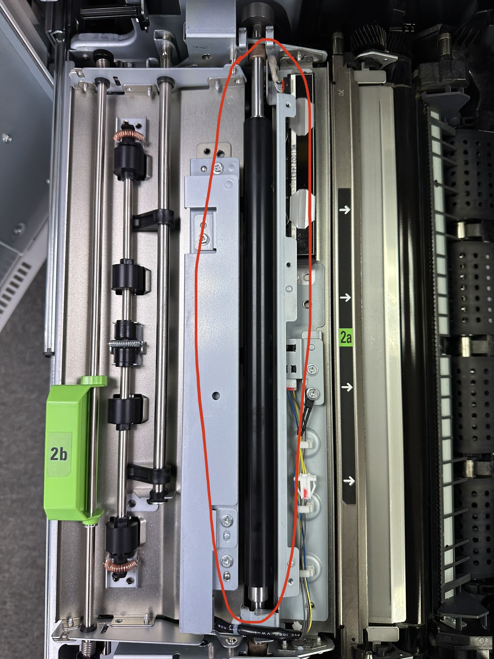

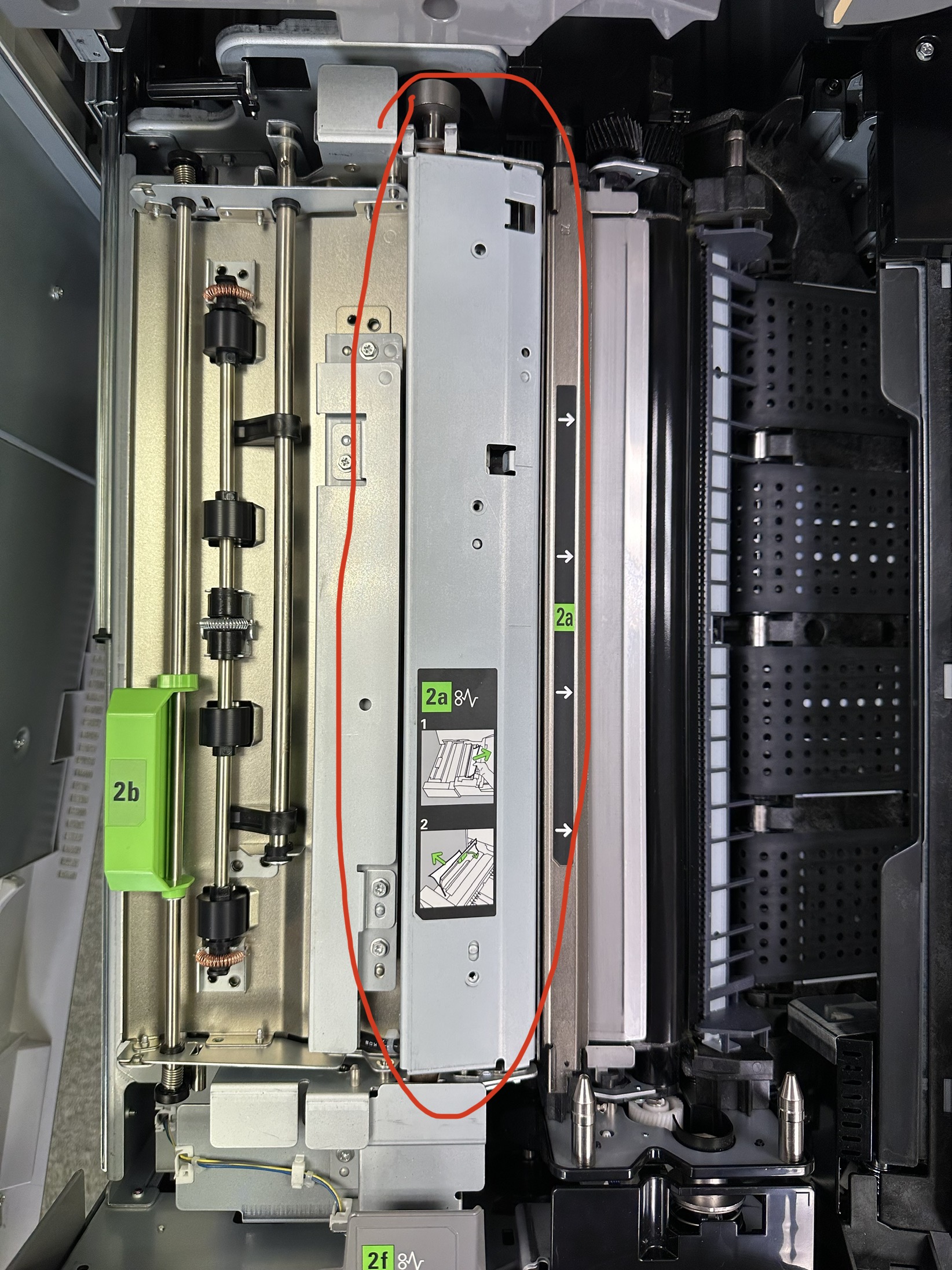

Next to the 2nd BTR there is a thin cover plate on the 2a section. I unscrewed it off and found a hard plastic long roller. Looking at it you can see the dotted lines and long lines on it. Also I saw the diagonal indent mark that I have seen on jobs.
So I have WhatsApp the engineer to show him, and hopefully will come back out soon to replace that part.
The only thing is I need to find out, what has caused it to scratch like that?

pippip
So if it's that roller its scratching the sheet prior to toner hitting the sheet.
DYP
Could very well be that roller because that would cause the same scratches on both sided of the sheet. I wonder what the roller underneath that roller looks like.
My main paper I run is 150gsm, 250gsm and 350gsm in silk. 120gsm and 350gsm in uncoated. 75gsm NCR paper.
The only other new paper I tried with samples was the tearproof paper from Xerox Nevertear and Ashgrove Perma Paper and Picofilm.

Wow, that looks like it's in rough shape. I just pulled the cover on my 280 to see what kind of shape it was in. It looks nothing like yours and I have about 600,000 clicks on it. It's still smooth with no markings at all. Mine is a hard roller and if yours is the same I can't imagine what could cause that kind of damage. The primary charge roller is the roller under this roller.

Anyway I sent the photos to the Xerox engineer on WhatsApp and he called me back. He said that is called a registration roller, so he will order the parts in, as he said there is a roller underneath that one too. So it will be interesting to see what that will look like as well.
Yes, I have heard and been told about the 2nd btr. There is a good forum on Xerox page called "The Dark side of Versant 2nd BTR". The engineer did tell me that when that part needs replacing, he will train me up for future use, instead of having to wait for an engineer to keep coming out to change it.

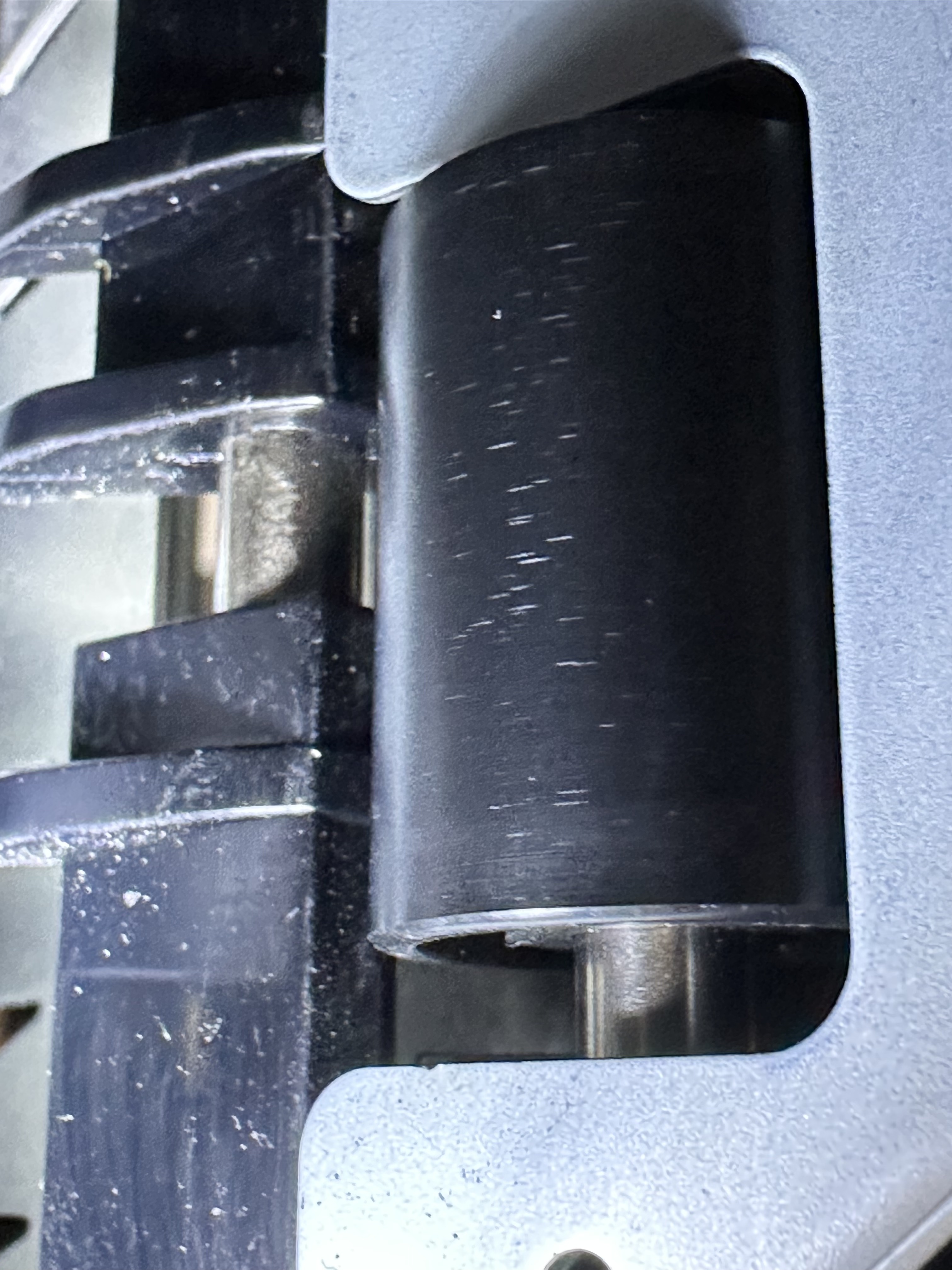

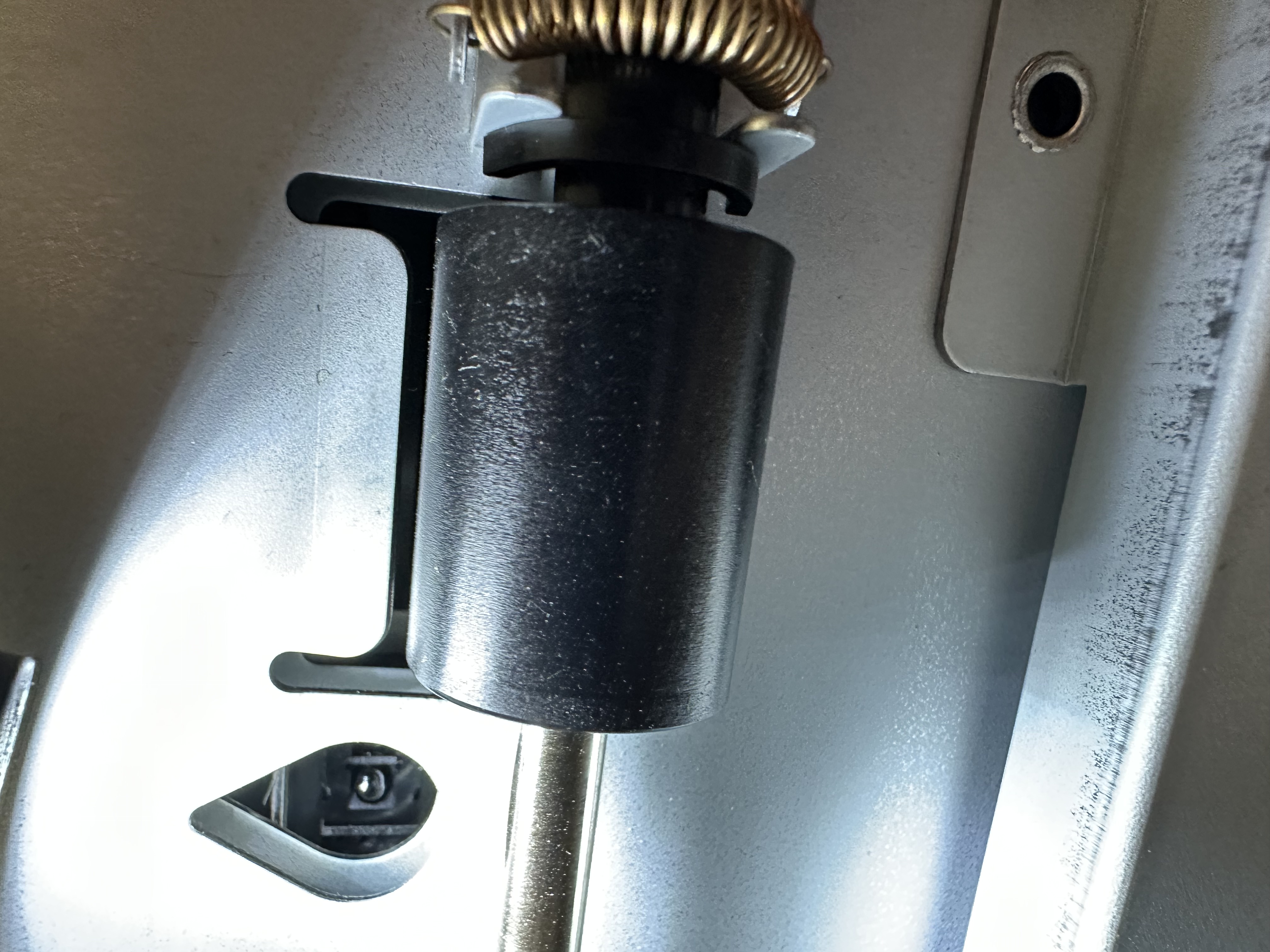

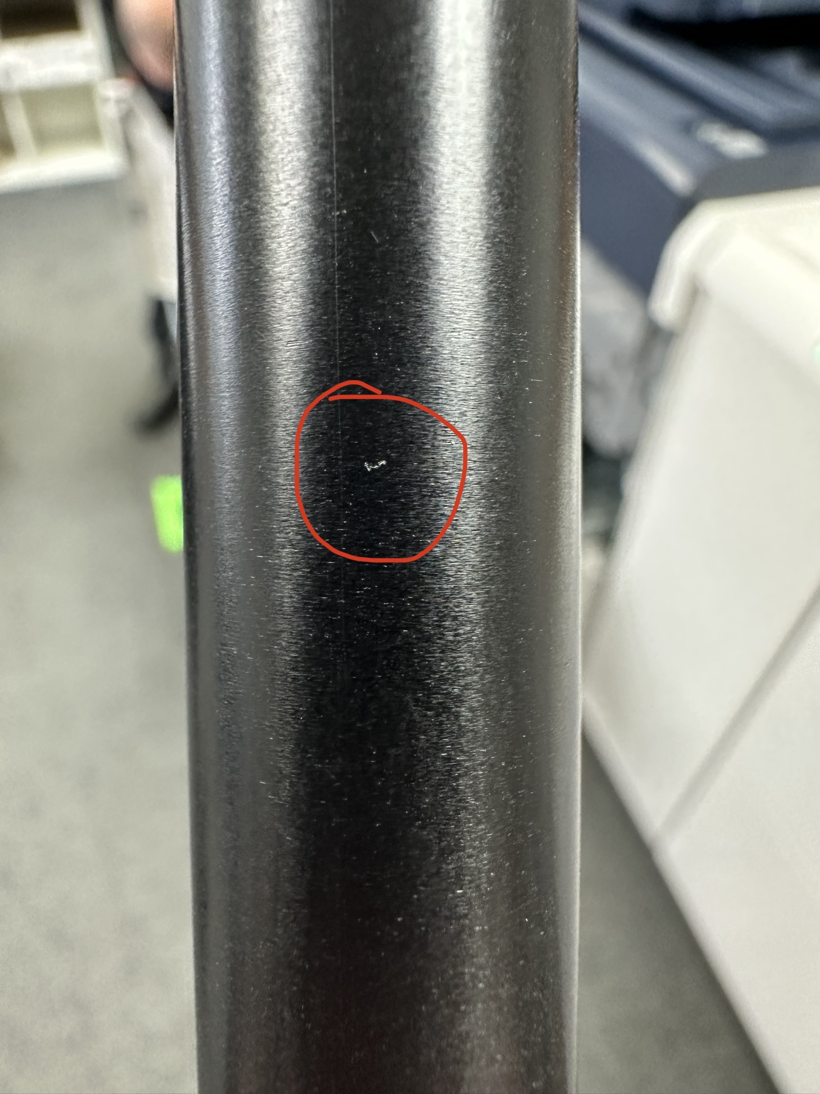

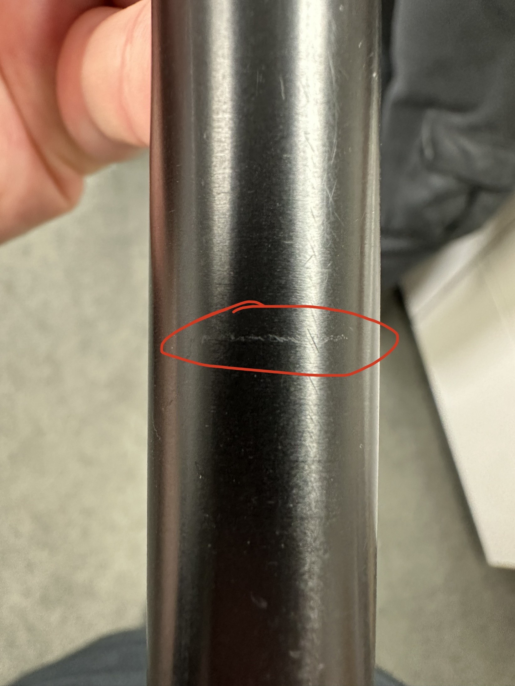

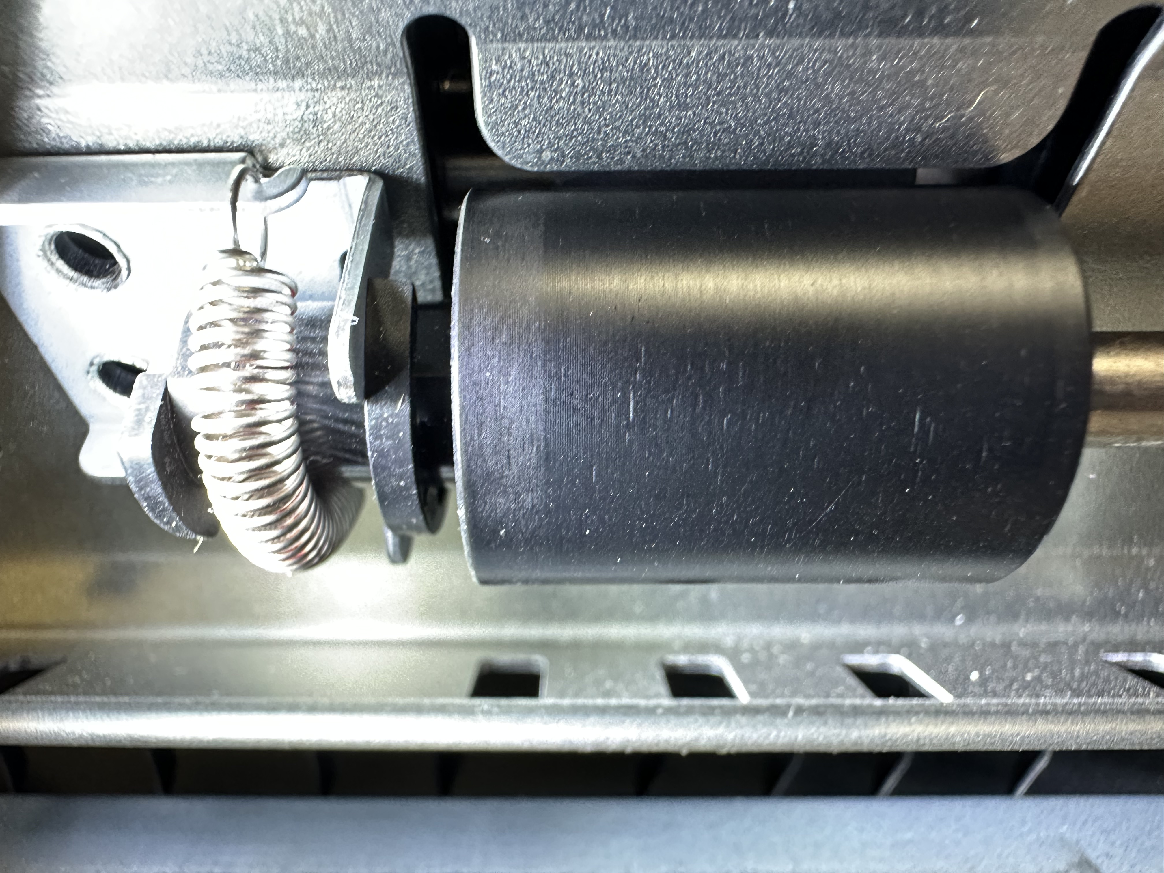

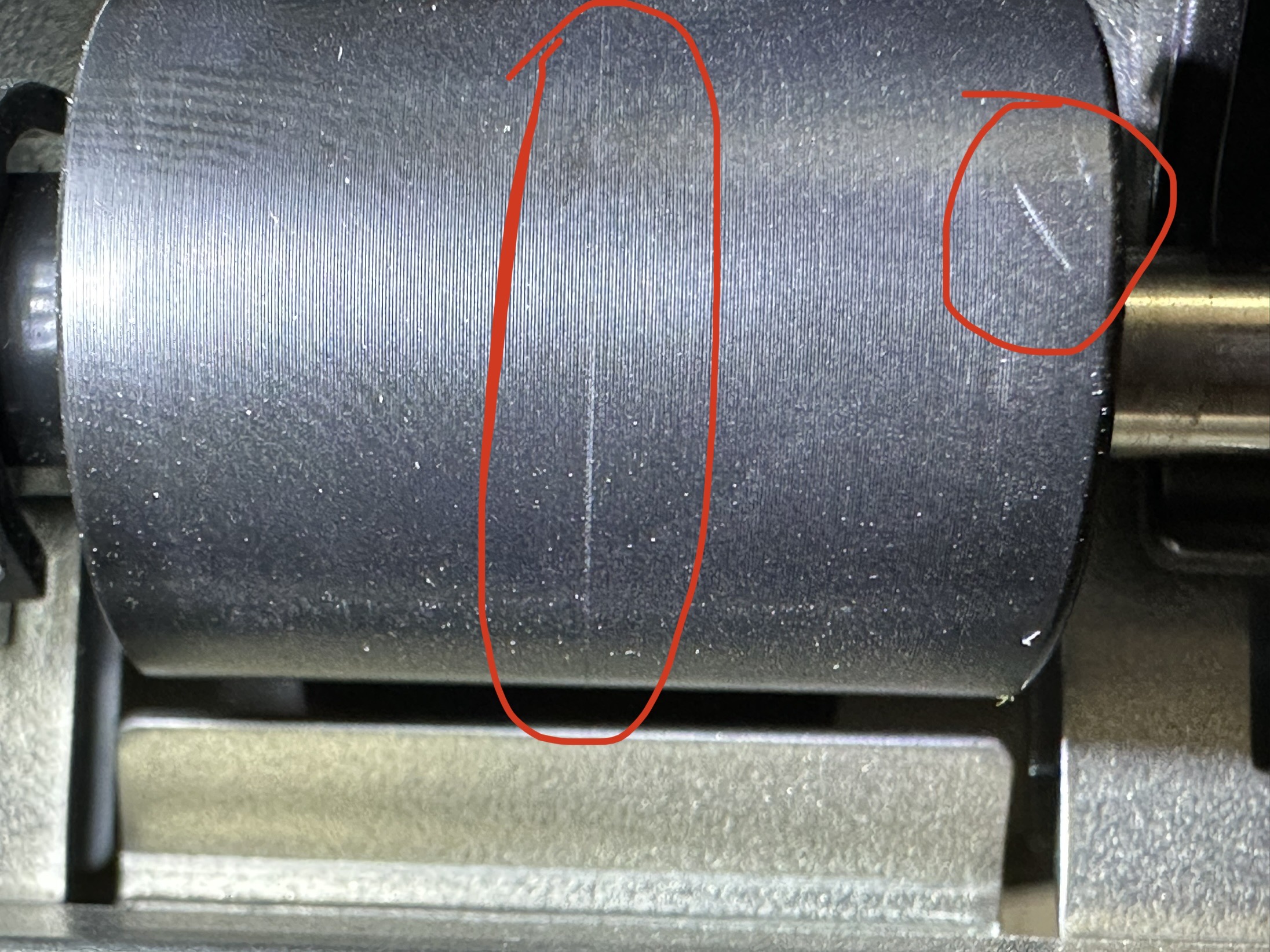

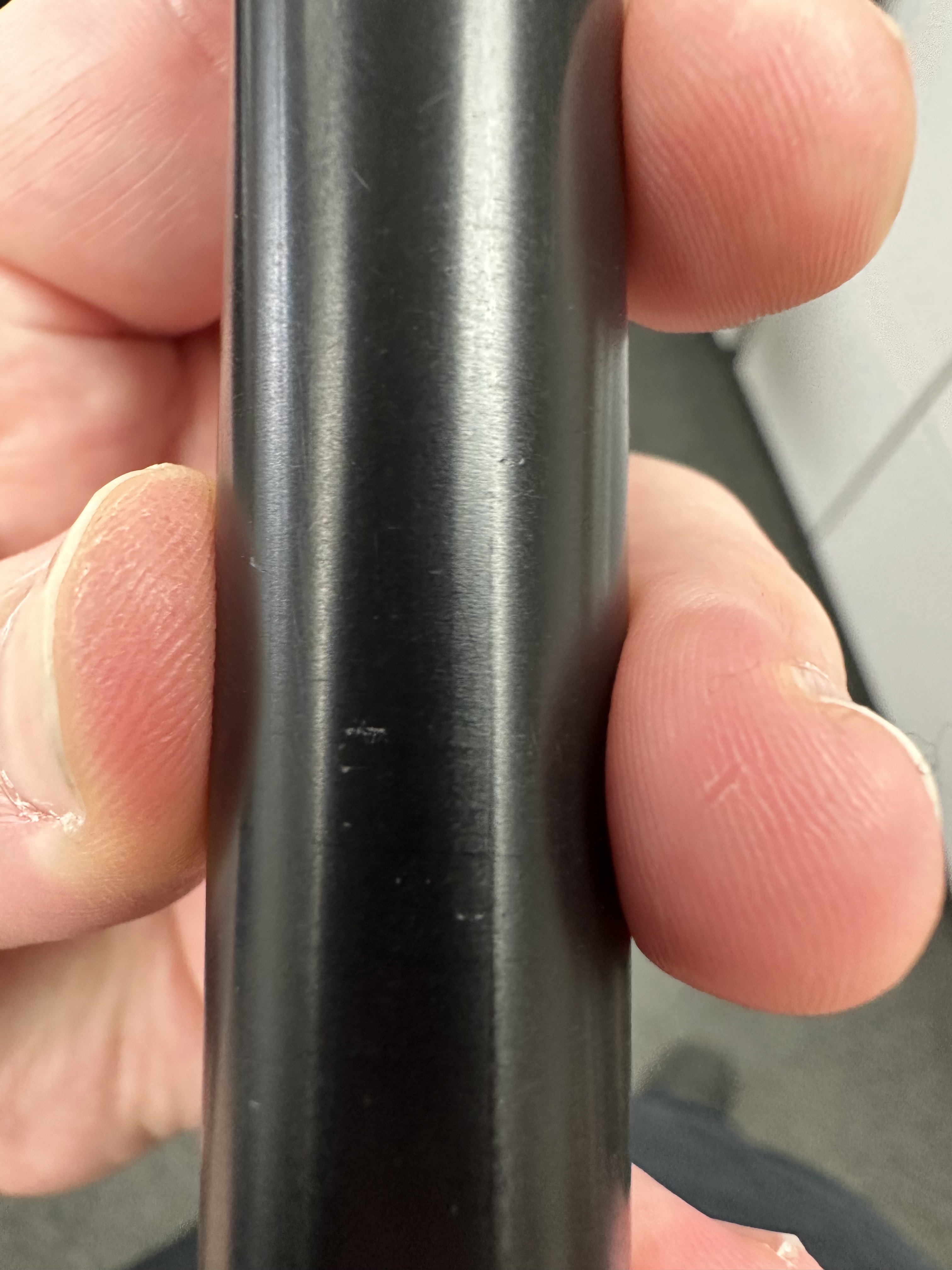

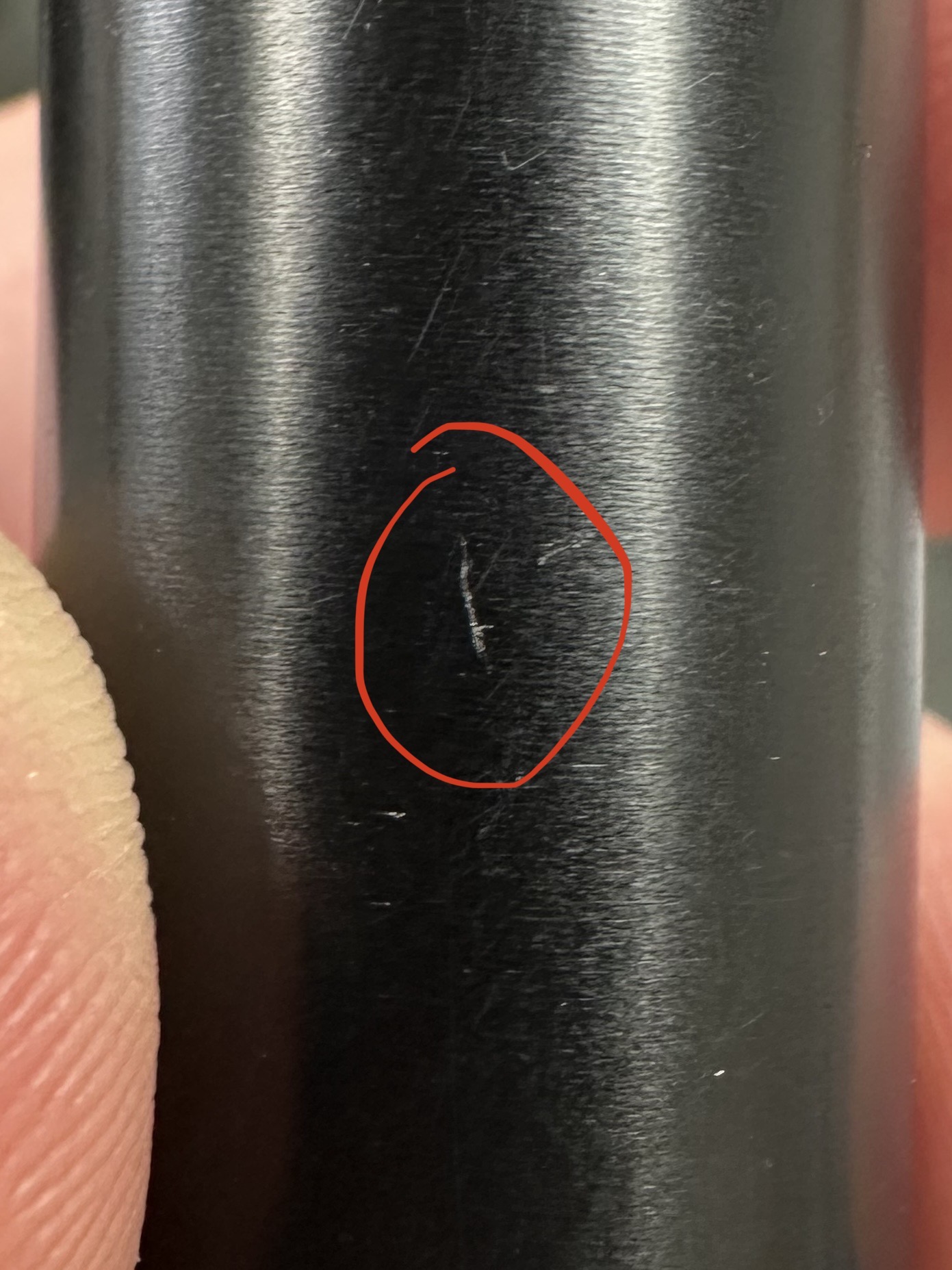

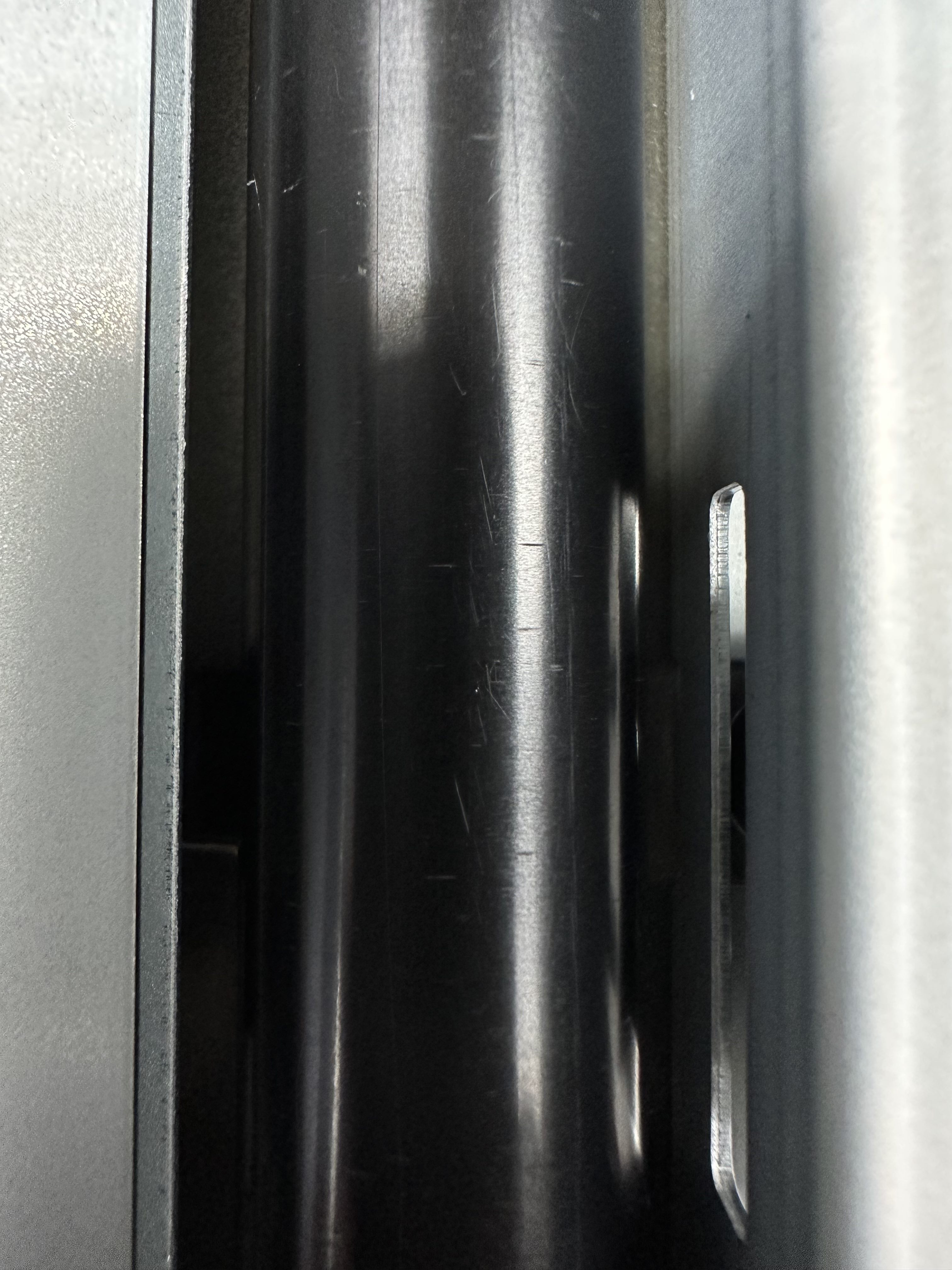

Hi TJ, so the engineer came out with another new roller, but this one was in very bad shape as well. Quite a few scratches and dents on it, makes me wonder if it's been used and just resent out? He has ordered another roller, just to see what condition this will come in.
You know when you said your registration roller is in good condition, would you mind taking a photo of yours so I can see?
It's making me wondering if there is some kind of manufacturing issue going on?
Here is photos below of the new roller.

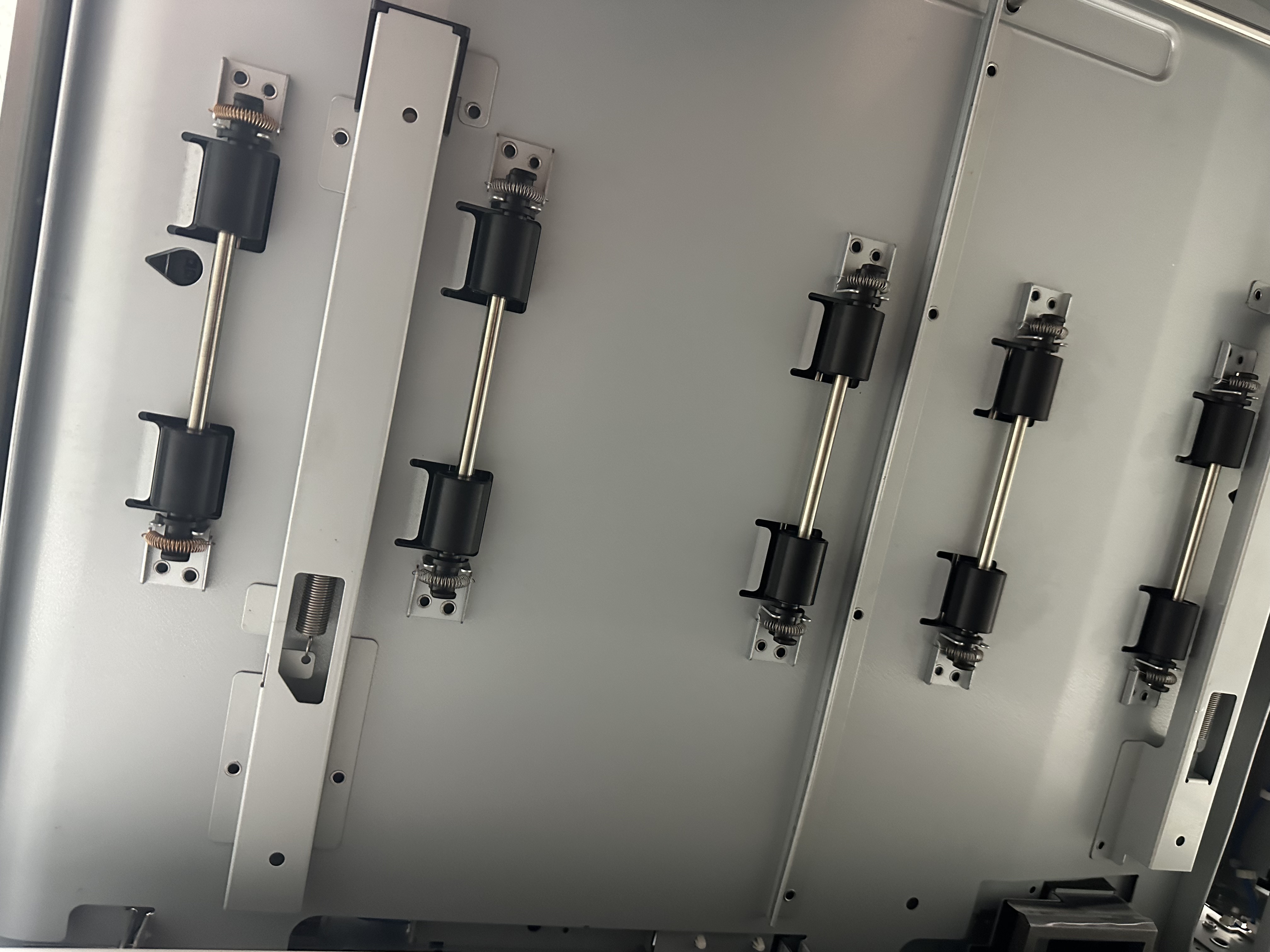

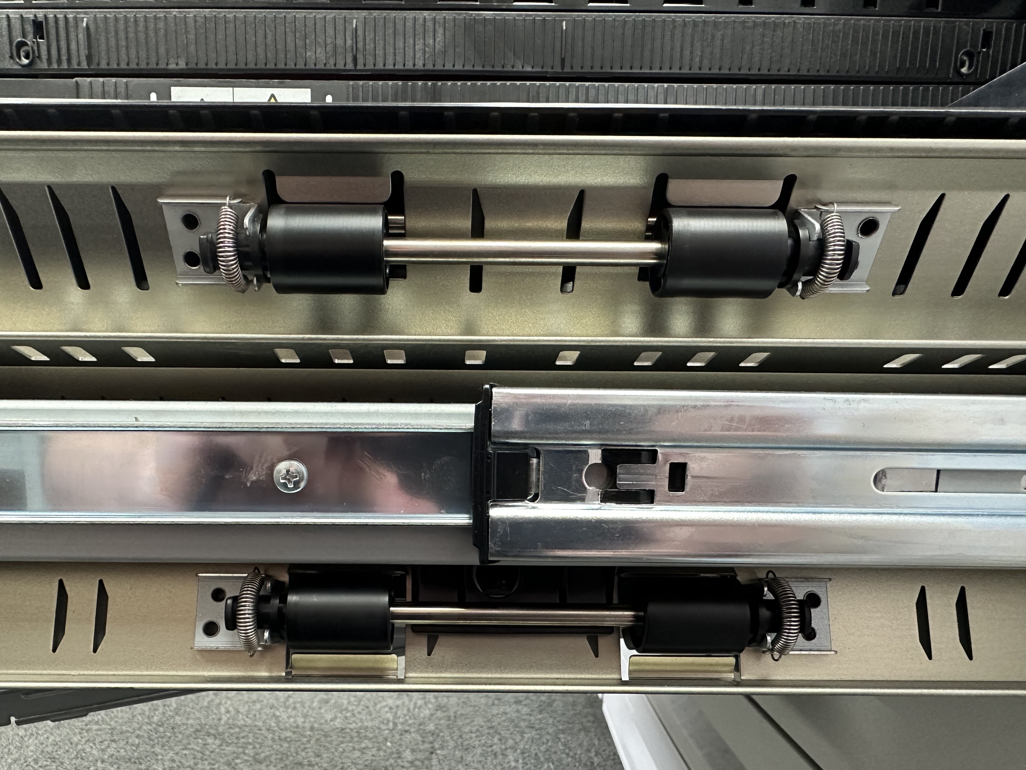

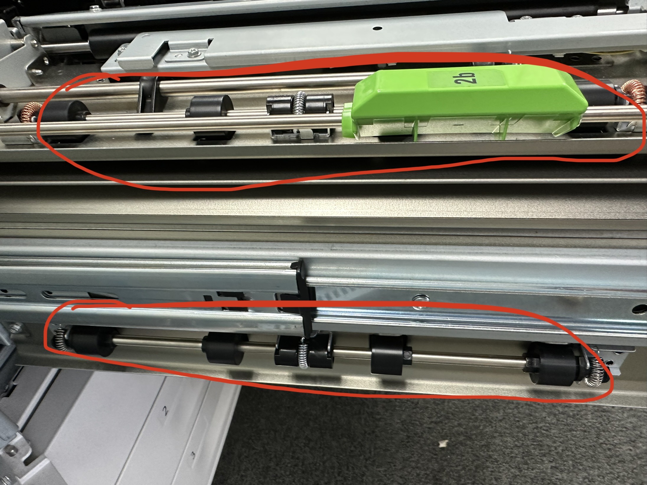

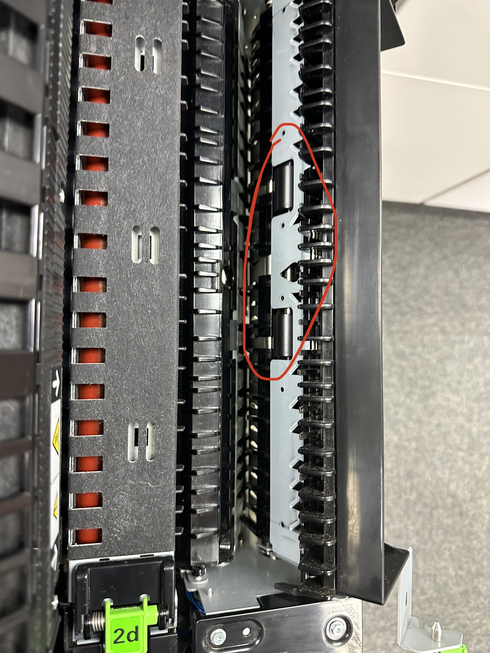

While I am still waiting for a third new roller, I had a look around the small rollers on the engine itself.
Looking at the 2b section area, these rollers look fine.
Then there were 2 rollers on the 2d section that were in bad shape.
Underneath I could see another 2 rollers which could also be contributing to the issue.
The rest of the rollers on the high capacity trays, decurl module and booklet maker finisher look to be fine from what I can see.
