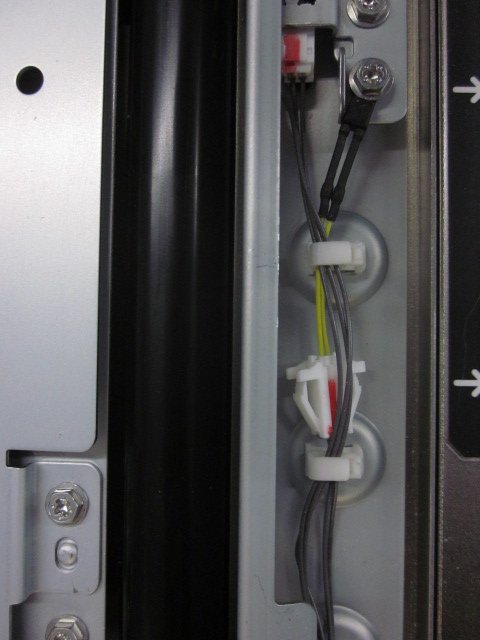

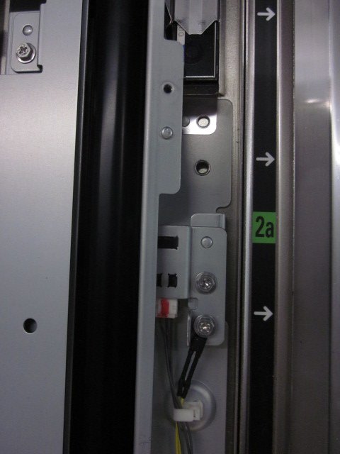

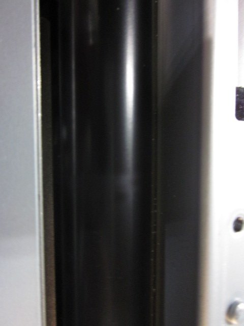

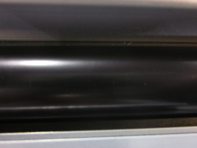

Hi TJ, so the engineer came out with another new roller, but this one was in very bad shape as well. Quite a few scratches and dents on it, makes me wonder if it's been used and just resent out? He has ordered another roller, just to see what condition this will come in.
You know when you said your registration roller is in good condition, would you mind taking a photo of yours so I can see?
It's making me wondering if there is some kind of manufacturing issue going on?
Here is photos below of the new roller.
I don't see any dings in the roller that I have. These are the best photos I could get with the camera I have here today. It's a hard roller so I'm surprised that the ones you have look kind of beat up. Hard for the engineer to determine if it's that roller when they all seem to have marks on them.

Wow these are pristine compared to NorwoodPress pics.
I have never heard that the registration rollers scratch, at least not in one side mode. In one side mode the rollers come into contact with the paper before toner is placed on the paper and then no longer come into contact with the paper. Even if there are dents on the rollers, they do not give a continuous scratched line.
I'll just chime in and say I've never seen my rollers looking like this. I'm guessing you run something super unique that none of us do that has caused this. Can you extensively list the different stocks you run?

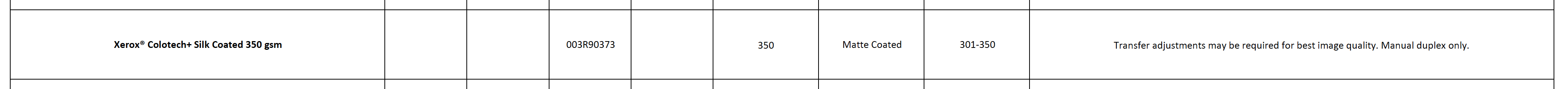

I was also shown that the RML (Recommended Media List) that it has got down stating that Xerox Colourtech own paper states the following:
Xerox® Colotech+ Silk Coated 350 gsm - Transfer adjustments may be required for best image quality. Manual duplex only.
The conclusion is now apparently the machine is not capable of running 350gsm duplexing. Yet the machine is advertise it can do this. And supports up to 400gsm simplex.

Interesting. I'm just wondering can you confirm your earlier comment on it occurring on both single sided and double sided?
Was the single sided face down?
Surely if simplex, face up and marking then it's still not meeting the RML theory of manual.
