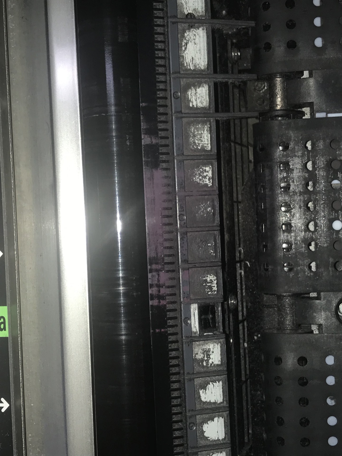

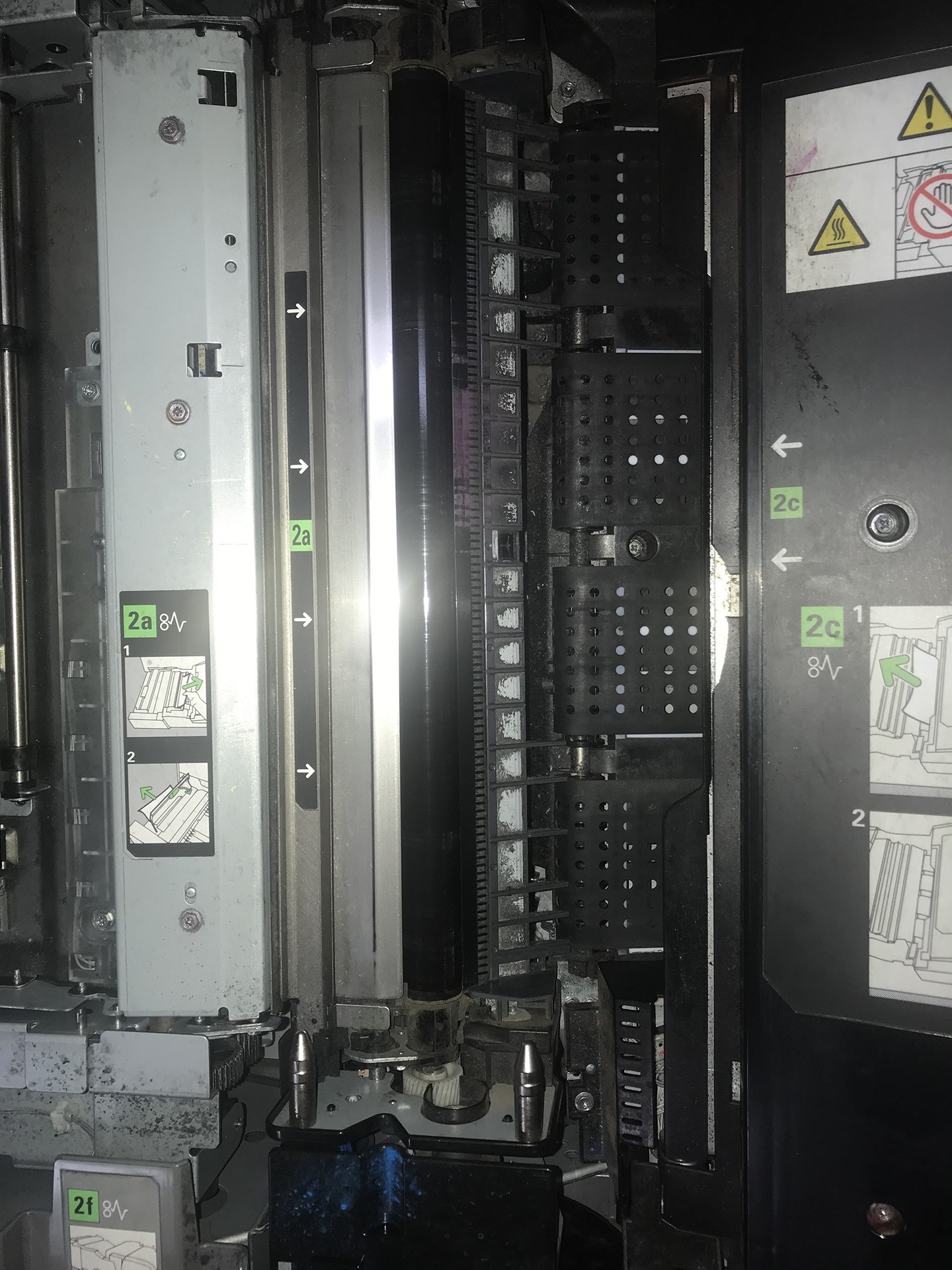

Can anyone tell by the attached images if the 2nd BTR Assembly is bad and causing all this toner left behind causing poor quality or dirty edged on all prints in that same area on the sheet? I'm going to have my manager order the part as we aren't currently on a maintenance contract anymore but wanted to be sure before ordering a $600 part. Thanks!
Looks pretty bad to me. Check your usage counter. It is probably way overdue to be changed. The 2nd BTR also collects some toner, is it full?
Has the IBT cleaner been cleaned out or replaced?
It hasn't been replaced yet, actually had a tech out and said he thought it was the fuser, another tech said he thought it was coming from above. I'm the digital printer here and just trying to find the cause so I figured it was the unit itself and not the fuser or above IBT belt that all seems fine. I haven't cleaned it other then whipping it off but of course it comes right back. Would you recommend taking it out and vacuuming it and trying that. My manager is going to order a new one I was just trying to verify that it is the unit causing that problem before ordering it since we have to pay for the part. Thanks for your reply!
With poor quality or dirty edged on all prints in that same area it is most likely (and it looks that way) the 2nd BTR roller. You will need another 2nd BTR at sometime anyway so it won't hurt to order one and have it on hand.
Ok thanks, the worst part of it is that it gets the back side dirty and if you duplex anything those dirty toner gets fused on but if we run it simplex it just wipes off. I'm going to have manager order part and I'll try to replace it and then hopefully back to normal.
