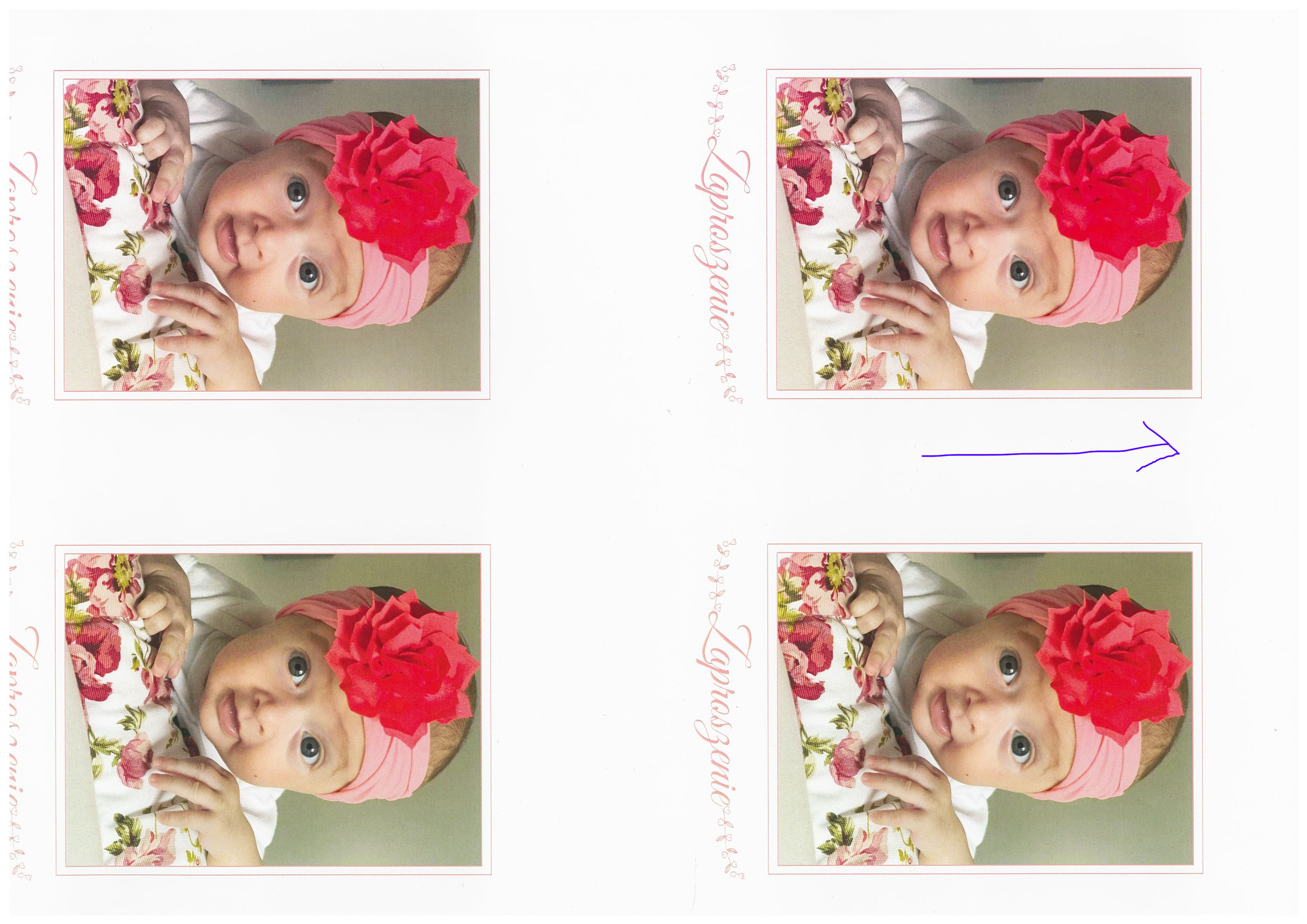

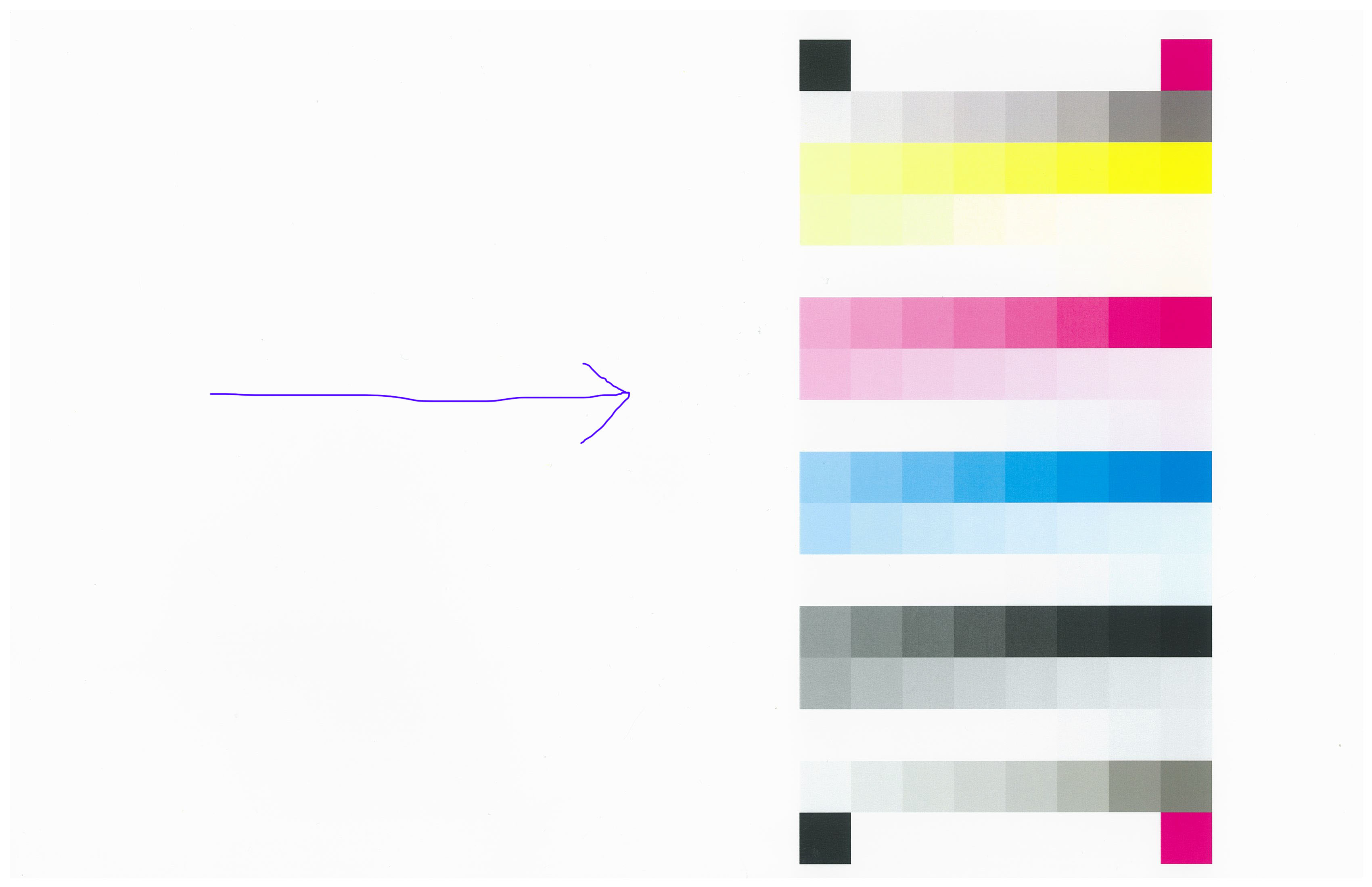

I have a problem with colors across the page. See attached scans of printed images. These sample images were printed on 12x18". Arrow show paper feed direction. The left side is more magenta, right side of the print is more green. I replaced developer powder (all colors) and same problem. All drums are new, with less like 500 prints on them. Any idea how to fix it? Or how to adjust this issue? I have big job to print and I need to have it fixed asap. Please help.

On the Xerox touch screen do the following:
Tools > Setup & Adjustments > Density Uniformity Adjustment > Semi Auto Process using scanner.
Then follow the on screen instructions
