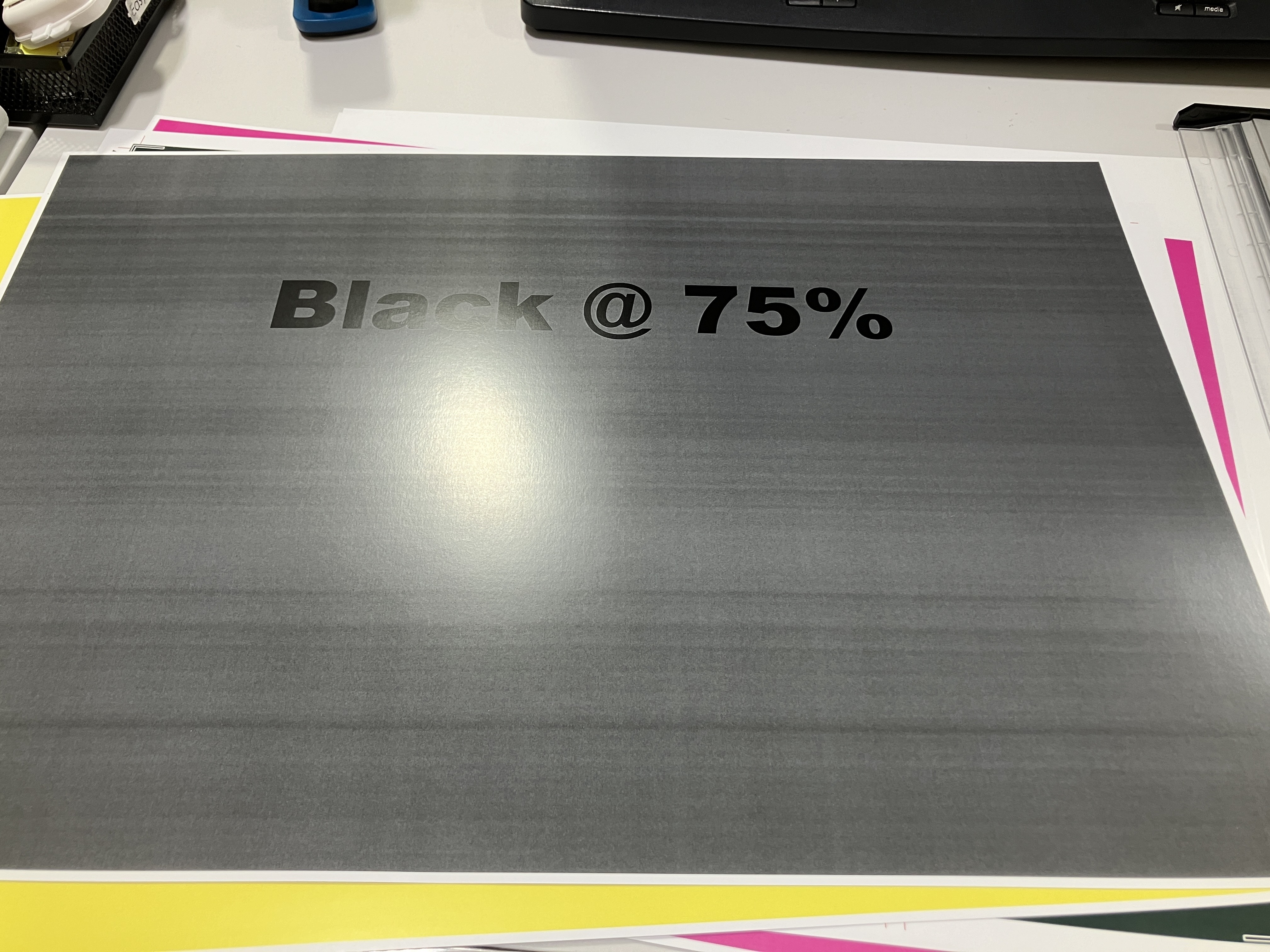

Our update - we were up for a month but now the v1000 has been down for cardstock production for the better part of 2 weeks. Anything that is "coated" can't be printed (looks like the attached image).
We can run lighter media (anything non-coated ) without a problem but if it's media says it's matte coated or gloss coated it comes out like this. Specifying cardstock as uncoated makes everything come out splotchy otherwise we would use that as a resolution.
They just can't seem to resolve this one. These are the kinds of issues that are frustrating with this machine.
When it's running it's great but once there's a problem, it takes a long time to resolve even with our techs doing their best to try to fix it. I've lost count of the number of things/parts they've replaced trying to resolve this problem.
I suspect all the bells and whistles (so many settings everywhere) they put in to “fix” problems end up conflicting with each other when the techs forget or don’t know that someone changed a setting instead of actually fixing a problem and then the next techs don’t know to go undo whatever the previous tech tried/did.

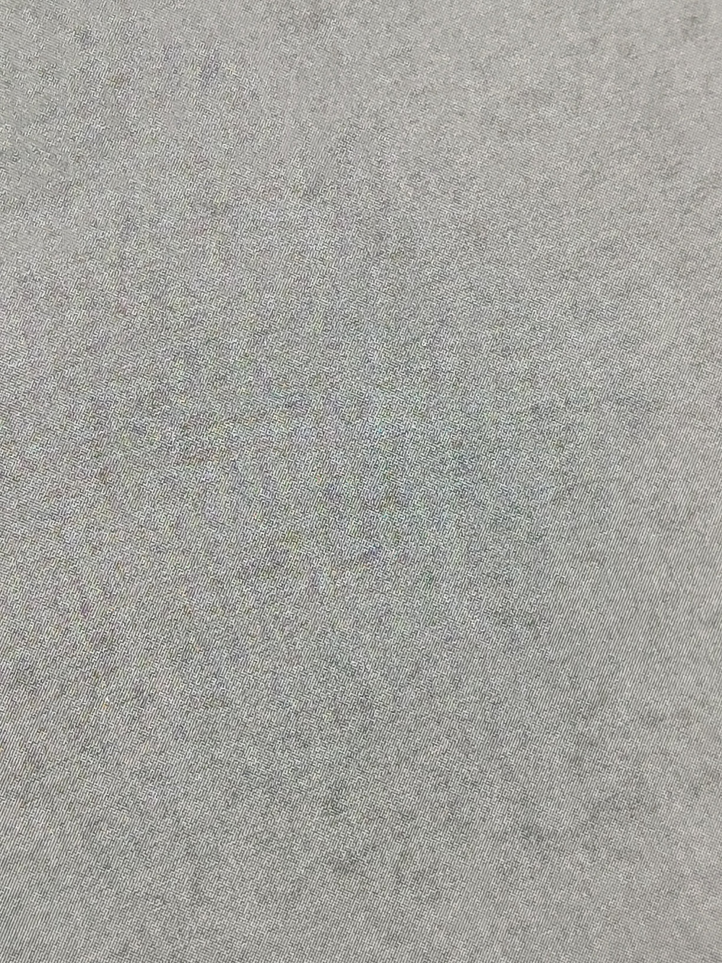

Hello, We bought a V1000 machine in the spring. After printing a few thousand pages, similar bands appeared along their length. The technician replaced the grid and the corona wire, but it started banding again. After that, he replaced the entire charging unit and it was fixed. But actually black is of much worse quality than the other colors. On the page, the black tone is nice and uniform in some places, and in some places it is very noisy and cloudy. About the fixing unit. Around 50,000 clicks, cracks appear on the fixing belt. The technician said too little oil was used in the factory under the fixing belt. Overall, it prints quite nicely.
