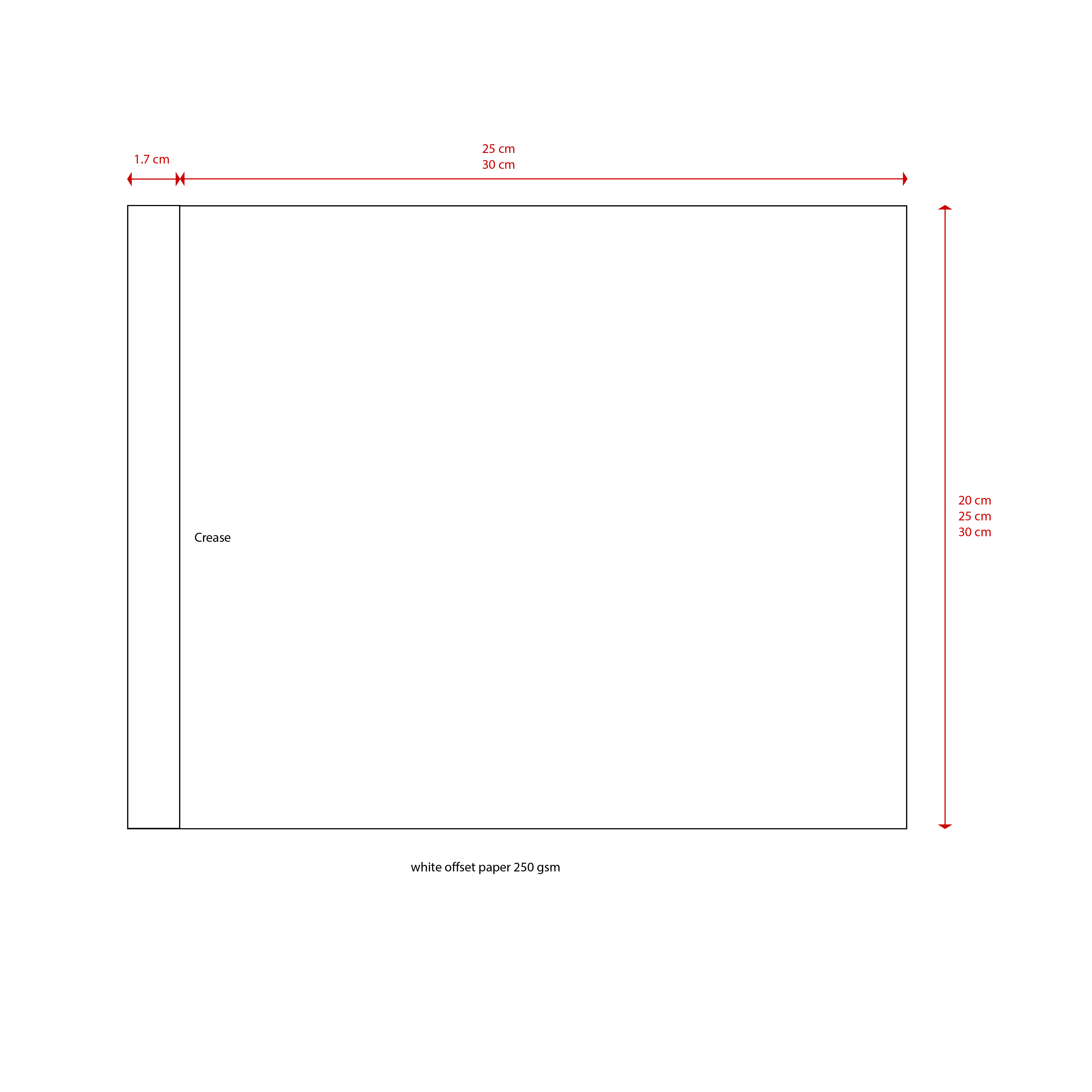

Hello,
We're looking to purchase an automatic creaser/folder that can crease and fold at 17mm (1/8 inches) from the edge of the paper. We use 300-350 gsm white offset paper. Does anyone know such a machine or has one? Thanks for your time.

How many sheets are you running? +1 on the CF375 as long as your quantity isn't too great. I've found the feeding and repeatability/registration to be really good.
I have an earlier model and the first crease can only be at approximately 1" or more from the leading edge of the sheet. For your application it could be creased at the trailing edge.
Hi @nightcrawlerx , I'm installing a Graphic Whizard 335 CKF creaser-folder next week and I'm more than happy to try out this configuration for you to see if it works. The unit is pretty reasonably priced, I appreciate that it's compact but not crushed-together-compact like some of the other units on the market.
