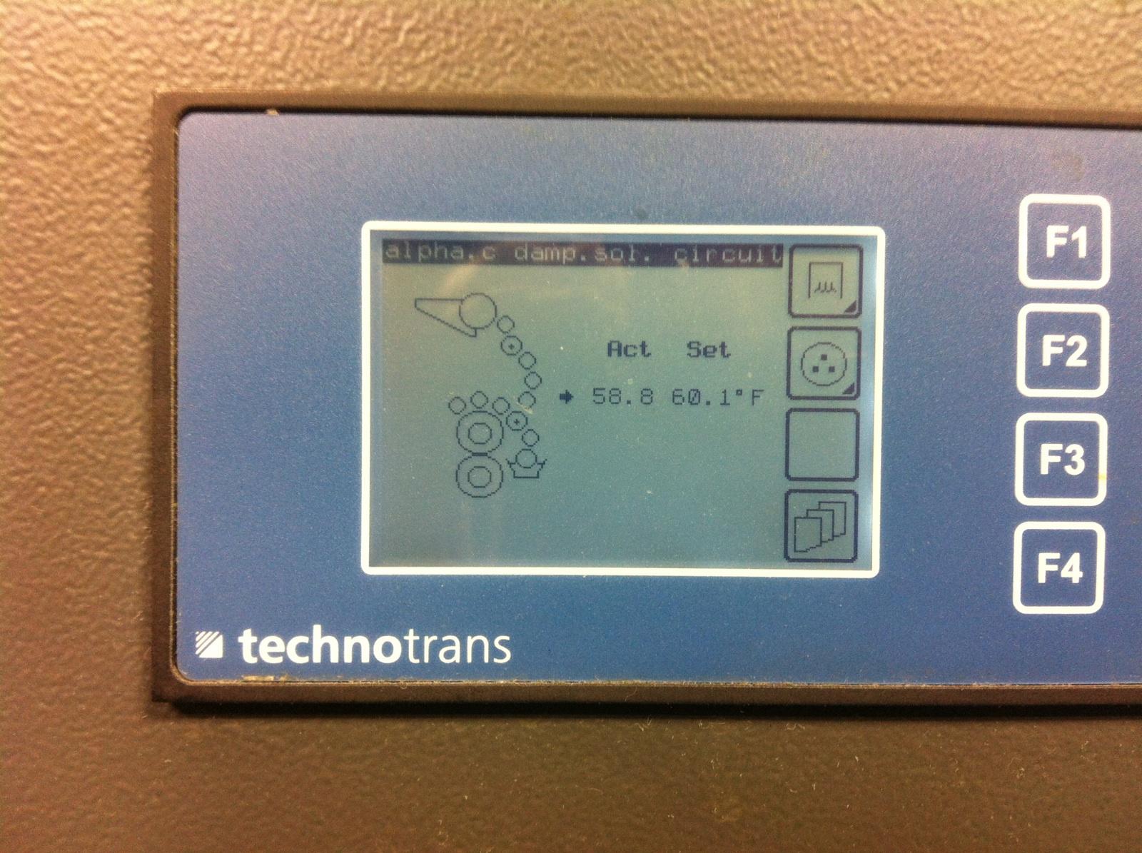

Another thing I've thought of that should be checked is the temp of your foutain solution water in the technotrans. My temp is set at 55 degrees. It should be cool to the touch. You can obtain this reading on the monitor and the display of the technotrans. I have had it happen to me that the trans quit chilling the water and it became very warm and caused major problems.
No Title

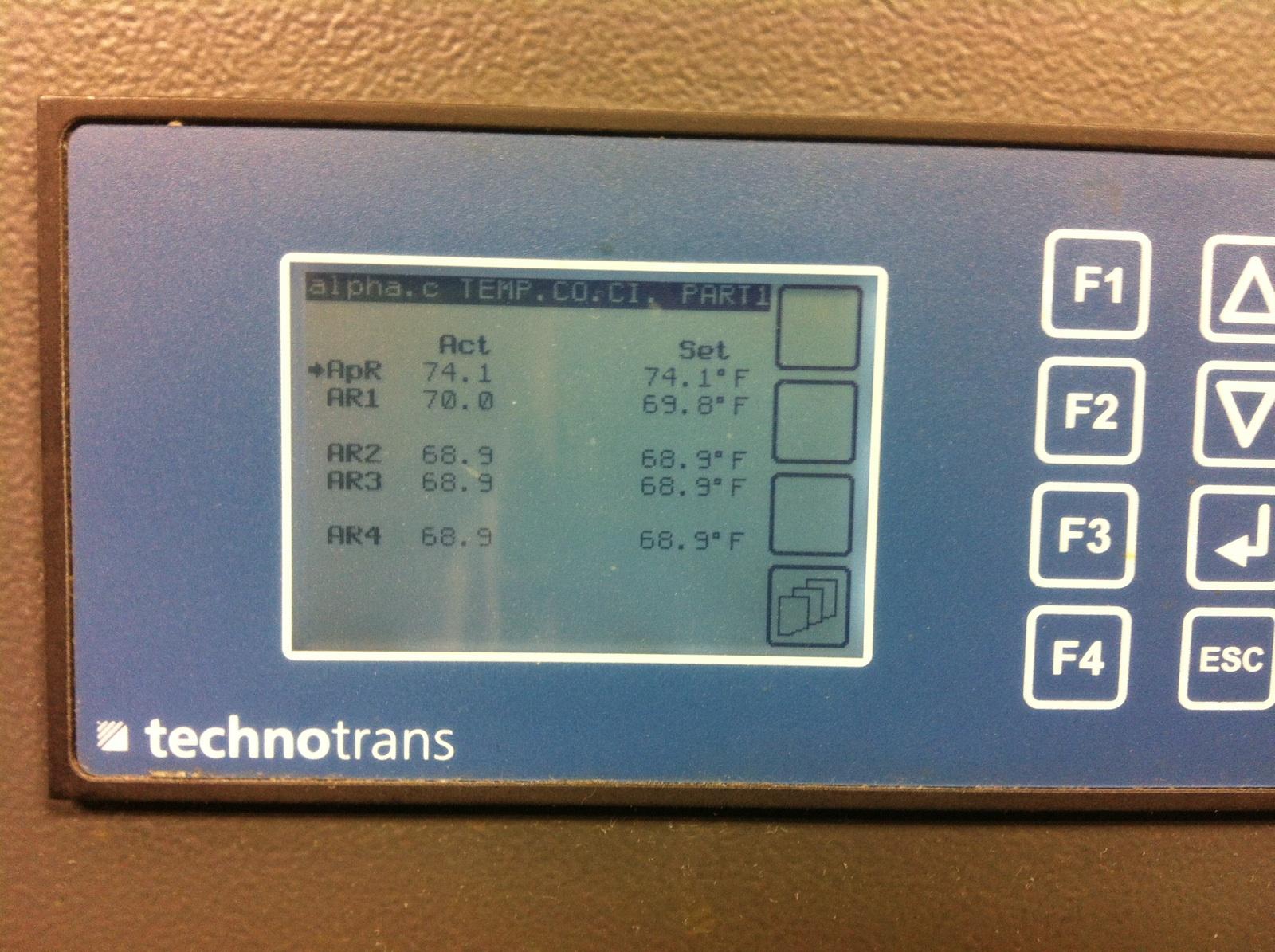

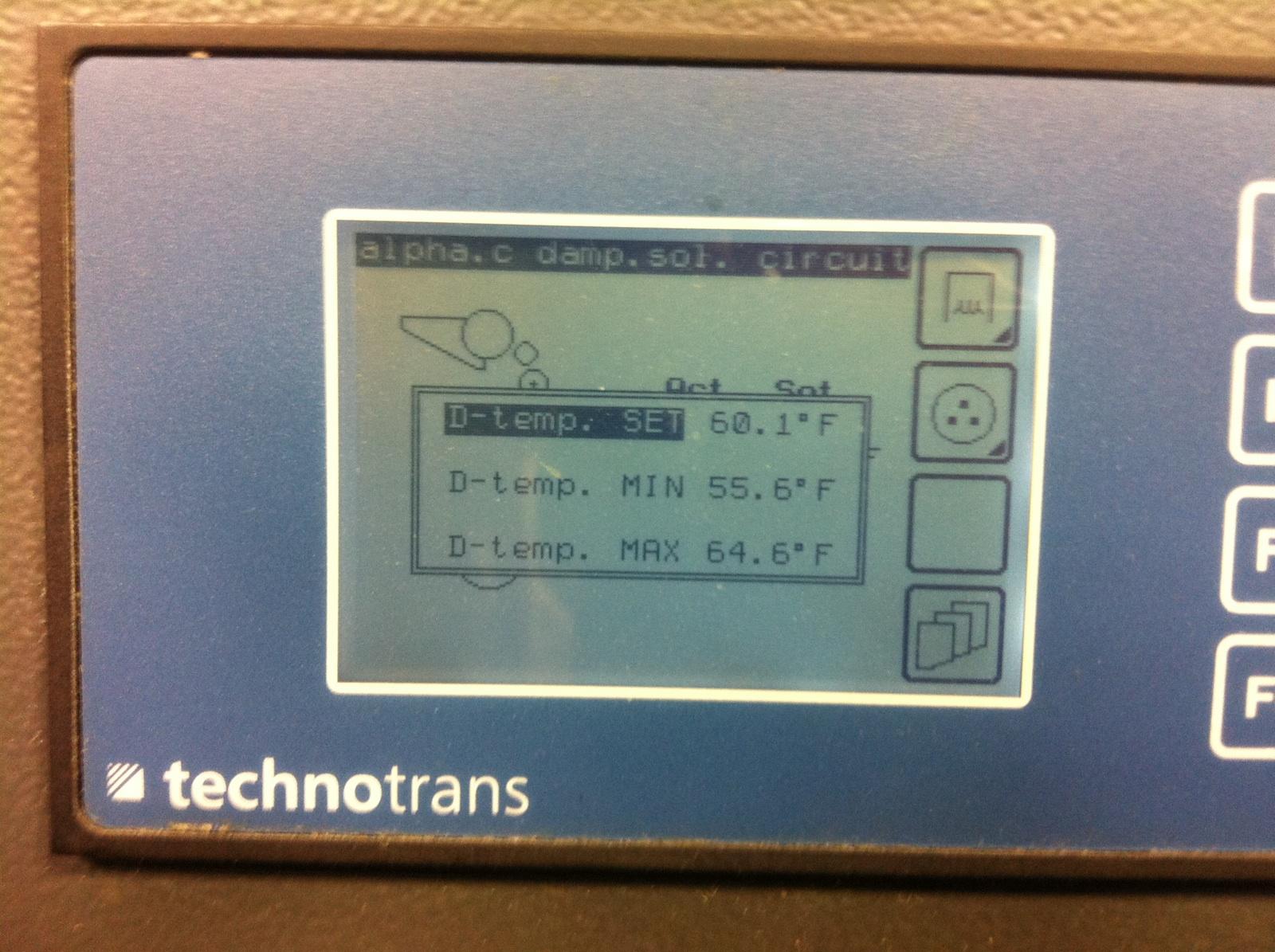

thanks for that the temp looks like it ts set at 60 look at the photos
The color is good with the extra cut back I have put in on the curves. We put in (-7 for the Blk,Mag,Cyan and -12 on the yell. we had the calibration curves set with a gray balance. I thought you told me that the chiller should be (55F) and it looks like we have it at (60.1)?
5 degrees at that point is not big deal. If you want they could adjust it to 55 but I doubt you will see a diff.
they will read up onhow to reset the temp and go from there. this is good 2 down and the press should run better.
