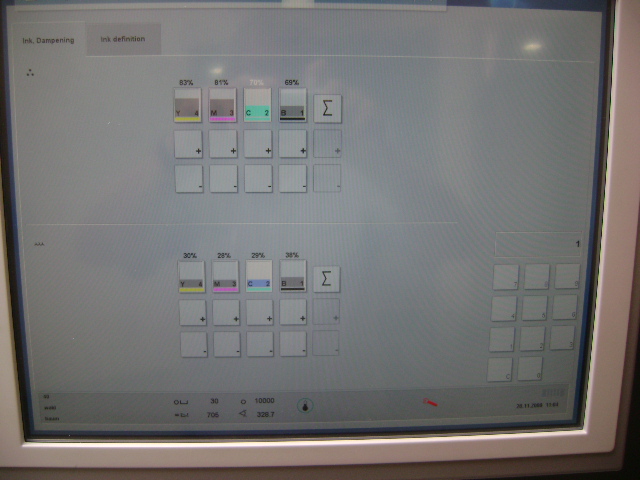

There is something that looks odd to me with these high dampening settings. They generally run in the 30 % range for dampening. I will enclose a photo of where the values they were running a press in the training centre in Germany. You should also be using ink that is formulated to run on the Anicolor.

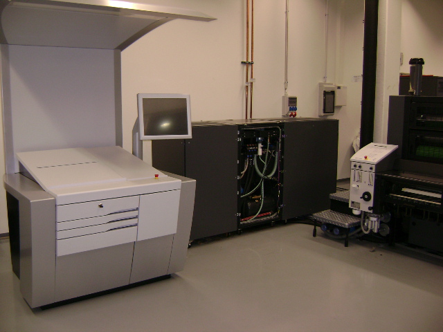

I picked some of these photos up off of the internet to show examples of what I think we should have as exhaust vents for the Anicolor. And what we do not have in our shop. I was told by the press operator that if we have the right size exhaust vents then we could get the water temperature down to your settings is this true?
I have looked at the pictures that you attached and I just want to explain what some of the vents that see are used for. The venting stack that you see in photo 1 and 2 near the delivery is used for exhausting heat, and coating fumes from the hot air used in the operation of the coating unit dryer. The third picture dose not have a stack hooked up.They may just be venting directly into the press room.
The other vents are positioned over the Technotrans units that chills or heats your Anicolor anilox rollers that are in the press. The dampening solution tank is also housed in the same unit. There is a lot of heat that is generated and the company has chosen to vent the heat created outside so as not to heat up the press room
In the training model in Germany you can see the unit standing alone and not vented outside. There was no need to do so in a classroom training situation.
Picture #5 looks like a heat exchanger and that panel should be closed. It does not work properly if the panel is open. With the panel closed, the air would be forced to go through the coils, which I am assuming are cooling this air.
That is the way it looks to me.

Thank you for this update. But from (day 1) of the install this is what the technicians put in the press operator can not take the dampening numbers down to your numbers (30%,29%,29%,%30. the chill unit will over heat and shot off. The press operator was not told it should be so low. and the more I read and see it looks like the install was not right. I can not fix my end until the press is set up right.
To my earlier question do you know of someone who has the spec sheet on the recommendations for the vents for the chiller. I think we should start with this.

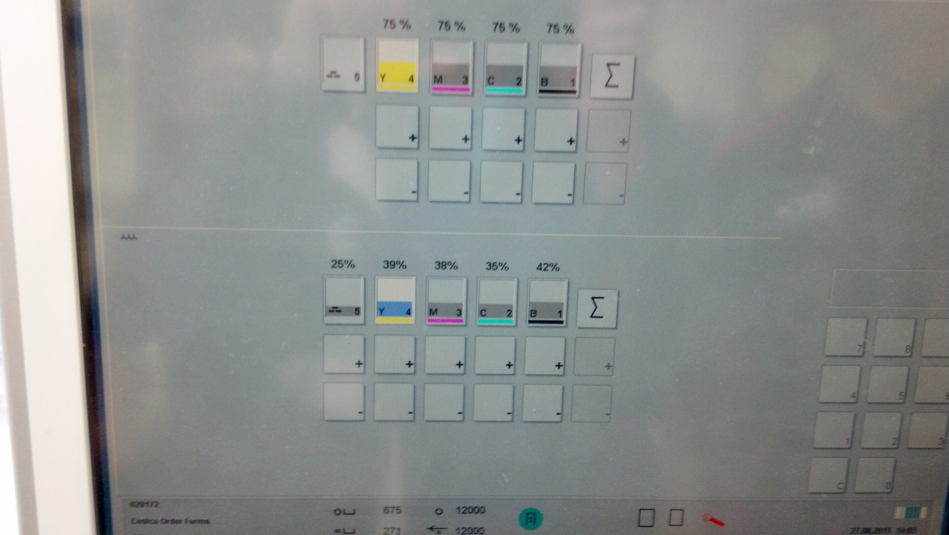

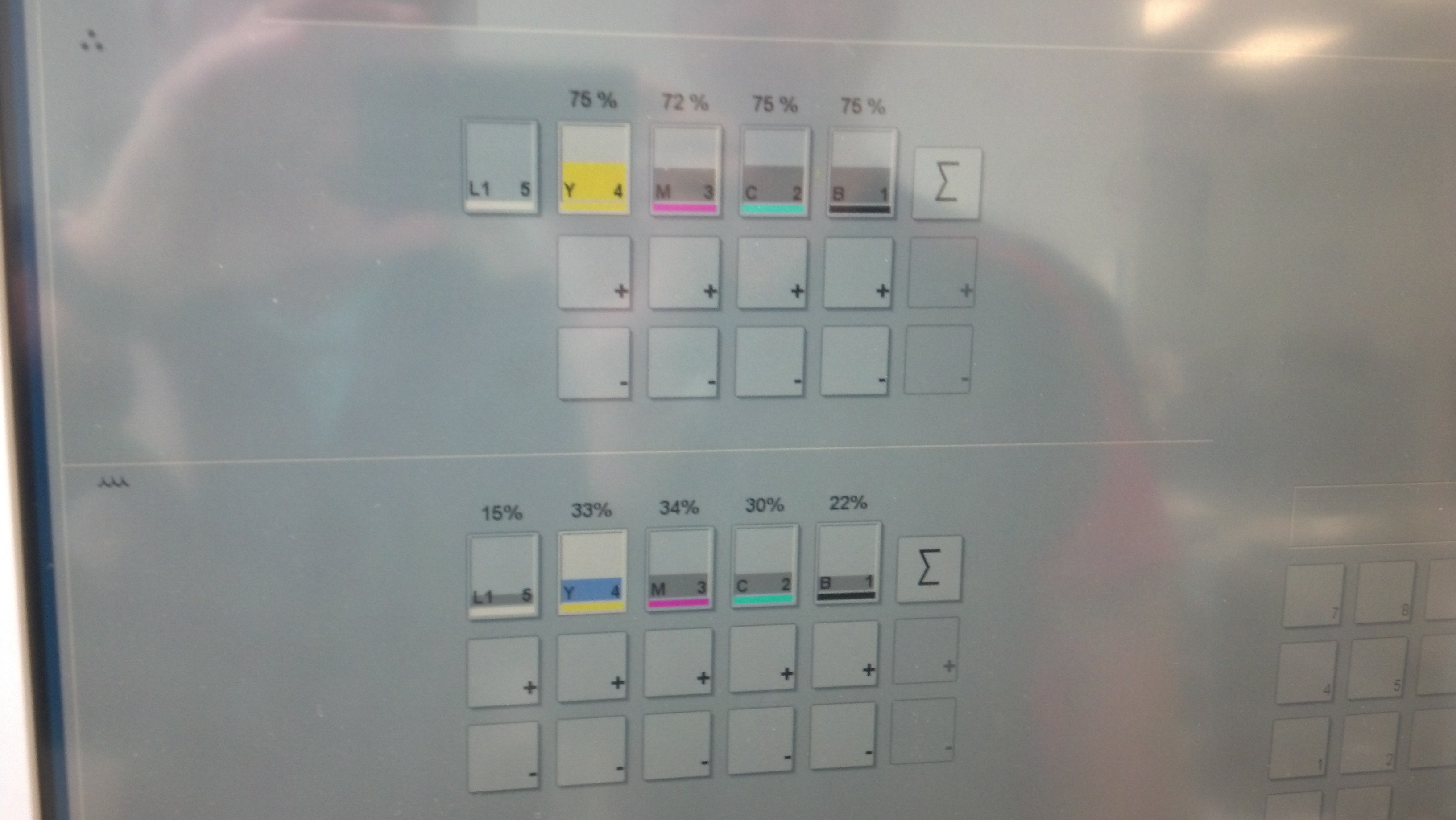

I did some research on 2 Anicolor machines that I have had previous history and in my opinion you are having a dampening issue with your press. Here are 2 pics off 2 presses taken today and the values at which they are running their ink and their dampening. Is there a Vario option (Hickey Eliminator) on the press and is it selected to be on. By having it on you can reduce the values downward and still print.

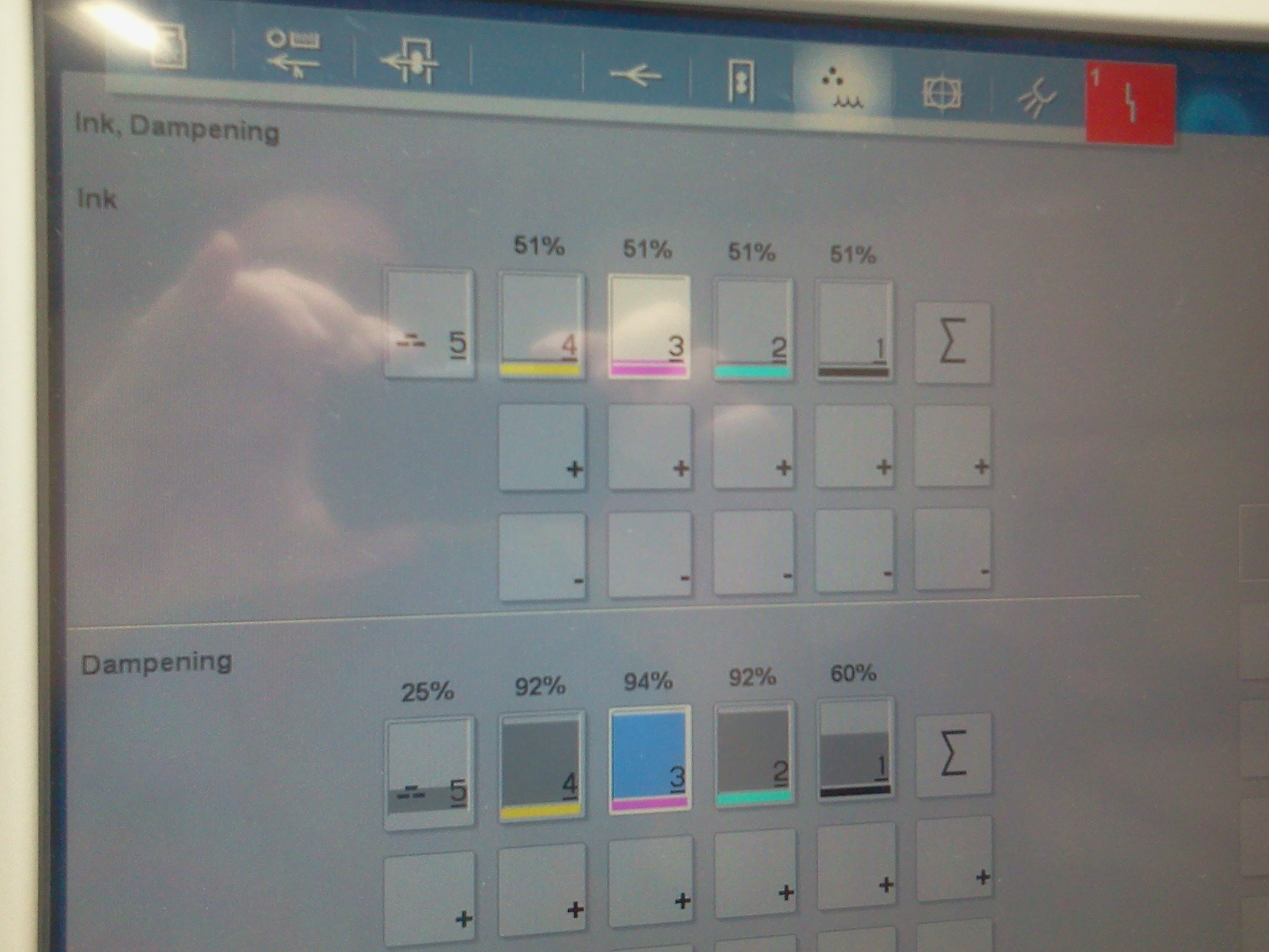

I have pass this information on to our pressmen. He told me that the settings can not change much or the press will dry up. Here is the photo of the setup they use. He did tell me that he does not use the (dampening with vsrio system) what does that do and should he used this? And no on the (saphira ink and saphira fountain solution) but in the beginning we were with all saphira ink and saphira fountain solution for at least 1 year and this is how the technicians from Heidelberg set the press up in the beginning. The pressmen has tried to make these changes and the press will dry up.

As u know, anicolor press has no ink keys, u rise up densities when rising the temperature of the screen roller, when there's too much dampening solution, the excess water will go up on the screen roller and in the ink chamber, the ink will become more liquid, therefore no stability, streak will appear, not roller streak, different kind, sometimes the pressman won't be able to reach the desire density, it's not normal to have temperature at 95% as i've seen in the attachement, 80% to 95% by experience is only for solid printing on an anicolor, the iso 12647-2 can be reach with less temperature with a 10 micron roller
