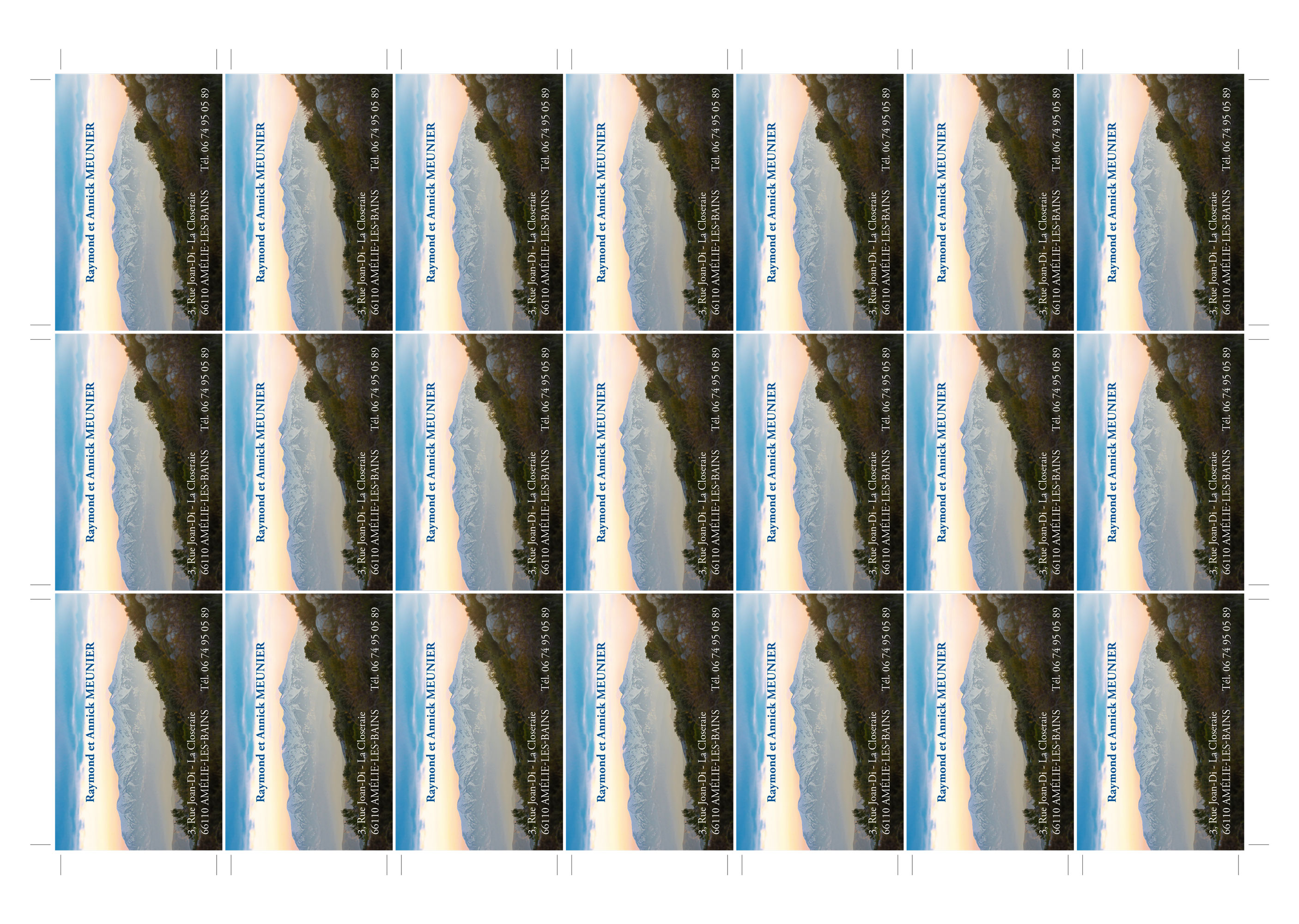

i have the same machine and never had success getting 24 out. I tried all kinds of things and gave up.i have the Duplo 616 and want to know layout for business cards WITH BLEEDS.
How many up on a sheet can i get? i was told 12 x 18 sheet can get 24 out? but does this mean with bleeds?
Honestly, there's really no downside to doing 21 up from my perspective.i have the same machine and never had success getting 24 out. I tried all kinds of things and gave up.
I just do 21up
