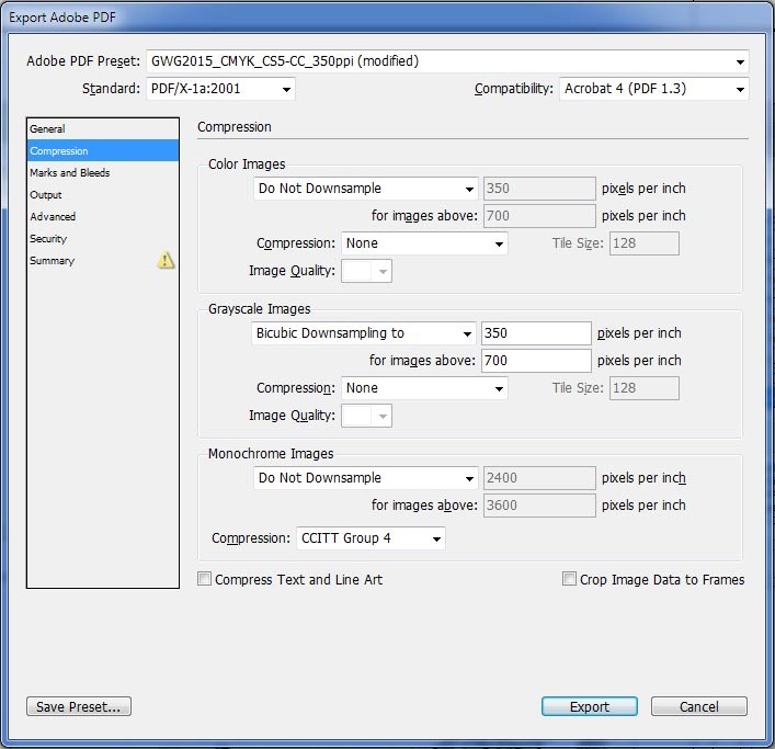

Found the cause of the 2 GB file - my own export checklist had compression to be manually set to none. That said, the GWG seems still seems pretty large for a 32pp book. The initial (tampered with) GWG settings:

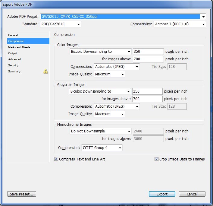

The newly exported PDF with GWG2015_CMYK_CS5-CC_350ppi:
The newly exported one came out at 144 MB which to me still seems enormous for a 32pp illustrated book but I don't know what would be usually expected for that sort of print project.
In Photoshop I'm using 600ppi based on commentary that 300ppi is too low to take advantage of FM screening for single-color greyscale art.
Both the 600ppi greyscale 8-bit images and 2400dpi bitmaps 1-bit are saved with .tiff extension and LZW compression:

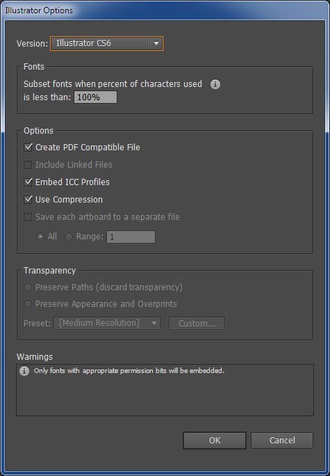

That's a bit more reasonable considering the image resolutions you are working with.
i can't comment on the resolution needed for FM, that might provoke discussion, but what you have now should produce a nice job.
I wouldn't worry about the size. Trust me, your printer has seen a lot worse!!

That seems much more reasonable for a 32pp document. I wouldn't think twice about a file being that size if I received it. I'd actually be glad to see that it wasn't too small, which would concern me that the quality would be bad. Illustrator can produce really large output files because of all of the points, gradients, and transparency effects that people use these days. Nothing wrong with it...just the way it is.
Disk space is cheap these days as is high speed internet. We do not use JPEG compression even at the max quality setting as we have seen image degradation at that setting. We use ZIP compression only! A bit larger PDF file size but zip compression is lossless while JPEG compression is lossy even at the max quality setting.

In Adobe applications such as InDesign and Illustrator, you should use the “Automatic (JPEG)” at “Maximum Quality” for images. Why? The “automatic” aspect of this is that we examine each image as we produce and export the PDF file. If the image is “vector-like” we compress with lossless ZIP compression, avoiding those nasty JPEG imaging artifacts and lossiness. If the image is photographic (i.e., something that would typically come out of camera), we apply JPEG compression at the special quality setting. For the vast majority of printing applications, this works out without any perceptible quality loss. (BTW, unless your image workflow uses RAW images followed by use of TIFF or PSD subsequently as opposed to out-of-camera JPEG, you have already suffered through a round of image lossiness!)
- Dov

An other reason for unnecessary growing of a PDF-file coud be: Depending from the Export Settings sometimes much to much icc-profiles (each about 1-2 MB) were added to objects. For an example PDF/x-3 add (often) the same CMYK-profile to former not calibrated pictures and text aditional to the Output intent… ;-)
Ulrich
Thanks Ulrich,
But, if Illustrator saves history inside the pdf and that info is not available to us, then such behavior is clearly counter-productive.
Beyond that, why would Acrobat strip any info "silently" when a file is simply saved AS IS?
BTW, I believe Acrobat doesn't strip the native Illustrators' file structure, that we actually want to keep.
I wonder if Acrobat is actually re-structuring the Illustrators' pdf internal file structure and optimizing it?
Perhaps Dov can shed some light here...
