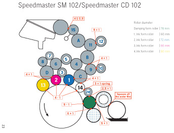

I got a diagram of Heidelberg ink roller setting. The ink strip of the roller #13, 2, 1, 14 should all at 4mm.
However, I found that there is an other diagram which stick on the frame of press showing the ink strip of these four ink roller is 2, 3, 4, 4. mm (for ink roller #13, 2, 1 & 14).
Which one should correct or both setting are correct but for same model of Heidelberg CD102 manufactured in different year?
