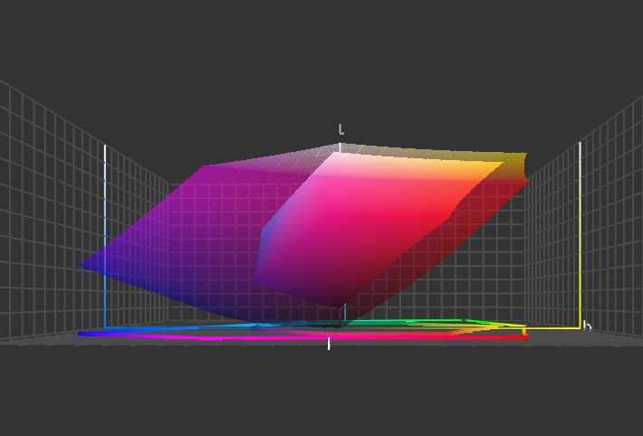

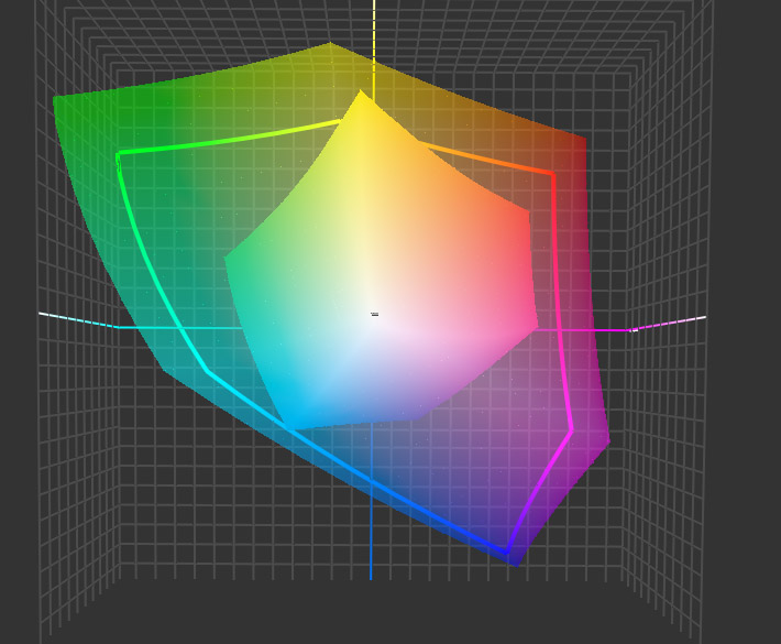

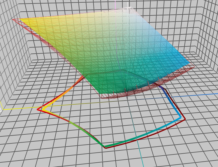

Many thanks for making the profiles comparisons for me. I know there's a huge loss going down to CMYK.
The comparison I'm looking for is comparing the US SWOP Web-Coated v2 they recommended with something like an Indigo 5000 profile (assuming it's reasonably decent), so I can compare how things might shift if I'm using SWOP v2, i.e., how far off might I be by using it.
