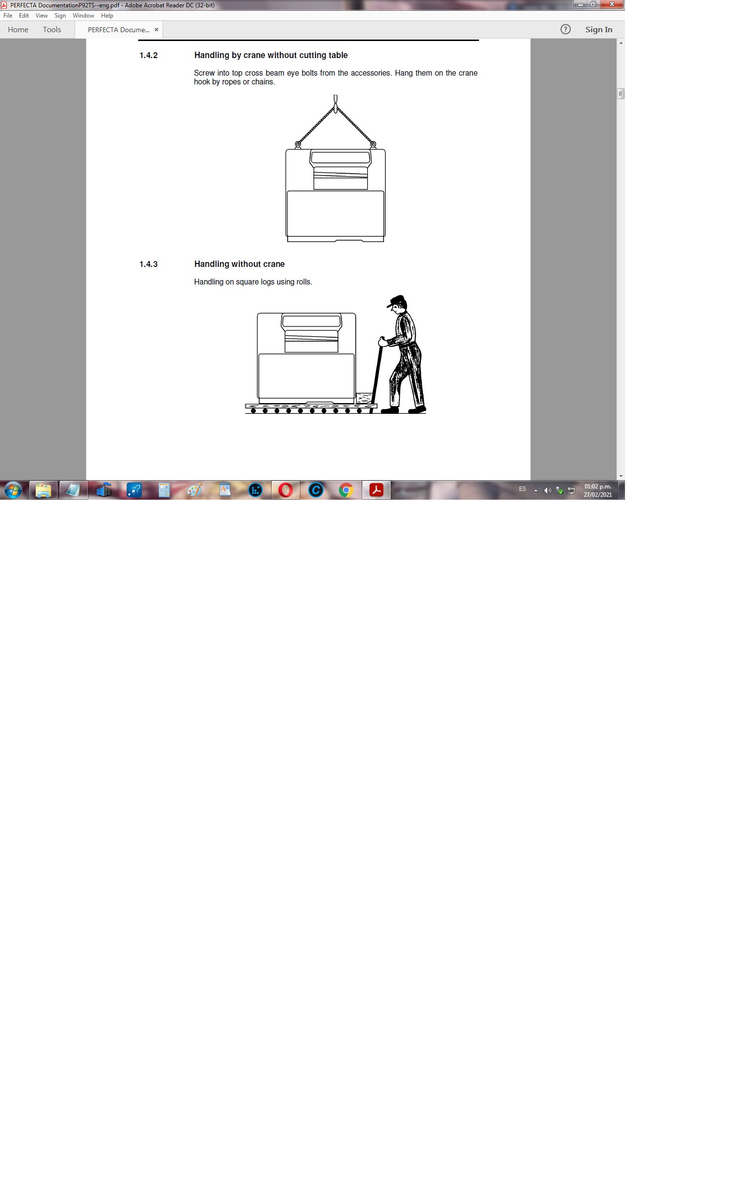

Hi attached is there 2 ways to handle the paper cutter
However using a Forklift, with woord, some other Companies using, Not problem

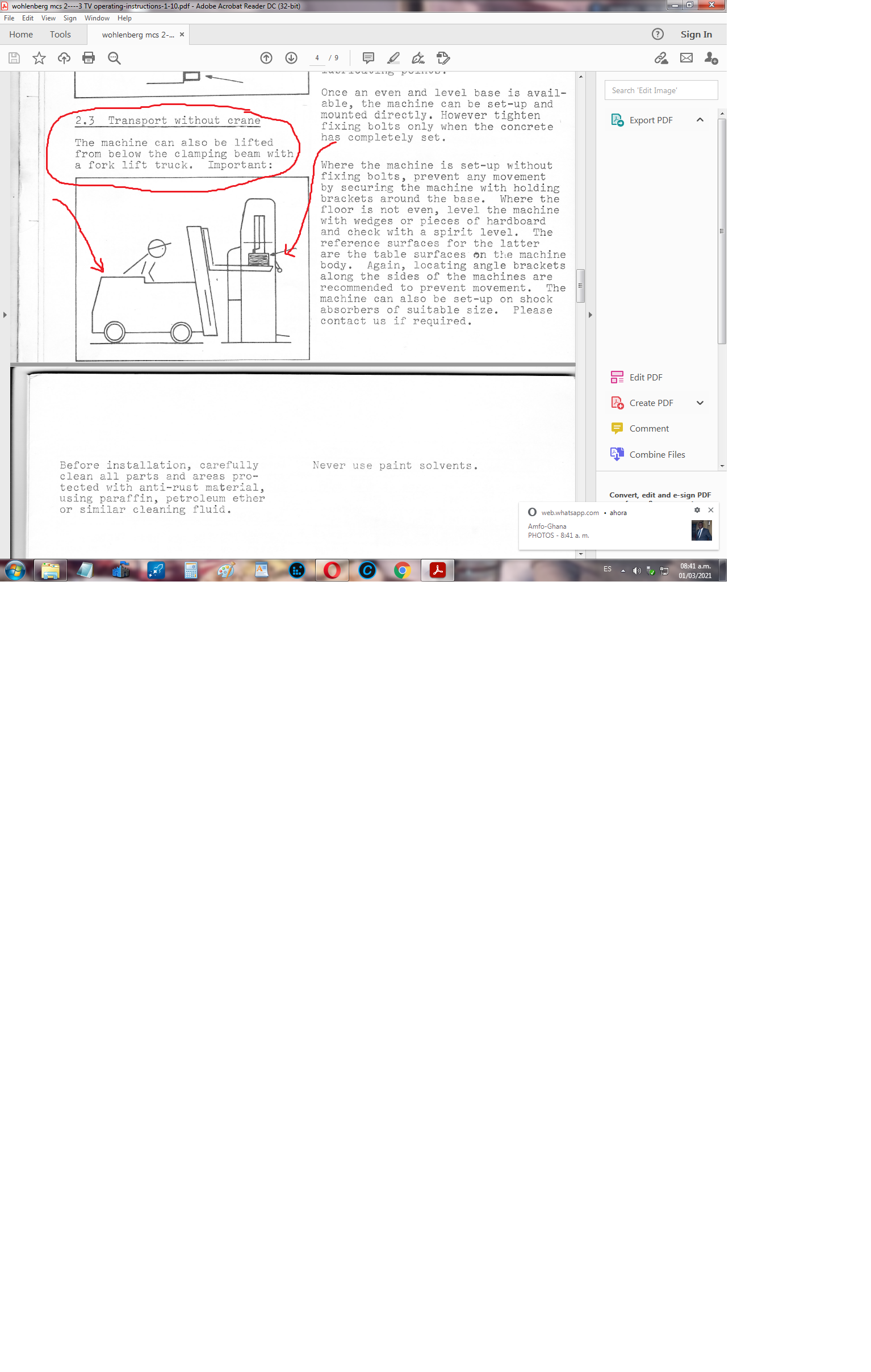

Hi :
Attached is there another method , used for some factory.
