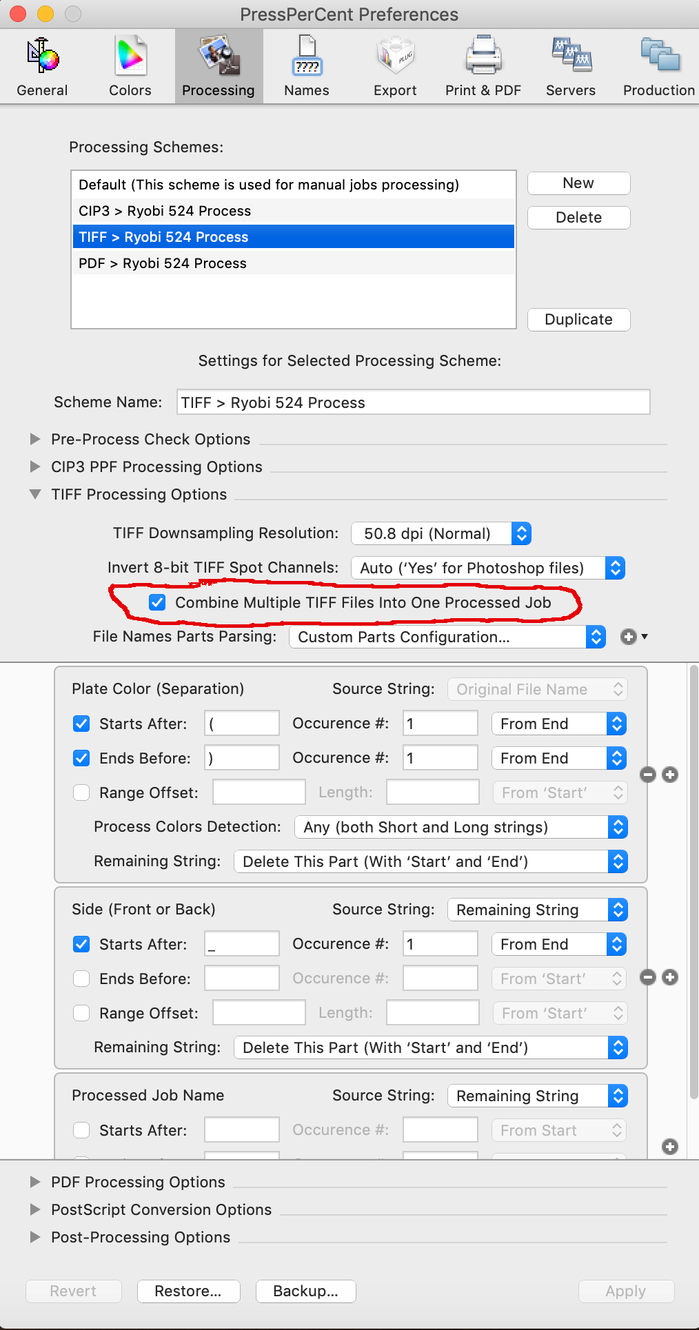

However, PressPerCent can also work with Harlequin 1bit TIFF separations, combine them (see attached screenshot) and output them correctly via the CIP3 PPF.plugin.

you wrote that you got a Harlequin RIP. All you need is the TIFF-plugin of the Harlequin RIP for producing 1bit TIFF separated files (CMYK & Spot). Then you load these seperations into PressPerCent using the setup I sent you. PPP will merge these separations together again and do the CIP3 generation.

as input file for the Harlequin RIP it is better to use composite PDF or PS-files and not seperations. The important part is that you sent TIFF seperations to PPP which can be merged. Then all spot colors are processed correctly for the CIP3 generation.

1. Separated PS-files which are not produced by the HQ-RIP like your printing plates are , could cause problems in the correctness of the CIP3-files produced by PPP.
2. PPP is only working on a Mac, I know it. You don't have have to use 1bit Tiffs in full plate resolution of 2400dpi or so, a resolution of 100dpi or 300dpi is by far enough for CIP3.

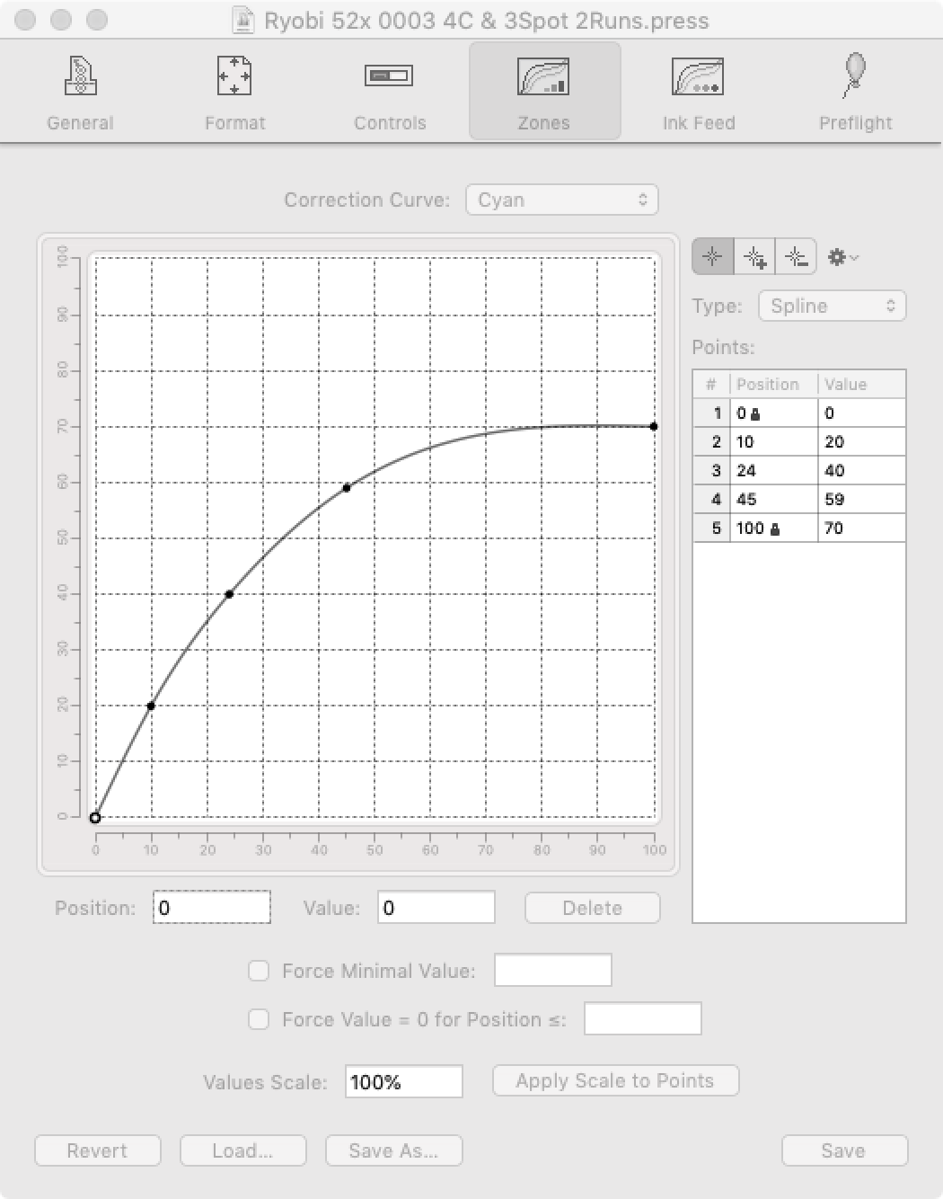

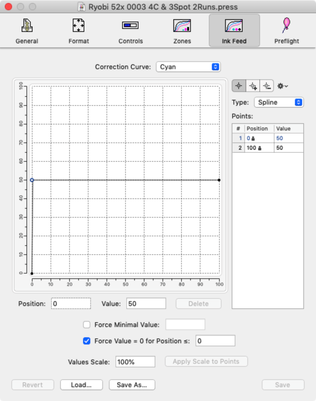

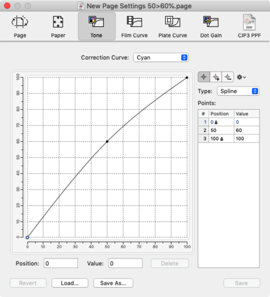

I asked about the differences, because I have CP2000 in version 38, where it is not possible to create characteristic curves. There are only defaults 4 curves for each CMYK color and 3 spot. I can only edit them. So I have only one curve for different papers and inks. I'm wondering how I can pre-set the right ink keys in PPC.
Martin Mueller
Hi Jacek,
in PressPerCent there are several setup parameters to adjust the ink zone information to your specific press. The basic settings of PPC are often "too weak" and only open the ink keys very insufficiently. In the attached screenshots you can see the menu windows for "Zones Curves", "Ink Feed" and "Page Correction"to improve ink key settings for Cyan. Here, for example, I can enter a "steeper" curve for the Cyan print unit. PPC also offers a accurate test form printing procedure that is described in the PPC User Manual (Appendix B, Pag. 28 - 30).
