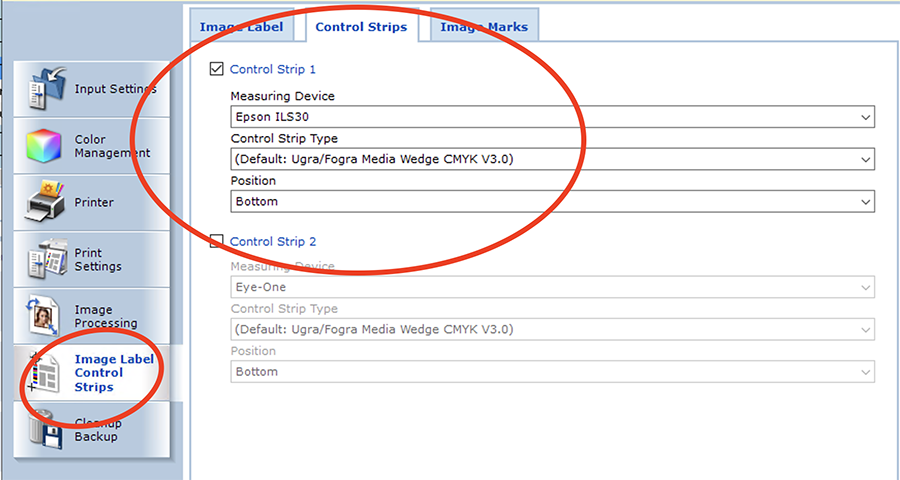

I'm also a long time GMG ColorProof user and administrator. Adding a media wedge is two clicks away in the workflow settings. And a media wedge can be added for any proofing condition.
so YOU CAN also include a media wedge that is tied to a custom profile
As long as that custom profile has it's own mx-profile in GMG the answer is YES. But maybe they are doing some shortcut that I'm not aware of and therefore cannot include a media wedge??
Kindly, is there a user guide online where it states what you are saying, so I could show them?
See the screenshot from my previous answer.
Edit Workflow properties (for the specific flow) > Image Label Control Strips > Control Strips > Select the wanted strip
