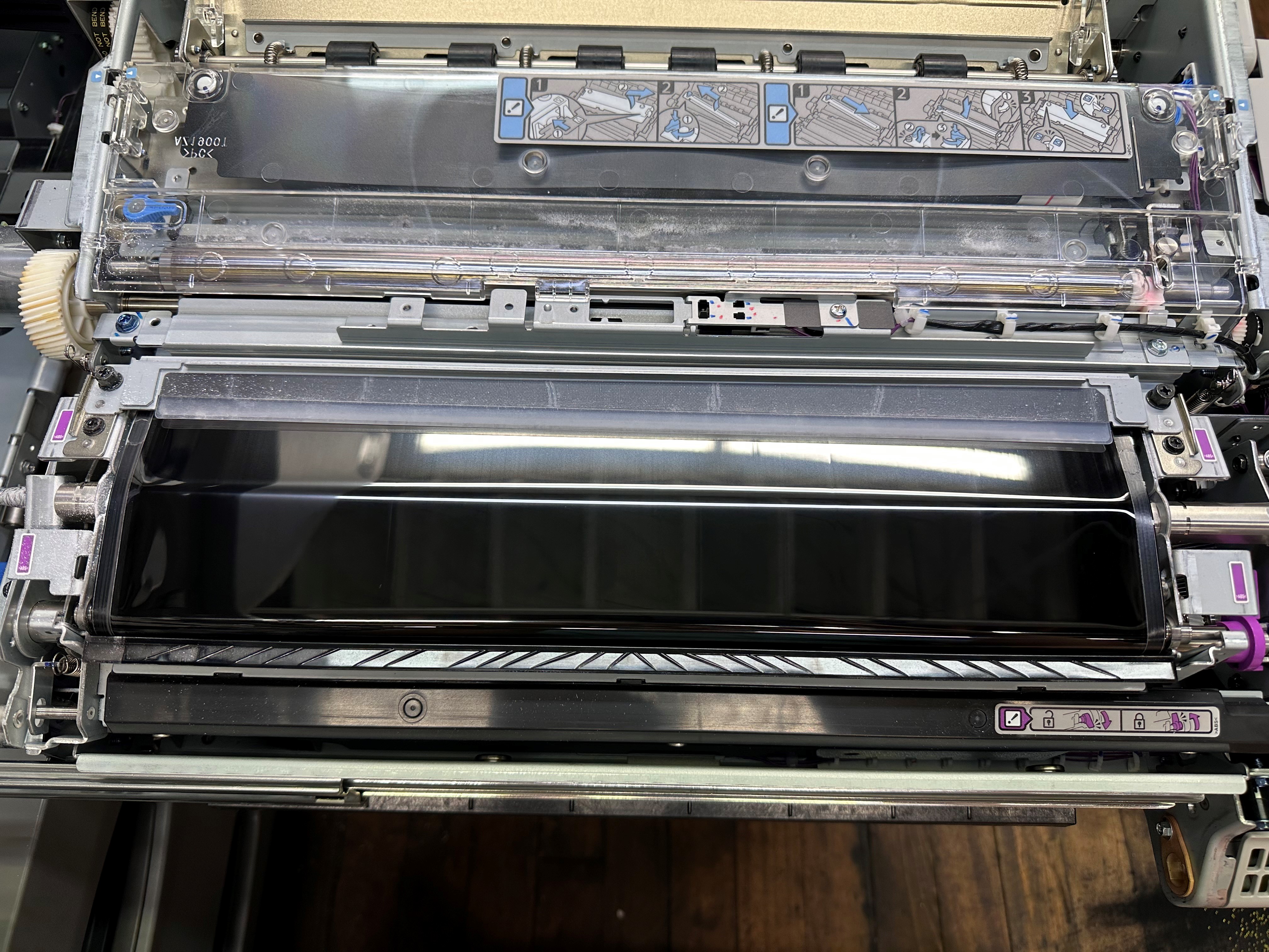

The marks from different size paper are usually on the fuser roller, but yes you have to replace this belt, but it seems much more resistant to damage than the old roller. This is just like a smaller version of the belt that transfers the toner. They went to a fair amount of trouble moving the drive assembly for it to the operator's side. I am optimistic. Still runs envelopes just like the old version with the refolding of the flap. Registration is every bit as good and it seems to run envelopes faster through the bypass tray. I have been told it also is faster with mixed media, but haven't tested it out yet.

Is the belt part of the TCRU program, is it something you can change?
Ahh, thanks for the pic, I was thinking it was the same belt that is in the fuser but that looks more like the transfer belt.
