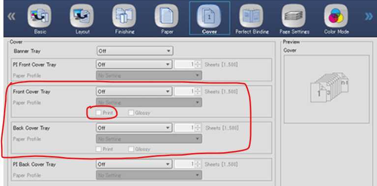

  1. You can use the Front Cover or Back Cover option in the print settings and assign the paper to come from any tray. Leave the "Print" box unchecked:

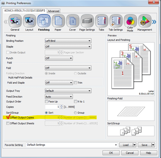

  2. The method we mostly use for slip sheets is the following:
    1. Press the Utility button on the machine panel
    2. Press "Common Settings"
    3. Press "Next" 2 or 3 times until you get to the screen that displays the "Offset Output Mode" option
    4. Here you can select "Change Position & Insert Partition Paper" or just "Insert Partition Paper". The change position means it will offset the sets.
    5. You can specify the partition paper to come from any tray, not just PI trays.
    6. Be aware this is a machine-wide setting that will effect all jobs that have the "Offset" option selected in the print options within the "Finishing" section. You'll need to turn it off by repeating the above steps.

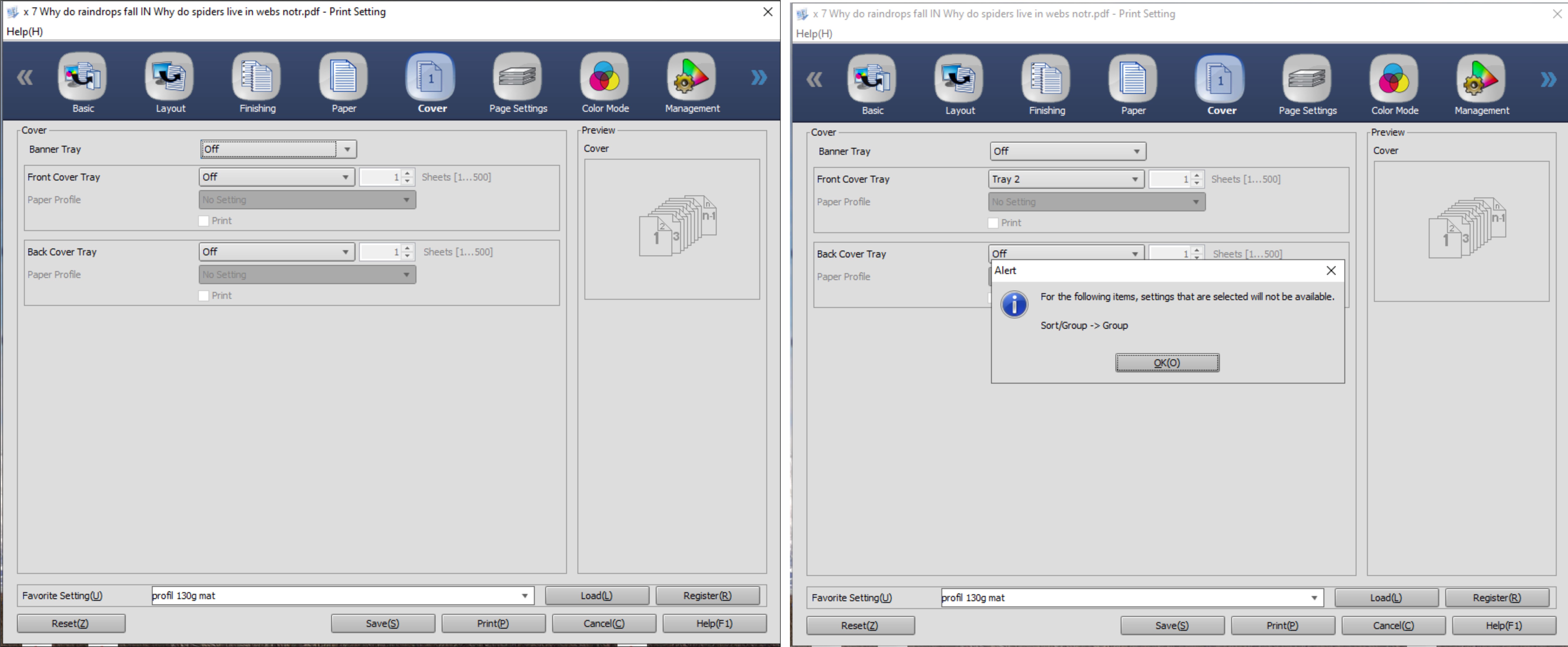

Thank you for your answer but it seems I dont have so much boxes to check in my command print driver. (KM C6085, IC 604)
as you can see in my attachment, I cant insert a cover because it automatically changes my finishing output mode to SORT...

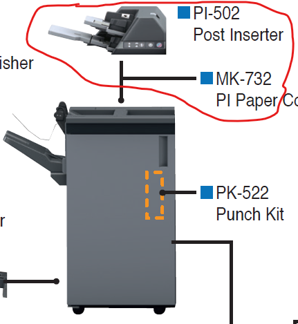

If this is a project you do often, I would highly recommend adding the PI-502 post inserter trays to the top of your FS-532. It's relatively low cost and doesn't add any length to the machine. The only other options are adding the FD-503, another 3-drawer paper deck, or bypass tray - all of which add length and cost quite a bit of $$.
