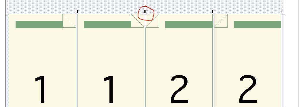

I recently started using preps at my company's small print shop, and I ran into a problem that I can't solve. When I make a work and turn imposition, preps wants to add crop marks that lie on the trim line. I ran through most of the training guide but could not find any instance of this in the guide.
Any idea's on how to fix this? I attached a photo that shows the problem area.

Yes it is very annoying that the "Smart" crop mark can't figure out the gutter or lack of one in a work and turn. The only work around is to apply crops to the individual pages where you have control over the individual marks. Go under the Template Menu/Modify Template Page/Add Crop Marks. It's a bit more time consuming but it gets the job done and if the marks are the same for multiple pages you can just shift click to grab more than one page at a time.
Hope this helps.
Jackie
Hold down the Option key, and select the mark you wish to delete. Very fast, this way you dont have to use Static Marks. If you dont hold down the option key, it will delete the whole set of crop marks. Holding down the option key will allow you to select only the marks that you wish to delete.
-Sev

Another way to do a work & turn in Preps is not use the work & turn style. Just make it a one-sided two page layout. Then you can click on the center gutter and put in your gutter amount.

Sure it will back it self up. You still making a work & turn, but telling it to be single-sided in Preps. Then you proof just like a normal work & turn. But now you have more control over the individual pages. I use both methods often, depending on the job, and how I want the finished template to work.
