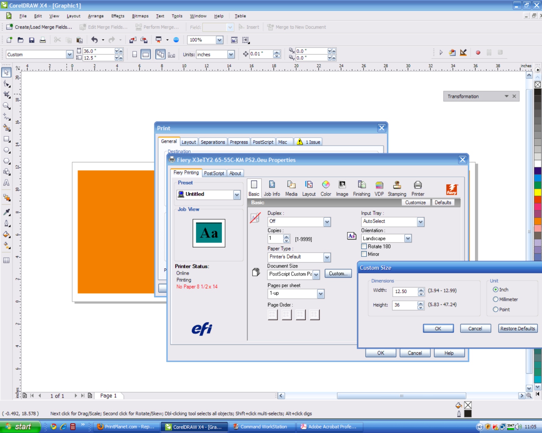

Hello FHSWood,
We are use EFI Print controller, From CorelDraw (or any Software) we print the Job to Print controller ( Postscrip Custom Page Size) i am attaching the screen shot.
