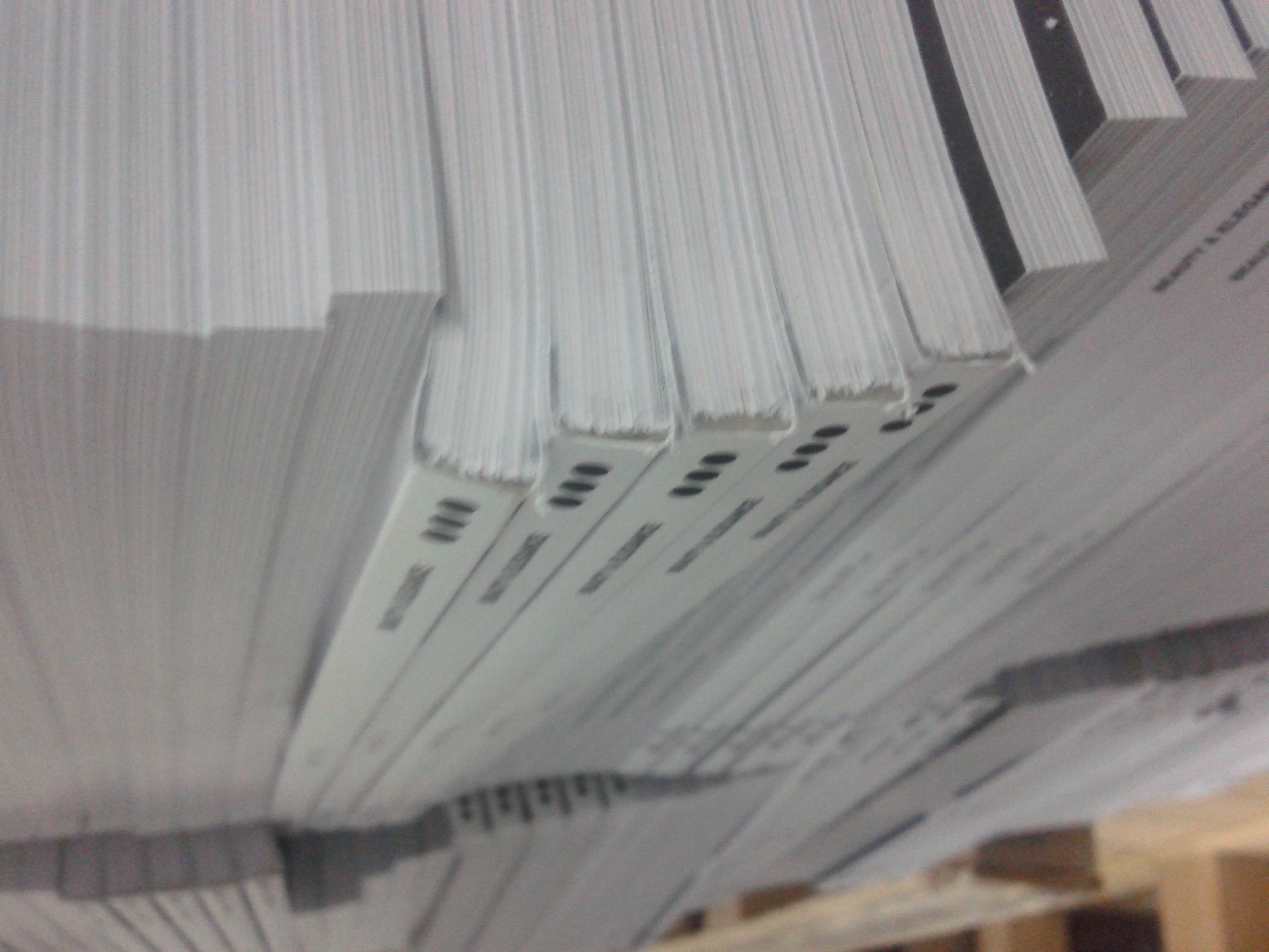

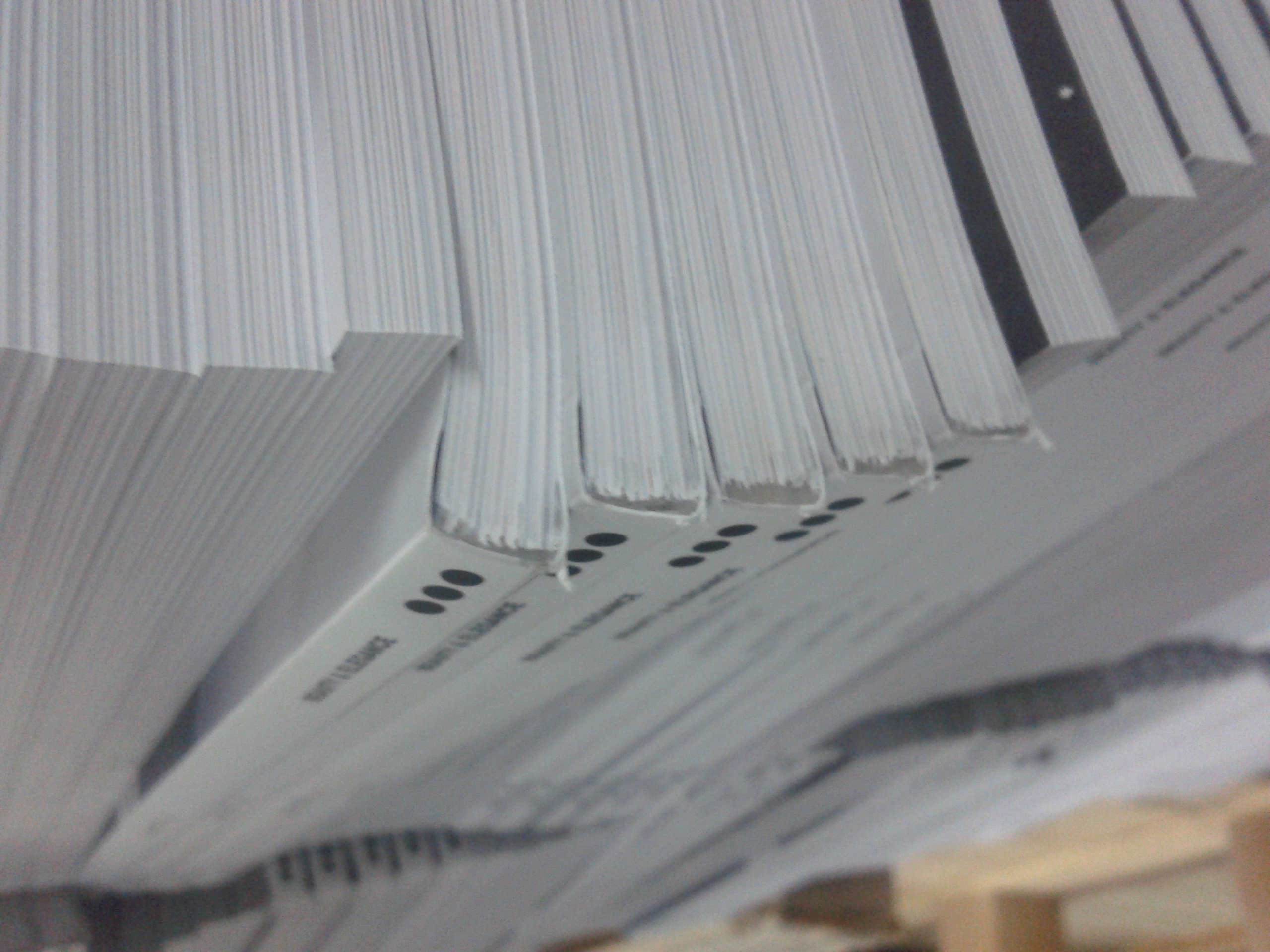

we are having a problem on our three knife trimmers (we have two, one is modern, the other is old). we are getting chipped edges. we tried installing new knives, it didn't help, we tried different settings, we even tried different films of side and spine glues... but still can't find the issue, can someone give a hint what it could be? I have attached images that show the problem.

Have you not always had this problem? Maybe the glue brand has to do with it. Anyway, the glue film looks heavy to me, but I am no expert.
Al
we tried different glues... the side isn't an issue as it doesn't get to the edges... just the spine. we also tried less glue, didn't solve it.
At the previous company I worked at, we encountered the same issue. Sorry, but we were never able to resolve it. Obviously the more the nailhead, the worse it would be. Making the book block on the bottom of the clamp the exact same size, gave us the best results.

Thanks for the tips guys... still struggling with this issue. Today we noticed that we only get this issue when we are cutting more than one book. If we cut one at a time, it doesn't show. On a side note, to improve our cutting, I designed special wooden clamping areas for each book size I cut, so I don't think this is an issue for me, but i have to add that the felt grey board we are using is made of layers of thick cardboard that we are gluing together, it's not one piece. Does this have an effect on the cutting?
The clamping area has to be as close as possible to the knife. The distance from the clamp to the knife in a normal paper cutter is 0.3mm (12/1000”) up to 0.5mm (20/1000”). The wood should not touch the knife, but the grey board or felt is not a problem.
The height compensation is really important. If you have just one book, you don’t so much compensation. This sounds logic. I know normal cutters well and where is the differents?
