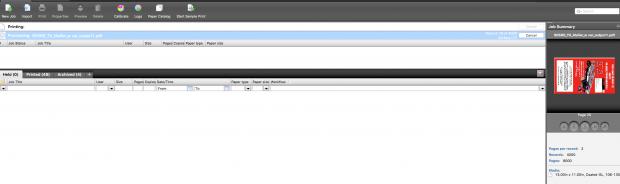

Thanks for the suggestion - I did some experimenting. I did try one on a 8000 record document writing a PDF/VT. By my stopwatch (wish EFI put a TIME REMAINING on it's interface) it would take a little over 2 hours to RIP. That's a long time. Now the interesting thing is, my document had 8000 pages. The RIP saw it as 4000 pages and gave me a "surface" indication. One side of this project is common with the variable on one side only. My "regular" PDF shows up as 8000 pages. I'll attach screen capture
Maybe this is normal and I should expect no better?
Well, screen capture was useless so disregard. In the time span it too to write my results here, the RIP slowed down dramatically. I would say this 8000 page document would be in the 5 hour + rip time at this point.
