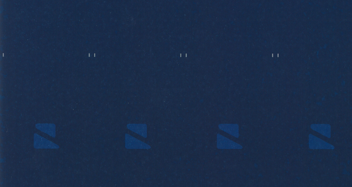

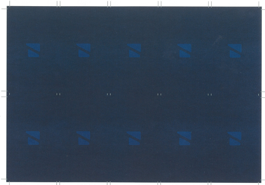

This is how it looks on ours. Not the absolute worst but you can see the modelling
pippip
Sorry very hard to make out on that, can you describe your issue better. Is it just an uneven cyan?
