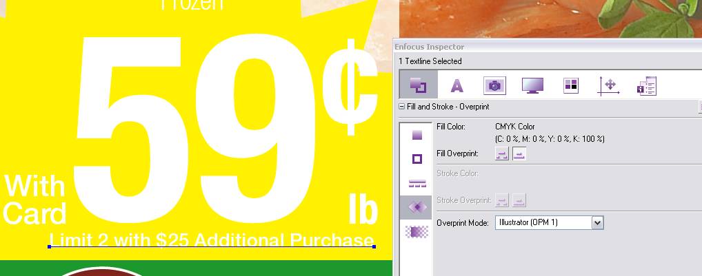

We are having an issue with the overprint preview in Windows not correctly displaying when the color of "black" type is 0C 0M 0Y 100K. Attached is a screenshot of the effect with the black channel turned off. The color warnings "overprint" also indicates that the type is indeed overprinting.

Here's a section of the PDF showing the same section as the screencap. I'm interested if this is a Windows/PC Acrobat issue or PitStop issue or some combination thereof. We use WindowsXP, Acrobat 8 and PitStop 9 on our PCs. I have OSX 10.5, Acrobat 9 and PitStop 9 on my Mac and it displays correctly. I can't find a PC that displays it correctly UNLESS I run a PitStop action to convert solid black to gray then run an action to overprint the text.

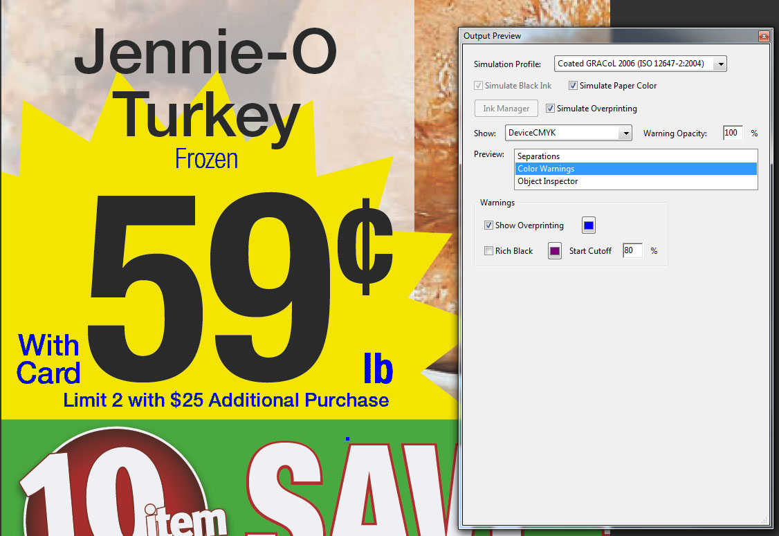

Here i can see your file in alot of diffirent programs, and your file is OK the smal text is in overprint.
Cant check it in Acrobat lower than 9, But I have imported the file in ArtPro and it also OK there.
this is in my machine, the blue colour is showing what is overprinting.
Cheers
Marcelo

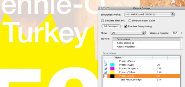

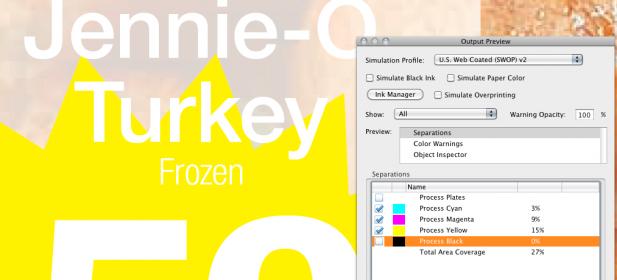

There is a checkbox simulate overprint
There is a checkbox for simulate overprint in Acrobat (next to ink manager button)
In a PDFx overprint is simulated by default.
See these two images compare the word frozen.
Screen shot 2010-12-21 at 15.24.49.jpgScreen shot 2010-12-21 at 15.24.35.jpg
