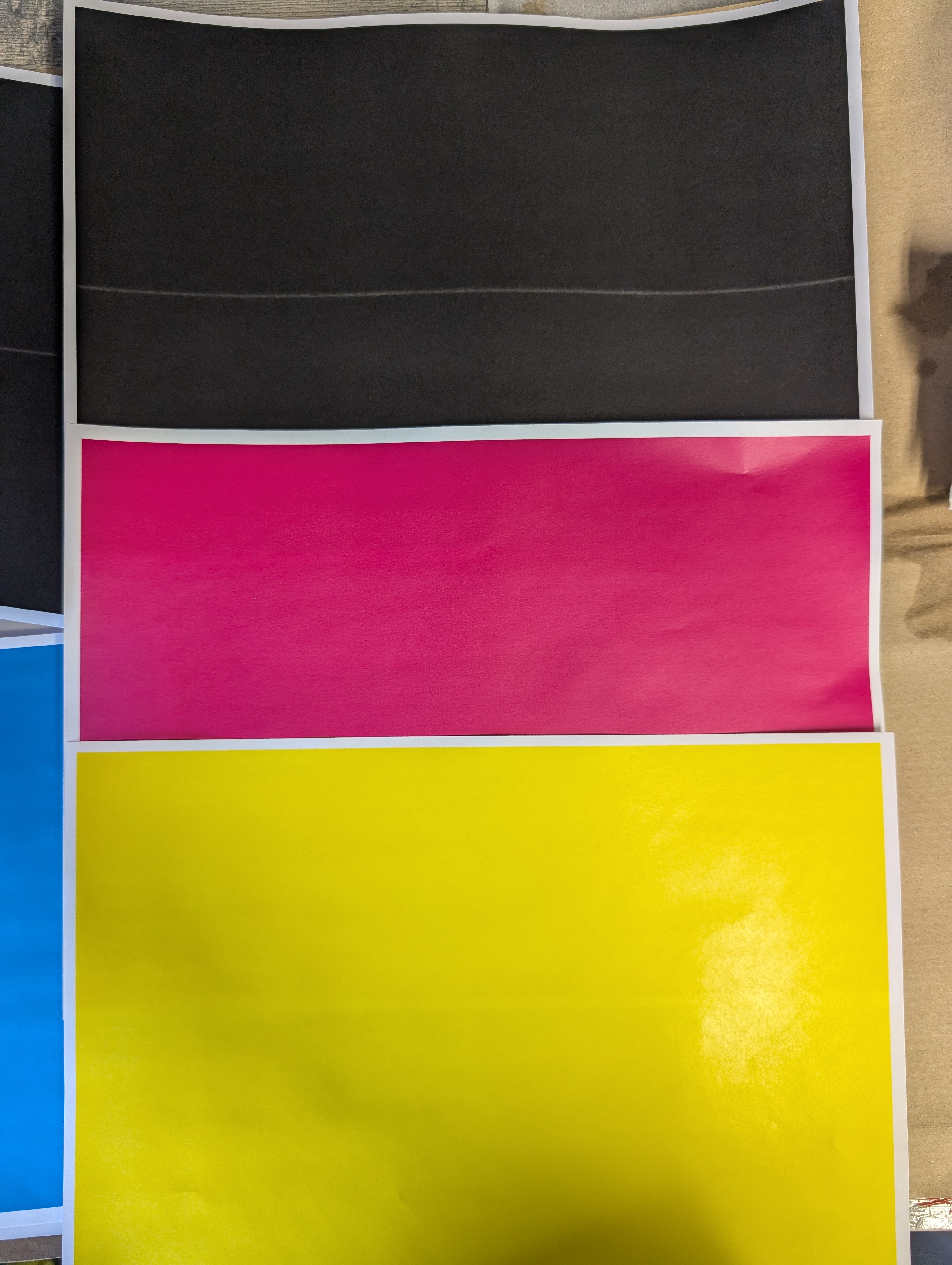

Hi, any ideas on the part or the issue with my prints? I've cleaned the drums, cleaned all the print lens, reset the waste cartridge and also cleaned the IBT.
Still persists, any help would be appreciated, this has just started and I'm mid project!

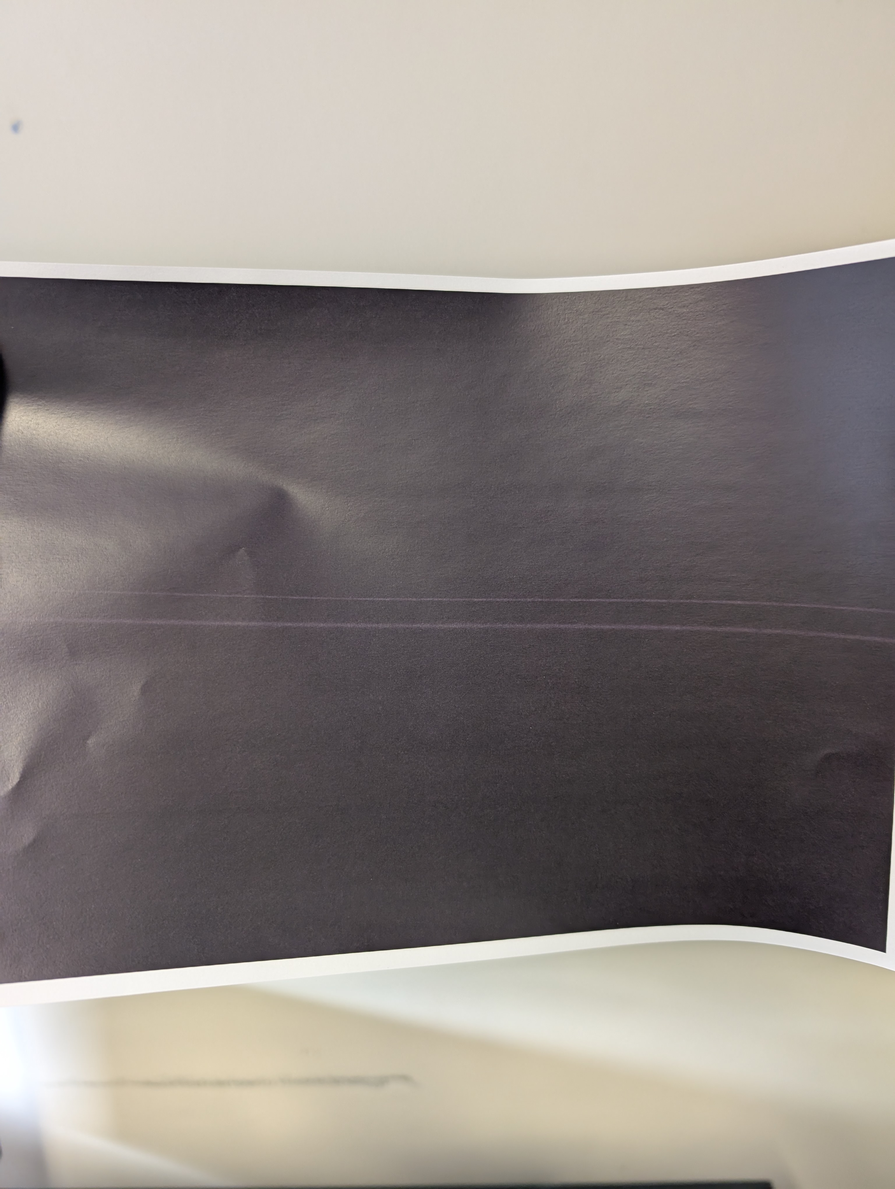

edit - just performed a test on CMYK separately and its the K channel specifically
Edit - I have the C8000w and replaced a new drum from there into the K in the DT, doesn't seem to be the drum as the issue still persists.... Im stumped!

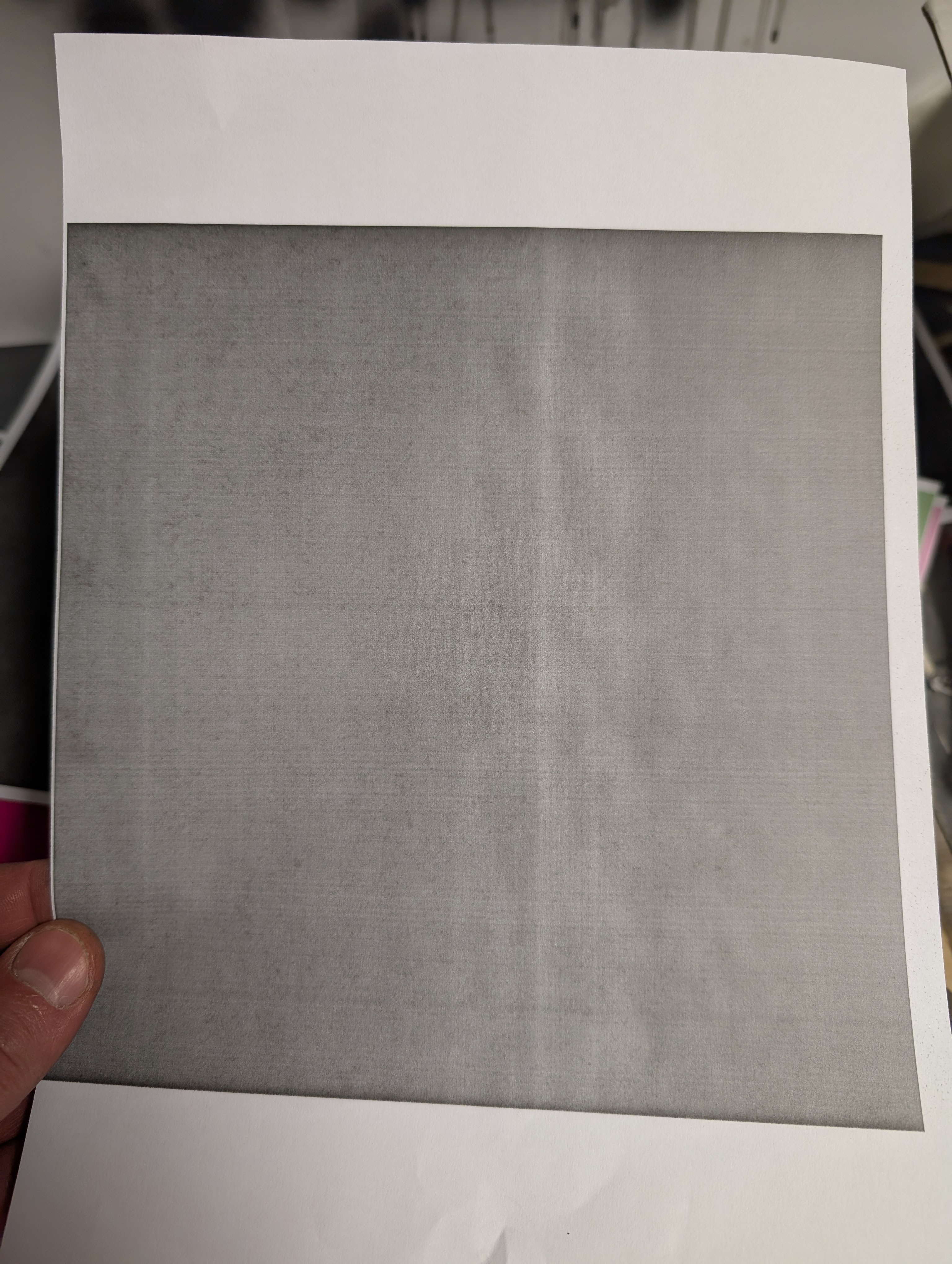

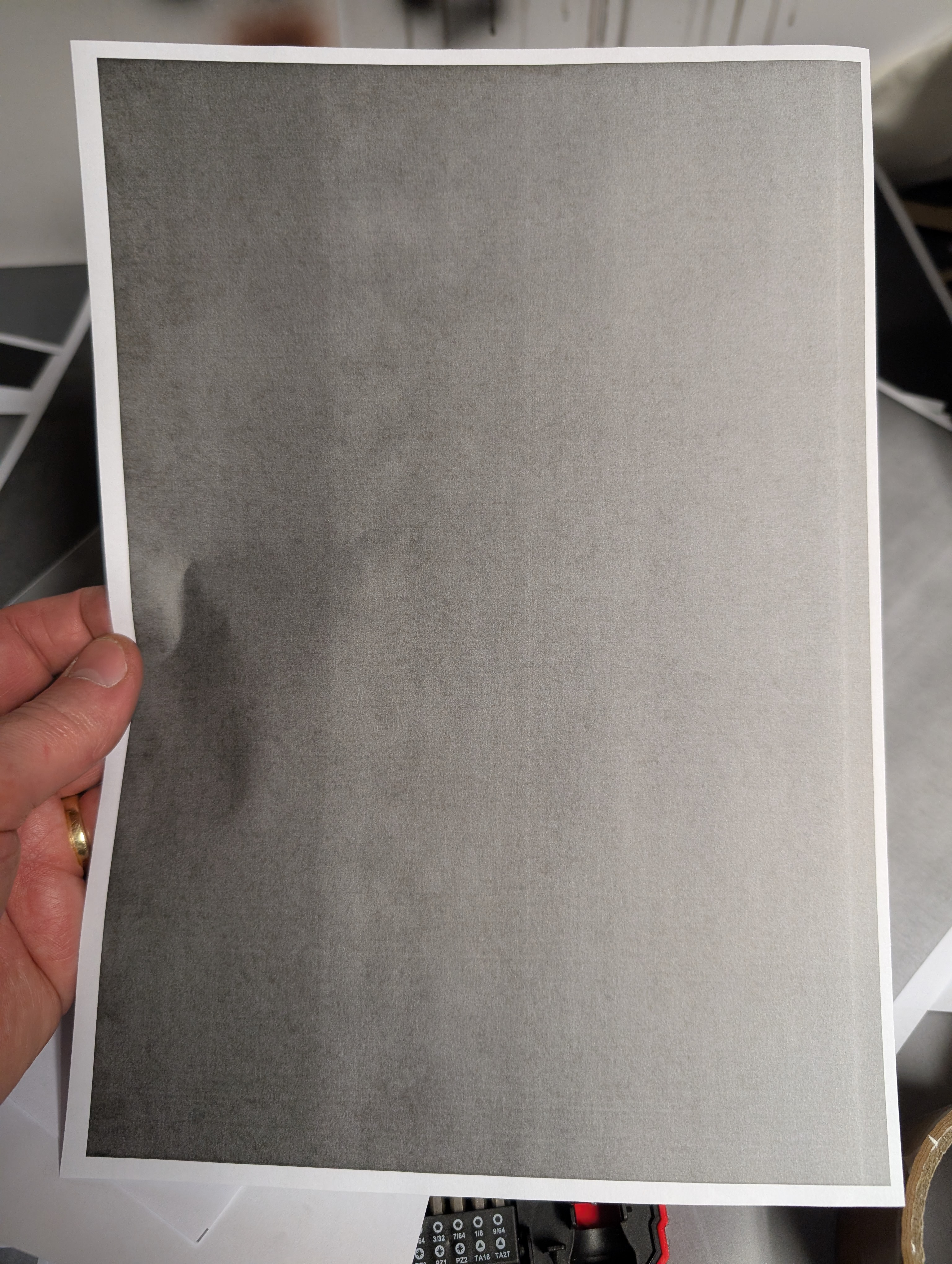

ok found it, its separate, do you know if i can swap a cyan developer for a black? I have a spare cyan but no black, even if just to test to make sure its that?
you cant do that
there is developer material in there for specific color
you probably have chunks of toner blocking the developer in the void areas
look at the housing and see if you see the voids on the roller
you cant do that
Thanks, i did find some debris, i cleared it and now i cant get a decent black! not sure if i need to buy some more developer as i don't have any, please see pics
