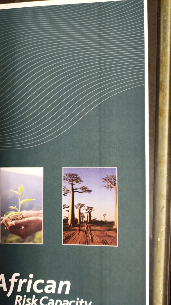

I invested in a xerox versant 3100 press
getting a line running along back edge of sheet 20mm from edge
size of sheet is 320mm x 455mm
we have been told by xerox that this is a design flaw in the press and we need to tell customers to not send jobs bigger than A3 or they must use tints without black in it.
we are being forced to outsource our jobs as well as printing them litho.
has anyone else had this problem.
thanks
Shaun
herewith a pic of the line we getting
shows up on all stock but even more pronounced on heavier grammages
BigSi
Dont get this on my much older V2100. Well I wont say I "never" have!. but most definatley not a design flaw. Kick up a stink until they get it sorted.
pippip
I've always had this on our v80. Plenty of threads on here based on this issue. Supposibly the card kicking at some point and juddering the transfer unit.
Only shows on certain jobs on heavy stock 300gsm +
Black about 20mm from tail edge, magenta and cyan can also show similar in other areas on the sheet. I've tried everything to solve this and never worked. Only solution if it's showing like that it to try and change the grey breakdown to rely more on cym and reduce black
BigSi
Maybe I should elaborate. Yes I do get something similar on my V2100 but it is much closer to the edge say 10mm (so about the 440mm point)
on Sra3 sheets (450mm x 320mm). Tech describes it as tail edge flick. Never had it on stock less than 300gsm. Slowing the machine down helps a little. Seldom a problem for me as its so close to the edge almost all ways trims out.
Shaun
been told that it is a problem with the 1st BTR and distance of the black from yellow but that they have sorted that out on the newer models
would have been nice if that had let us know that they had had this problem on previous models prior to us buying this one
Anyway seems we stuck with it know

azehnali
the issue can be minimized fully by having the latest software and not what's online and updated NVM's
Also the latest version of the BTR and Fuser assembly needs to be rebuild (specially the gear assembly) with updated Fuser belt and pre fuser belts need to be replaced
Also IBT assembly has to be updated and make sure the flywheel is installed (its standard on the 3100 but sometimes people take it out)
Its quite a bit of work but pretty standard

SoggyWinter
V3100 for three years. I occasionally report this issue for a service call and techs just swap out the belt or roller that is impacted and we're back to normal. Agreed with the others on bringing up the CED.
If this line happens on the same exact spot for every print, this can be due to a missing guide plate inside the fuser unit. Some technicians remove it when replacing the pressure roller / fuser and forget to put it back in.
