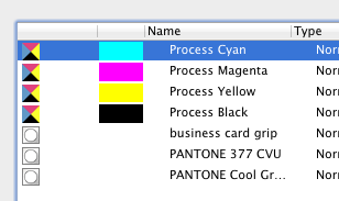

I also have issues with acrobat x. Not only does the ink manager fail to preview the spot colours but upon remapping a spot to a process colour alias it changes some of the elements line/stroke thicknesses. My workaround is to use pitstop but it is a lot slower as you have to load the document colours and change them one at a time. Acrobat 9 performed this function flawlessly. Every time there is an update I hope that this is one of the issues that gets fixed. I think this problem is part of a shift away from print across the whole of CS6 because indesign is not that robust either
Robert - I am not follow you at all on these things. Can you post some screen shots and sample PDFs that demonstrate these problems.

Hi Leonardr
I have included the following images
Original colours
Colours remapped in pitstop
Colours remapped in acrobat
Ink list with no colour for ink icons
The behaviour of acrobat x has been the same on snow leopard upgraded from 9 and a clean install on a clean install of lion
Many thanks
Rob

Thanks - but can I get the PDF that does with it? I need to see the specification of the colors in the PDF to understand the behavior and determine if it is correct or not.
