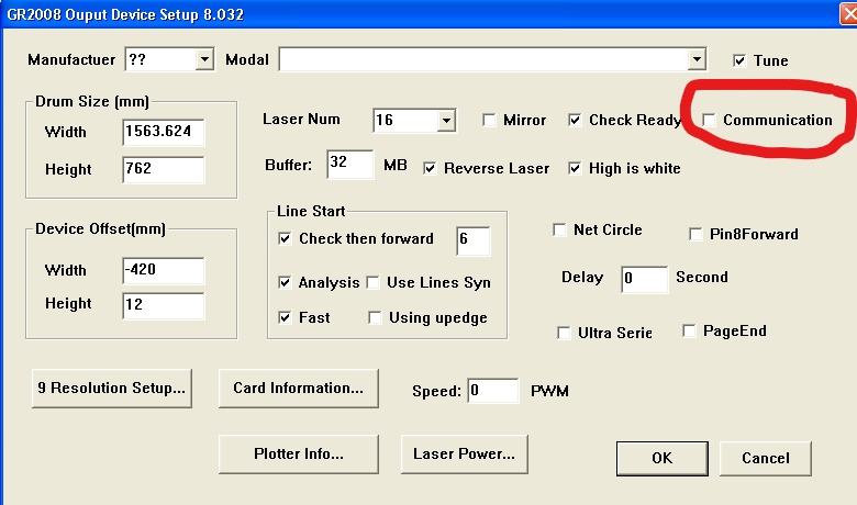

For whatever its worth, this fixed it...
1. On investigation it was found that the following was unchecked
Page Setup Manager > Default Page Setup (Edit) -> Configure Device -> Communication (check box)
2. Checked the Communication checkbox and it started printing... No errors this time.
