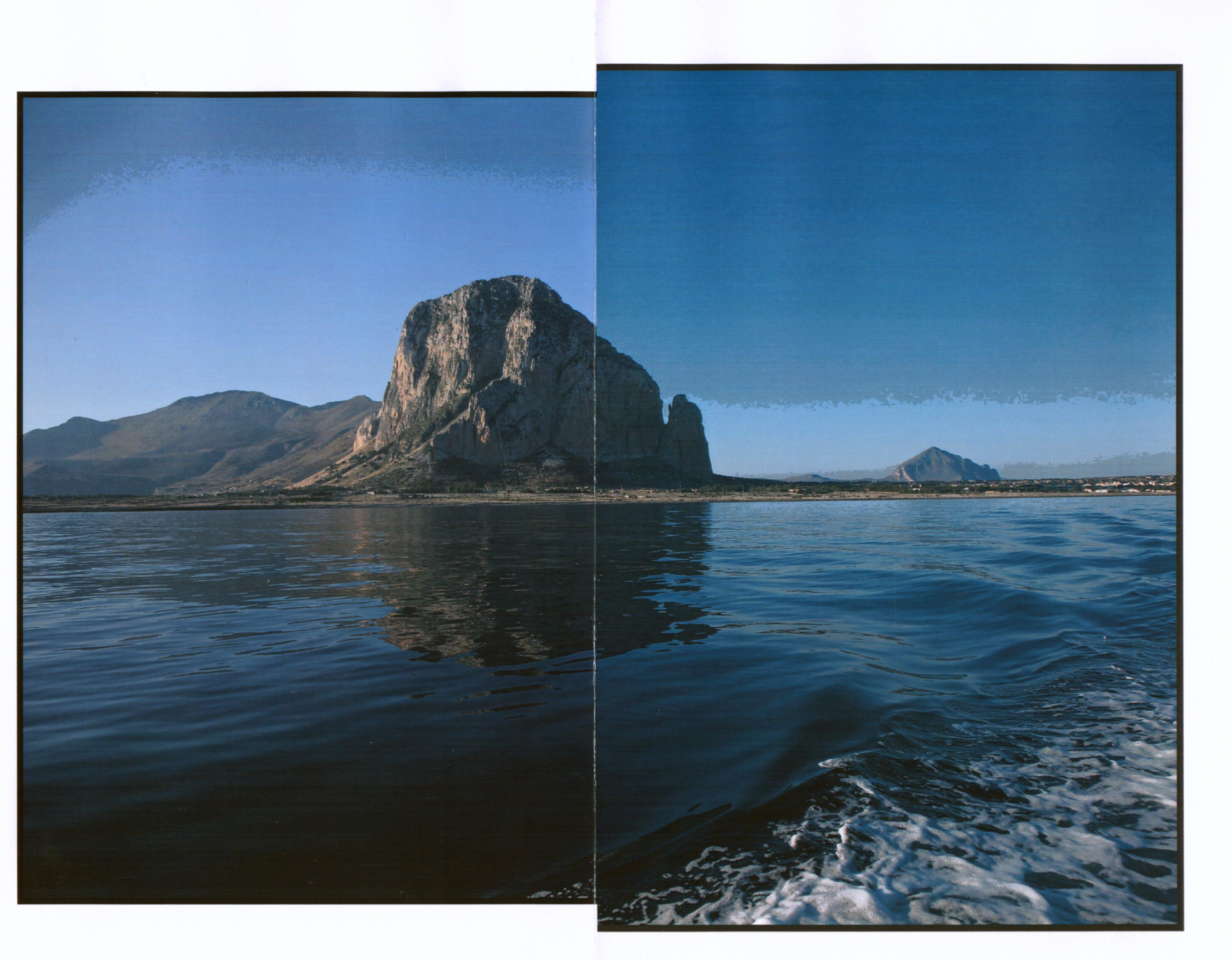

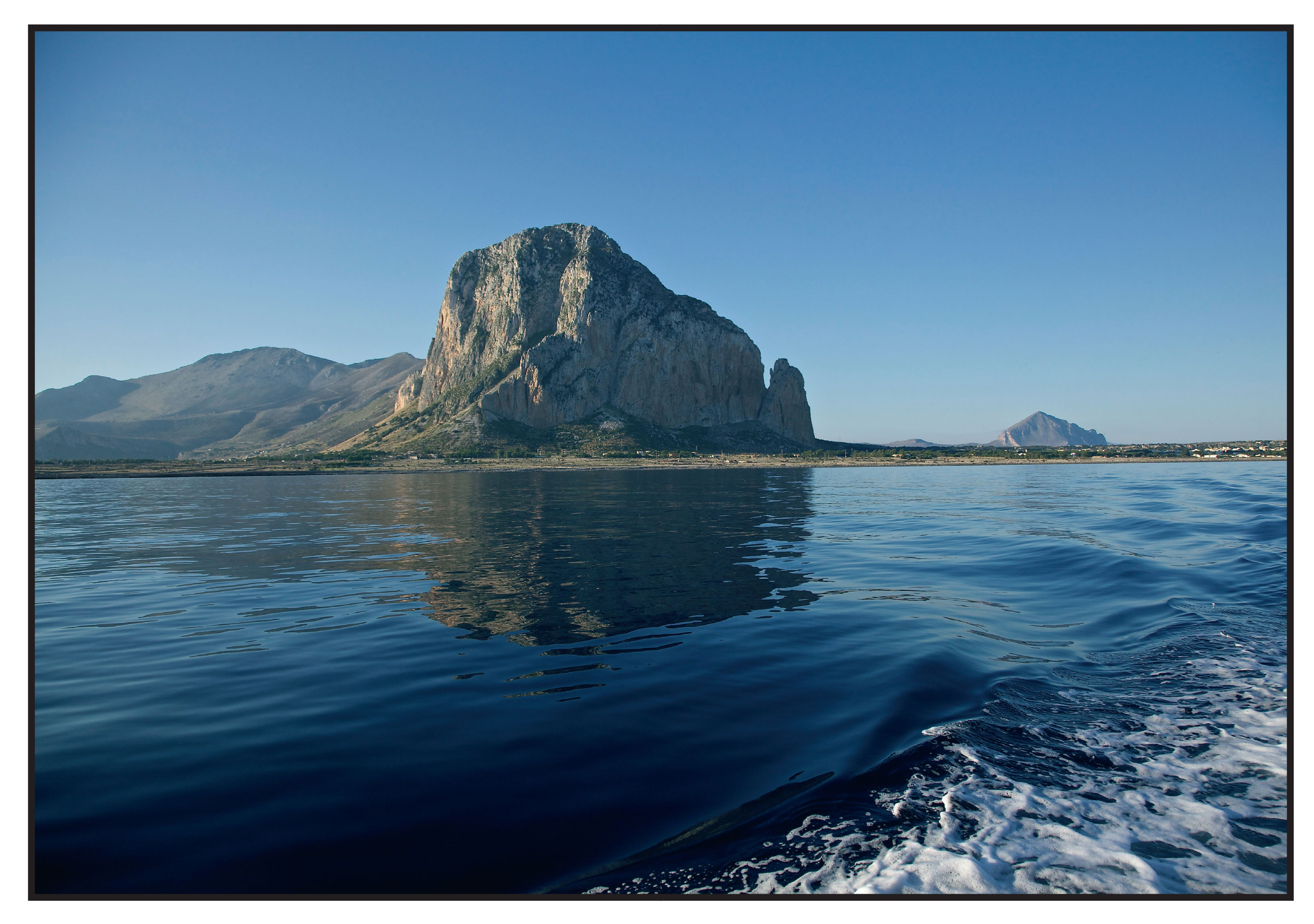

I have a problem with Konica Minolta C8000 Press.
When I print the attached file the gradient color of sky is corrupt and it seems to appear some little squares.
what it depends?

This looks like a RIP issue more then a machine issue. Did you do your calibration ?
Thanks for reply.
I did calibration with spectrometer es-1000.
Then I tried to change the CMYK profiles (FOTOGRAF39L) , but the problem remains

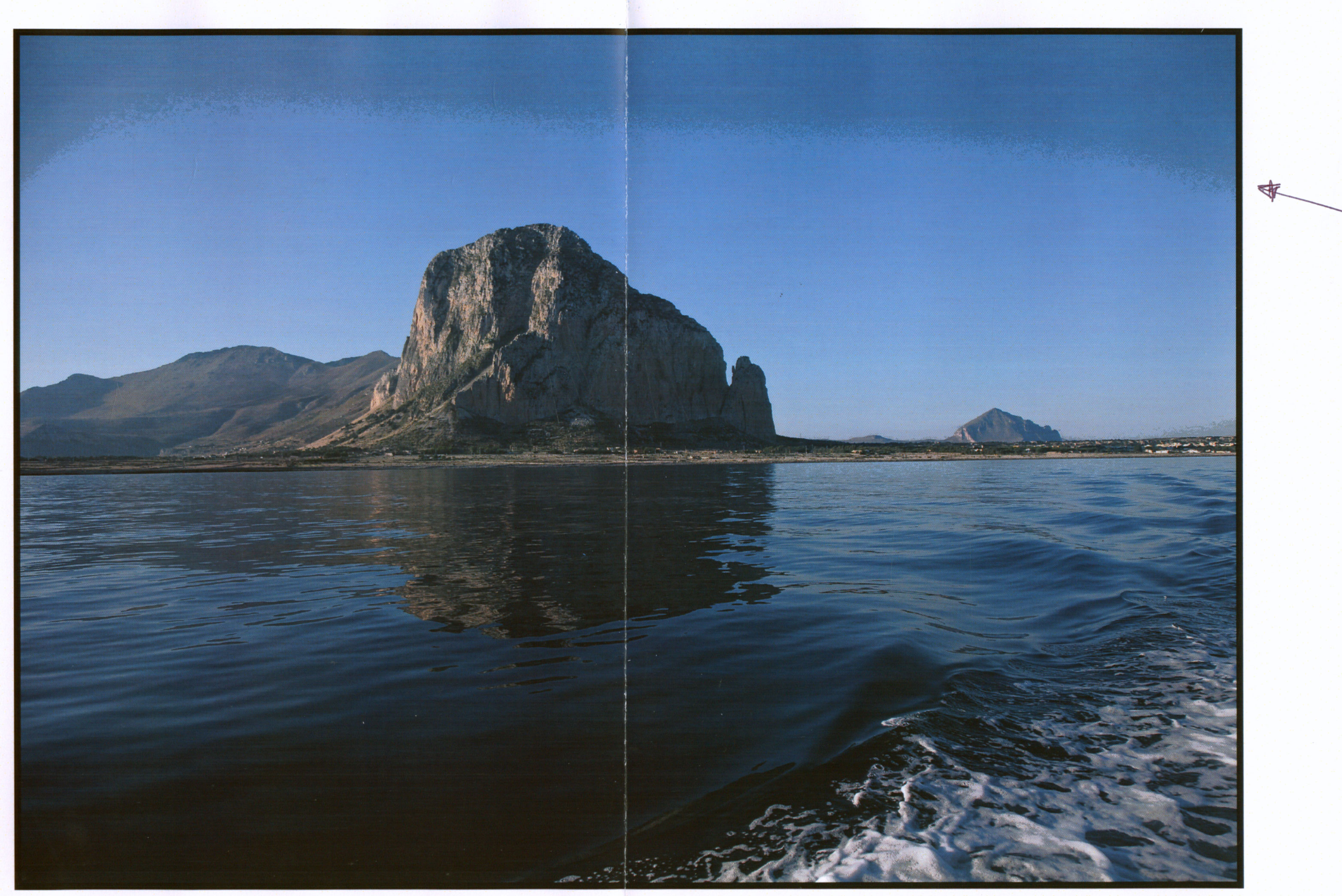

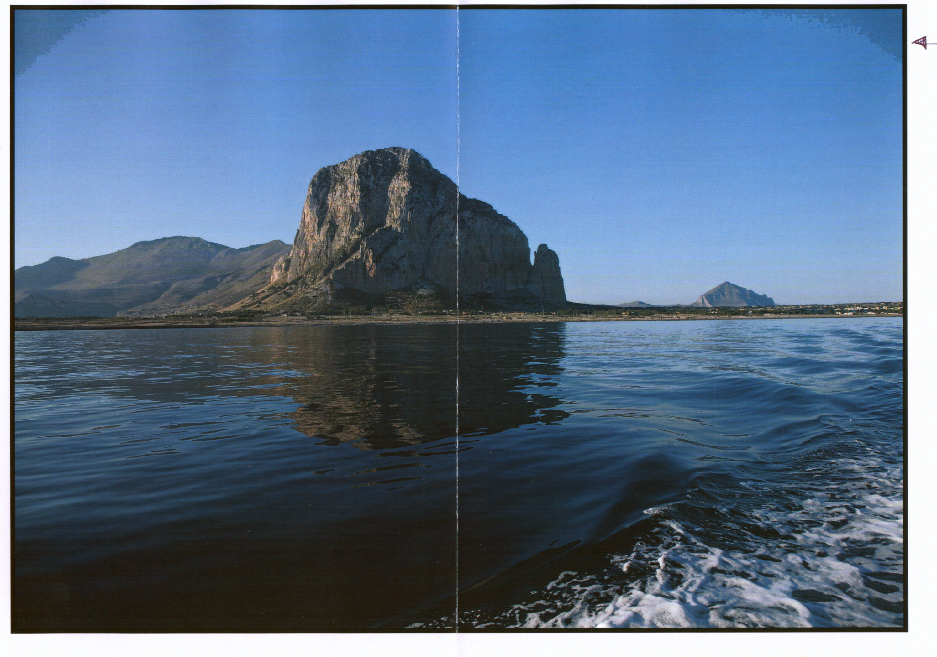

Try opening the file in photoshop and save as a flat pdf in pdfx 2001. that might just fix it
What program created the file? I get something like this with Publisher files when it downsamples images into pdfs. It does a really lousy job of downsampling on very fine "gradient" type image areas, such as backgrounds.
unfortunately I don't know what program created the file...
I tried to esport like .ps and then distill it again; to save like pdfx or pdf optimized in adobe pro, but nothing.
Now I tried to save in photoshop here the result
so I think it depends on the controller.

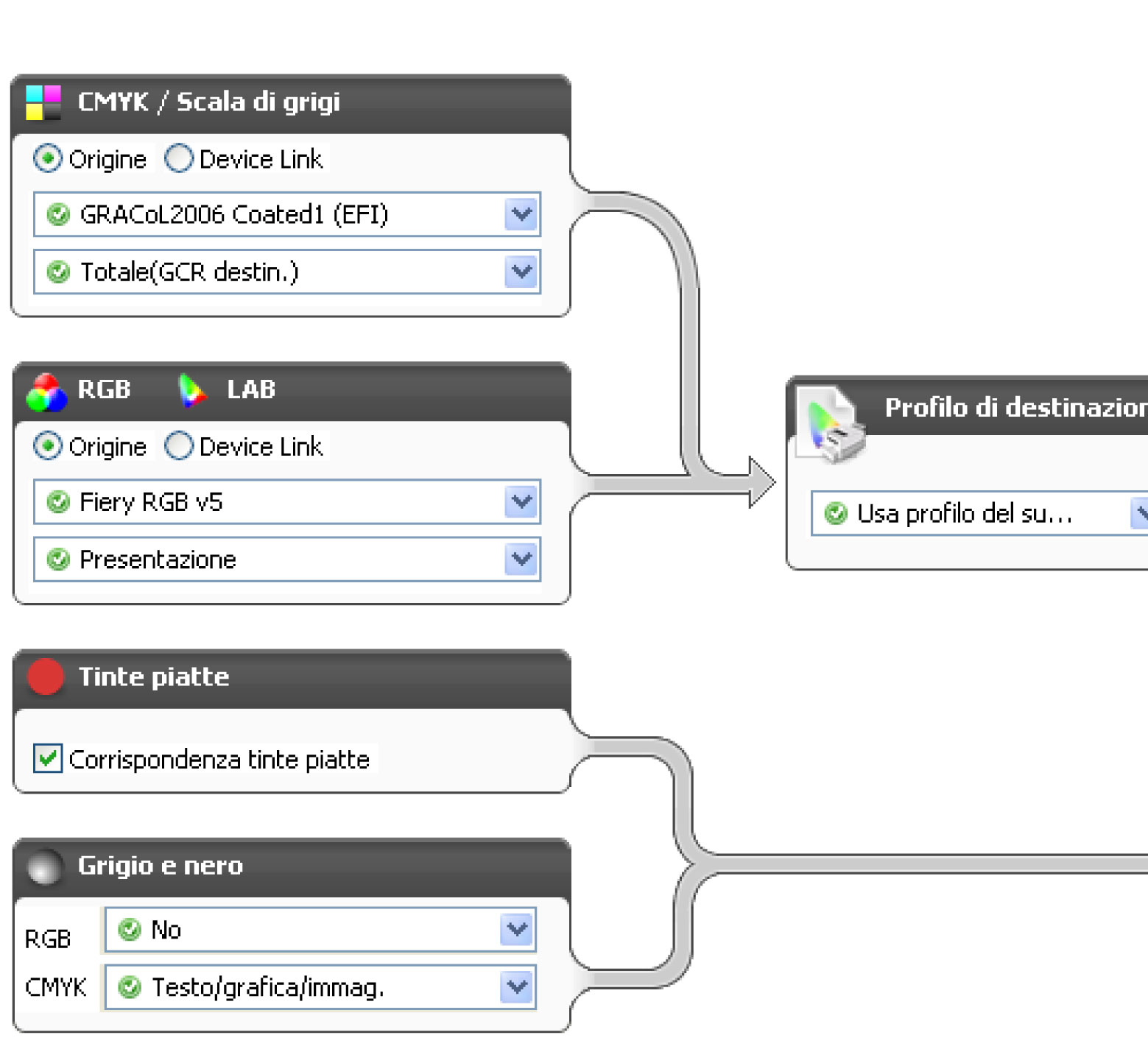

I think it's on the RIP side as well. What are your color setting for your RIP? (Post a screen capture if possible.)
I tried all CMYK profiles and also ignore conversion.
I change origin profile in device profile.
I tried Dot1, line1 and stocastic...
There aren't other settings that I know
If you open your pdf in acrobat and go to File - Properties and go to the description tab (first one) you can tel what generated the PDF.
I suspect the GCR setting, what happens if you take out/turn off any GCR (I think it stands for gray color removal). It may affect other parts of the color, which may mean other adjustments IF it fixes this issue.
Try changing only the 2nd setting in CMYK from "Totale (GCRdestin.)" to "Pure Primaries", or the equivalent.

Your color settings seem fine. I just have for RGB/LAB set to Relative Colormetric instead of perceptual and the Gray and Black setting on RGB to text and graphics.
